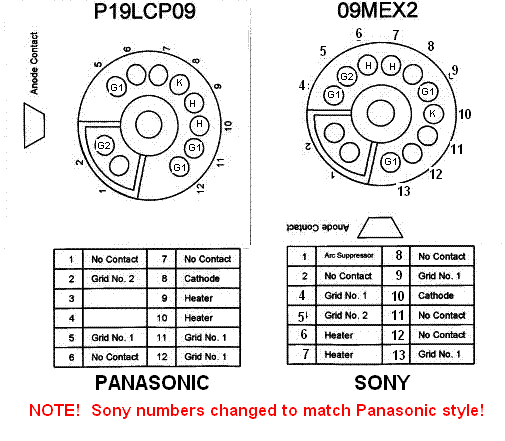

Posted: Sat Oct 04, 2008 6:07 pm    Post subject:
Panasonic and Sony had different ways of numbering the tube pins. That may be the source of confusion. The attachment shows The Sony base renumbered to match the Panasonic method and the tube socket number system.

Posted: Sat Oct 04, 2008 7:59 pm    Post subject:
Scott, we're talking about SD-146A (electrostatic tubes). These should be the same pin-out as SD-187 and 07MS 7" tubes.
