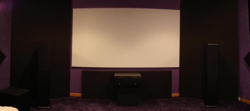

I have dark-colored walls, and large black-covered sound-absorption panels on either side of the screen. They come out at a 45deg angle so they capture some light.
If you want to get hardcore about it, you hang black velvet on the walls AND the ceiling for at least 6' or so from the screen.
EDIT: pic!

VERY nice!!!!! Excellent job. Thumbs Up
Greg
