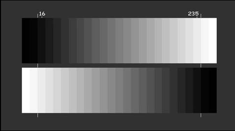

I finally got a chance to adjust the gamma on my EXT-HD, and I find that even with both the screw and the IR controls maxed, I STILL don't have as much boost as I think I need.
I displayed the "5% step" pattern from the GetGray disk. (See below -- note, this is copied from the GetGray manual, it's NOT a screenshot! The first two bars are "blacker than black." The 3rd bar is "black" or 0%, the 4th bar is 5%, etc.) This pattern shows 5% levels going from 0 to 100%. With the EXT-HD fully maxed out, I can see the 10% step but not the 5% step.
I can see a 5% window just fine, but that's with the rest of the screen black. With other bright things on the screen -- which is when you NEED the boost -- I can't get enough "oomph."
I know the box is working. I can see the boost increasing as I rotate the screw CCW, until it starts to click. I can see the boost changing as I use the IR control, and I've got it maxed. I still can't see some of the shadow detail.
Am I expecting too much? Those of you using the EXT-HD, do you have the GetGray disk or similar 5% pattern? Or does that pattern have too high APL to see the 5% level with an AC projector, even with a gamma boost?

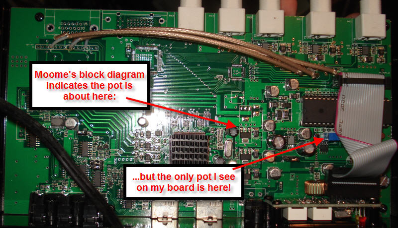

?? I don't see a clearly-circled photo anywhere, just a rough block diagram. That diagram does show the pot closer to the center of the board, but I don't see any pot there on my board. And my gamma did definitely change when I adjusted the pot under the ribbon.
This is what my board looks like. Doesn't yours look like this??
Mine is a lot differnt from yours (Edit - see photo in link several posts down) - so I guess it was me who adjusted the wrong pot (Again for anyone what it the other pot for and do I need to get it fixed?
In my case I have the vga out and dvi (test) out - so I have some ICs you don't have in the upper left of your photo below where the DVI out goes- plus a separate gamma daughterboard that attaches behind the vga port in that row of holes where you have three wires soldered in. The pot I adjusted is to the left and below the daughterboard where your board just has a row of empty holes.

Since I haven't heard anything I emailed moome for feedback. Will post here if I receive a response:
Moome - I have one of the original Ext-HD boxes with VGA and test DVI out. It has two pots on it versus others only have one with the RGBHV BNC version of the card.
Can you please let me know which pot is supposed to be adjusted to change the gamma steps for the box I have? I adjusted the one near the gamma daughterboard (actually just set it to maximum by turning it counterclockwise a number of turns). But another forum member adjusted the pot below the ribbon cable and that appeared to work for him.. Did I mess something up by adjusting that pot? Why are there two pots on my version and one on the BNC version?
see this thread for photo and further description
http://www.curtpalme.com/forum/viewtopic.php?p=137532#137532

reply back from Moome:
hi,
you should adjust the VR1 near the DIP40 CPU~
_____
Which doesn't help me much as I don't have a clue what the dip40 cpu is but if I had to guess would be the 40 pin IC near the pot Gary adjusted.
So I assume I probably adjusted the wrong one. (yes)
But maybe not (Wrong) - the manuals Moome provided for the original Ext HD box did show separate VR1s for the VGA and the BNC gamma boost, and all the boards I could see that were in his box showed 2 pots so Gary's seems different in that regard. Even if I did understand still doesn't help to know what the other VR1 does. Oh well, if its not broken don't try to fix it;
http://picasaweb.google.com/Ralpharchi/MoomeBox/photo#5240140230038768882
edit - the below earlier manual for ext-hd did show separate adjustment points for vga and bnc
http://www.curtpalme.com/forum/download.php?id=2961
EDIT- doesn't matter - VR1 it is
VR3 which is clearly labled on board is for component sync - Don;t adjust
