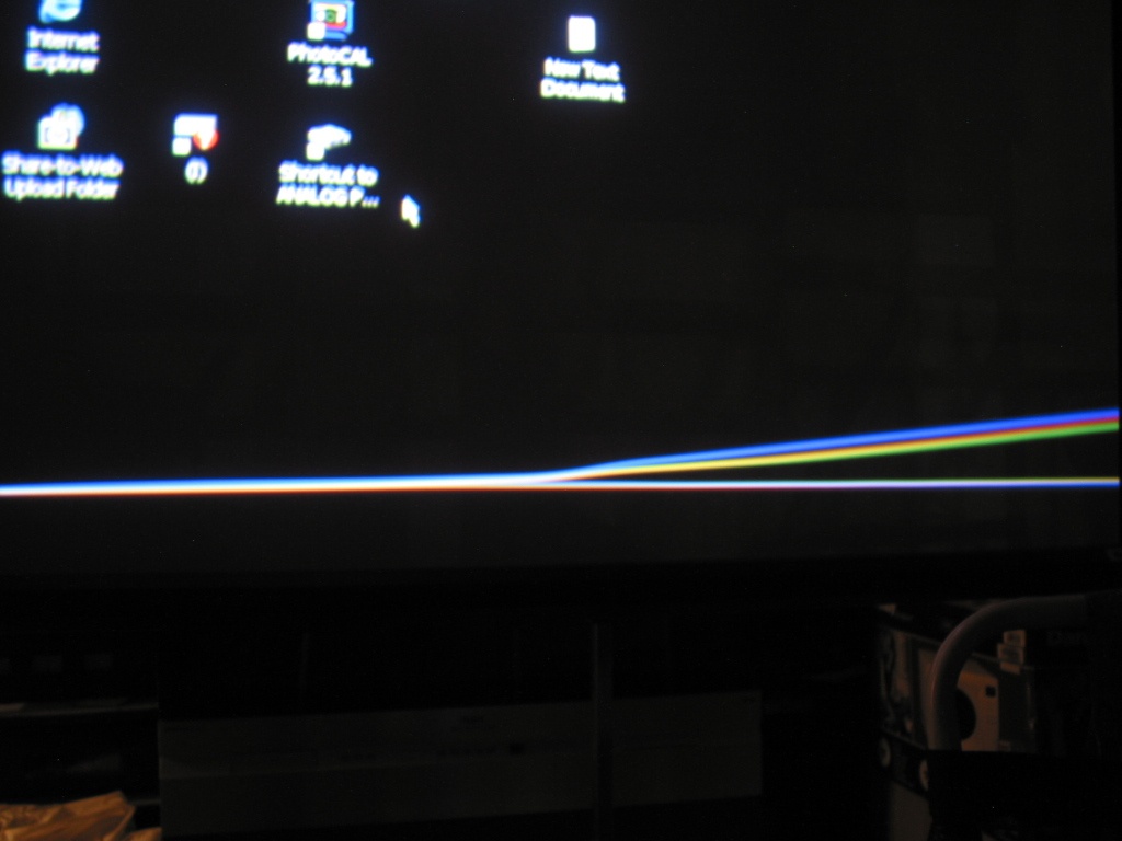

And now, with my new pc I 'm getting this strange distortion line at the bottom of the image?
The very bottom of the image is distorted into a wavy line, bit like a tilde '~' running from left to right across the bottom of the image. The r,g,b all slightly separated. Additionally on-screen displays from the pj would be slightly jumpy. All these problems disappear when I switched to internal test patterns.
http://members.iinet.net.au/~staylor64/images/StrangePattern1.jpg
http://members.iinet.net.au/~staylor64/images/StrangePattern2.jpg
(If clicking on the link doesn't work, try right-clicking and 'save link as')
Does anyone recognise this and know how I can fix it?

Have you center the raster of RGB tubes? If the raster of RGB are center within the tubes, use shift function to bring the image to the center of the raster should solve this issue. I have seen this wavy lines. I shift the image back to raster and the picture back to normal.

My Ampro looked like that when I had the blanking opened up all the way. Try adding a little bottom blanking to see if that clears up.

What Ricky said and you also might need to tilt the projector slightly to compensate for image shift.

the easy fix would be to swap the video card Very Happy I think the pj is seeing this as a close enough match to the existing block to lock to the block, however there is enough difference in the signal to warrant redoing the convergence etc..why don't you copy the existing block and modify it to better match the new source.

Move the image up, and raster down.
Your image is off your raster, that's all.

Raster Centering.
CTRL+POSITION.
If the common raster centering is not enough, enter Service Mode and then you get individual Raster Centering.

Posted: Mon Jun 23, 2008 2:51 am    Post subject:
Yep, it was the porches. Looking fine now.
Powerstrip had them at 1 and 3 for the vertical I think. I did play with them before but only up to say 9 and 30. When I went over my old settings, it turns out I was using closer to 40 and 104. So really this is a powerstrip issue - those desktop shortcuts define the porches, and had them quite large, but when I go to 'advanced configuration' the porches are at 1 and 3?
It's under control now.
