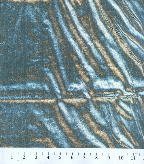

I will take a look at this Silver Lame the next time I am near a Joanns. What is the price?
Posted: Thu Jun 19, 2008 6:11 am    Post subject:
Sounds like a good material for an outdoor screen.....
Posted: Thu Jun 19, 2008 7:12 am    Post subject:
This it?
http://www.joann.com/joann/catalog.jsp?CATID=cat323844&PRODID=prd33350
Wow, it's REALLY shiny. I'd be really curious to see how it looks. Might have to grab a small piece sometime to test for outdoor screen...

that's a great idea Ecrabb, an outdoor screen! That's the fabric, what was that? $6.99 per yard. A steamer or iron on steam mode to remove wrinkles, DON'T PUT IRON ON FABRIC, HOVER IRON DIRECTLY OVER FABRIC WHILE ON STEAM, 1/4" TO 1/2"directly above. this was conceived as solid metal screen of aluminum or stainless steel was too expensive to produce in metal sheet so not practical.

Actually, it's only $3.99/yd! You could a 45x106 scope screen for $16 plus some PVC, rope, and stakes!
Posted: Fri Jun 20, 2008 2:26 am    Post subject:
Trust me, it WILL hotspot like MAD. I bet you'll see 3 different hotspots, R G & B. It's about as shiny as the dull side of aluminum foil -- maybe shinier if you get it smoothed out! That stuff is only usable as a screen if you do something to tame the hotspot -- curve it into a torus, cover it with something (tulle, paint, whatever), or something like that.

I've projected onto the dull side of aluminium foil. It hot spots like crazy, untill you curve it. Taurus would be great. (No bull Wink )

can someone test fabric with a high output CRT PJ. The digital PJ I used to test had no hot spot image error from projector at 1,000 lumens, only a bright uniform projected image showed. As shiny as this fabric is, it does disperse and diffuse light somewhat. Can someone with CRT screen shot post some pics??
