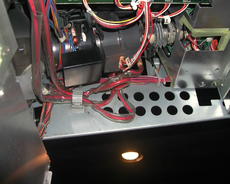

Curt, please be patient with me. Is the connector you are recommending swapping the one shown in the attached pic. It has the label AB on the wires?

Posted: Tue Jun 17, 2008 1:01 am    Post subject:
Nope, you want to swap these:
http://www.curtpalme.com/NECXG_Layout3.shtm
(see the previous page on how to access them by lifting the PC board tray).
http://www.curtpalme.com/NECXG_Layout5.shtm
The above is the pix of the socket itself.

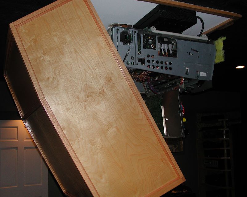

The phots Curt referenced show access to the cards from the back of the projector.
To do so, I will have to remove my hush box. That is going to require some effort and another person. I know someone built a hush box out of foam. This one is plywood and hardwood and heavy.
Before I go through the effort, I just want to make sure that I acces the boards from the back and that I can do this without having to take the projector down.

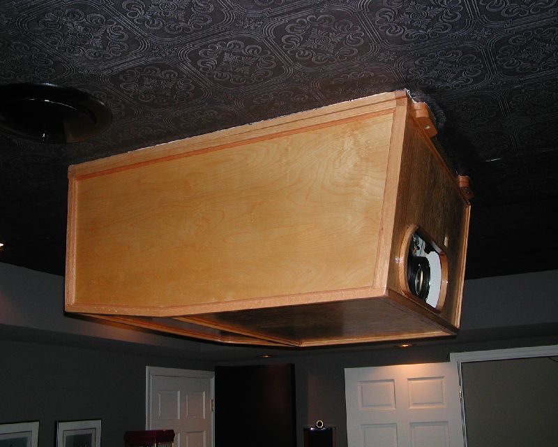

Not that you don't already have enough to do but I'm curious about your hushbox. What are the approximate dimensions and how are you pulling air out of it? Have any more pictures? I need to build one for my XG soon.

I would be glad to give you more info on the hush box. It was one of the best additions to the theater to date. And with an XG, I would say it is a necessity because they are so loud.

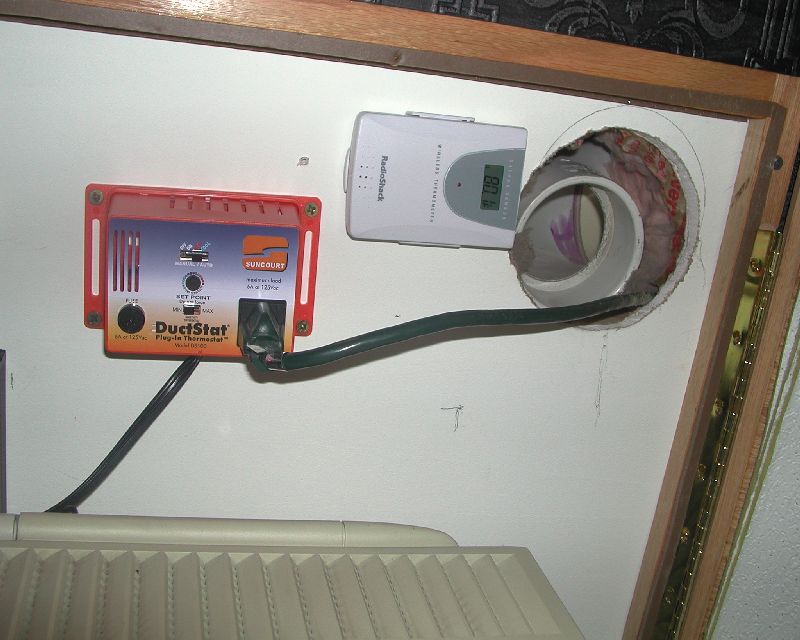

The inside dimensions are 35.5 by 41. The depth is about 18 inches at the deepest. The depth is the limiting factor because I believe you need some air flow around the projector. The air is sucked in through the hole for the lenses. I also had a hole for the IR sensor. I have a RF remote now and don't need the hole anymore.
I exhaust air via a hole in the ceiling that has a PVC pipe leading to an adjoing utility room in the basement. I have two fans, I forget the CFM they pull, at the end of the 10 foot PVC.
The fans are triggered by a device I got from Smarthome that detects the increased hot air flow when the projector comes on. It has worked well. It is fairly straight forward. It was a bit more difficult because I added it after the room was finished. But it can be done even if you have a sheetrock ceiling.
It is hinged by a long piano hinge.
If you want more detail or better pictures, (I realize these are not the best photos), let me know and I will do what I can.
Most hush boxes I have seen are black, and is the best choice, but this was a woodworking project for me so I went with oak and a natural clear finish.

Very nice Mark! Thanks for the pics and explanation. Do you leave your XG case on inside the hushbox or do you take everything off of it before closing it in? Also, what did you line the inside of the box with for sound absorption? Was there a big difference in fan noise after adding the box? For me it's not just the noise but the heat that it pumps into the room...
I just found your DuctStat device. Thanks for the tip on that! Great idea!
I have read that you can do it either way. I left the top cover off and the sides on for airflow through the existing vents. I don't know if it really makes much of a difference.
The box is lined with ceiling tiles. I used two types in two layers. The outer layer was the really dense ceiling tile and the second layer was the lighter fiberglass type. The noise reduction is substantial.
The seats in the theater are directly below the projector. I don't remember exactly what the Rat Shack meter read before the hushbox, but after, the dBs dropped below what the meter can measure. I think it was in the 60s to start with. Sorry I don't have specific numbers. I did post some info on AVS a while back. I also did some temperature measurements inside the projector because I was worried that I was not drawing enough air. Ended up adding a second fan just to be safe.
Some folks have tried using optical glass to completely enclose the box, but that may be more trouble than it is worth in my humble opinion. Issues with reflections and such. With this box, if you are under or behind the projector, it is barely audible. If you get in front of it you can hear the fans through the front hole.
The concern about drawing heat out of the room. Again, no specific numbers, but without a doubt, the room is cooler because it does draw the heat to the other room.
Total cost for everything was around $350 including fans, sensors and materials. I used oak plywood and 3/4 in solid oak.
I cannot take credit for the idea. Someone on AVS recommended it.
