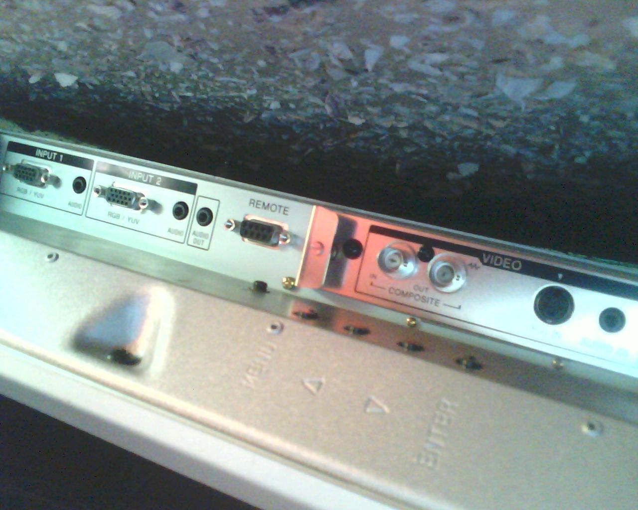

Posted: Fri Jun 06, 2008 6:06 pm    Post subject: It has no component
It doesn't have component, only composite. Here is a picture to clarify everything. (P.s. excude the quality I took it with my laptop camera But it works so yea...) It is attached.

CRT_Ben
Joined: 28 Aug 2006
Posts: 1684
Location: Northern Virginia
Posted: Fri Jun 06, 2008 6:18 pm    Post subject: Re: It has no component
It does have component, it just takes it through the VGA plug instead of having the 3x RCA configuration you're probably used to. That means you need a 3xRCA->VGA cable, like so:

Person99
Posts: 4899
Location: Flower Mound, TX
Posted: Fri Jun 06, 2008 6:19 pm    Post subject: Re: It has no component
Those two VGA connectors will take RGBHV or component. There should be some menu setting in your display to put Input 1 and Input 2 into "RGB" or "YUV" mode.
You will need a cable like this:
http://www.ramelectronics.net/audio-video/video-cables/hdtv-projector-cables/vga-to-rgb-component/component-video-to-vga-cables-55-873-rca/prod55873RCA.html
The other option is to buy an HDFury and plug it into the input and configure it for RGB.

ROFLmaker
Joined: 05 Jun 2008
Posts: 40
Posted: Fri Jun 06, 2008 7:45 pm    Post subject:
I need to run it 5-6ft tops. Which of these will give me the Highest quality picture?
CRT_Ben
Joined: 28 Aug 2006
Posts: 1684
Posted: Fri Jun 06, 2008 8:00 pm    Post subject:
If that's the case, just go with this cable:
http://www.monoprice.com/products/product.asp?c_id=102&cp_id=10235&cs_id=1023503&p_id=2170&seq=1&format=2
Unbelievably cheap, and it'll do the job.
