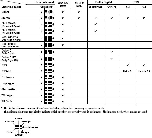

I have an Onkyo HTR-510 6.1 AVR. (Manual can be found here.) It doesn't handle HDMI in so I feed it with S/PDIF via coax from my Momitsu v880N SD DVD player. I'm testing it with DVE to make sure I've got everything set up right. And I don't. I *swear* that at one time I did, but something along the way must have messed it up.
I am completely befuddled by all the options for sound input....
I know there are several source formats: Dolby Digital, Dolby Digital EX, dts, dts Surround, dts ES, maybe more. I believe any particular movie may use any of these formats. I also believe the Onkyo treats all PCM signals as dts, translating Dolby into dts, but I'm not sure about that.
My receiver has many "listening modes": direct (2ch stereo), STereo (2.1), Pro Logic II movie/music, Neo cinema/music, Dolby D, Dolby D EX, DTS, DTS-ES, and more. Dolbe D/EX, dts/ES aren't available for PCM inputs, which I think is what I get with the S/PDIF coax. See p.34 of the Onkyo manual for a table (which I've included below) of what modes work with what inputs.
I think you have to use the appropriate listening mode for a particular input signal in order to get the sound decoded right. I think. (Do you really have to switch modes for different DVDs, or can you select one and stick with it?)
My receiver also has several subwoofer modes, specifying whether it should extract the bass from the general audio tracks, or play only the LFE track. I have mine set to LFE only.
So I cued up DVE title 9 (Audio Test Signals, Dolby and DTS 6.1) to make sure my speakers were getting the right sounds. DVE has both Dolby and dts signals so it seems like you should be able to make either one work.
But the results I get are a mishmash. Instead of being localized to specific speakers, as it shows on the screen, it generally comes from many sources. See attached table for examples. (Left column is the DVE chapter & speaker, cells show which speakers turn on during that chapter. I tested PLII and neo6 because Dolbe D/EX and dts/ES aren't available for PCM input.) Strange things:
* The sub is going with L, C, and R, even though it should play only LFE.
* The sub plays NOTHING from the LFE track -- no matter what mode the sub is in!!
* The side and rear surrounds play together.
As you can imagine, this mess doesn't help my sound localization.
What am I doing wrong?? I *should* be using PCM inputs, right? That's what you get with S/PDIF? How should I set this up?

You're having trouble because the Momitsu's audio output is PCM. It should be set to "Encoded Digital", NOT PCM. On some players, the correct option is called "bitstream". That sends the encoded digital stream from the DVD (either AC3 or DTS) directly to the AVR for decoding - which is exactly what you want.
Also, make sure your speaker setup is correct in the AVR.

garyfritz wrote:
I have an Onkyo HTR-510 6.1 AVR. It doesn't handle HDMI in so I feed it with S/PDIF via coax from my Momitsu v880N SD DVD player. I'm testing it with DVE to make sure I've got everything set up right. And I don't. I *swear* that at one time I did, but something along the way must have messed it up.
One little change, and it can completely screw stuff up.
Don't feel bad - it's really pretty complicated. It took me a long time of reading and researching to get a handle on it all.
A typical DVD can be PCM, AC-3 (Dolby Digital), DTS - or a combination of several. There are variations on DD and DTS, but those are the basics. The Onkyo shouldn't "treat" the PCM as anything, but that is where the "listening modes" come into play. PCM is typically stereo (not multi-channel), so "listening modes" like ProLogic II or Neo can process the stereo input to create a signal to put in the surround channels - where there was none before.
Think of "listening modes" as a way to make stereo formats sound like surround, or to make surround formats sound different - or better - or worse, depending on the mode.
No, generally, once you set it up and like how a certain mode sounds, you won't have to mess with it. Your receiver should remember how you last listened to a certain source - whether it's PCM, Dolby Digital or DTS - and go back in the correct mode the next time it sees that format.
This is usually referred to as "bass management" or "bass redirection". On some receivers, you have a setting for your main and surround speakers and can define them as "small" or "large". If set to small, a high-pass filter is applied and all bass below a specific frequency (usually 80hz) is "redirected" to the sub, along with the LFE. If set to "large", the full spectrum (regardless of content) is played on each speaker. Your Onkyo doesn't use the "small/large" setting, and instead you select a "subwoofer mode".
There are 3 modes in addition to "off". Mode 1 would be used if you had all small satellite speakers. All content below the crossover point you select goes to the sub in addition to the LFE. Mode 2 would be used if you had two tower speakers for your mains, and the rest were satellites. L and R are full-range, while C and the surrounds are high-passed. Mode 3 would be used if you had larger full-range speakers all around and didn't want to redirect any bass to the sub (except for LFE). If you have smaller bookshelf or satellite speakers, you should be using Mode 1.
I'll add notes in bold to your comments here:
garyfritz wrote:
But the results I get are a mishmash. Instead of being localized to specific speakers, as it shows on the screen, it generally comes from many sources. See attached table for examples. (Left column is the DVE chapter & speaker, cells show which speakers turn on during that chapter. I tested PLII and neo6 because Dolbe D/EX and dts/ES aren't available for PCM input.) As I mentioned in my other post, you should be decoding DD or DTS in the receiver. This is the source of all your trouble.
Strange things:
* The sub is going with L, C, and R, even though it should play only LFE. Yep. Because you're sending PCM.
* The sub plays NOTHING from the LFE track -- no matter what mode the sub is in!! With PCM, there is no LFE track
* The side and rear surrounds play together.Again, no discrete channels - just a matrixed rear.
As you can imagine, this mess doesn't help my sound localization.Absolutely. This is a really bad way to be listening to your audio!!!
Nope. You want "encoded" or "bitstream".
Don't feel bad. For years, all new Sony DVD players came setup right out of the box to default to PCM output!!! There had to be hundreds of thousands of people all over the world listening to their DVD audio with stereo matrix audio instead of discrete DD or DTS - which was one of the great things about DVD!!! (To the rest of you reading, let's not have the LaserDisc audio discussion, mmm kay?)

Okaayyy, it's starting to make sense now.
My Momitsu has only 2 audio output settings: Stereo and AC3 5.1. It was set to Stereo!! (Which may cause it to send PCM over the S/PDIF, I can't tell from the manual.) That is undoubtedly the cause of my problems. A quick test indicates that it's working the way it should now. Thumbs Up
There is no setting for dts but presumably the "AC3 5.1" setting produces dts as well. I don't think my Onkyo speaks AC3. With the "AC3 5.1" setting, the PCM light on the AVR no longer lights, and it goes automatically into Dolby D EX mode. It offers no other choice, which is probably the right answer.
I'm pretty sure that's all correct, but I'll be double-checking it. I want to re-set my levels anyway.
Aha! That wasn't at all clear from the manual. I thought mode 3 was the **ONLY** mode that sent LFE to the sub, since the manual says: "Subwoofer Mode 1: The subwoofer outputs the low frequencies of all channels. Subwoofer Mode 2: The subwoofer outputs the low frequencies of the center and surround channels only. Subwoofer Mode 3: The subwoofer outputs the LFE (Low Frequency Effects) channel of 6.1 source material."
If you're sure modes 1 & 2 combine low-end signals and LFE and send them to the sub, I should definitely be running with mode 1. My "mains" are small satellites with 4" cones, rated down to 55-60Hz. I don't have the "small" or "large" setting, but I can set the sub crossover frequency to 60Hz, 80Hz, 100Hz, 120Hz, or 150Hz. I should probably set it at 60 or maybe 80Hz.

Weird the Momitsu manual I found for the V880 (not the N) didn't say anything about AC-3. It only said "encoded digital" or "PCM/analog". I would guess the Momitsu is outputting as "bitstream" when you select AC-3, then.
FYI, AC-3 is the technical term for Dolby Digital, so for all practical terms AC-3 = Dolby Digital.
Yep. You're good to go, now. Throw in a DVD with a DTS track on it (or select it in the "audio options" menu of the DVD), and you'll see the DTS logo light up on the AVR instead of the DD logo.
Yes, if you've selected "Yes" to the subwoofer in speaker setup, then the AVR will be sending LFE to the sub whenever it's present. However, unless you select Mode 1 or 2, there would be times (especially with stereo or 2.0) material where you'd never hear anything out of the sub. In Mode 3, you'd never hear a peep out of the sub, unless there was an LFE track. So, never with a CD, for instance.
I'd go with 80hz, unless you have pretty good-sized bookshelf speakers that are nice and flat down to 60hz. Most smaller satellites aren't flat down that low. THX standard is 80hz.
