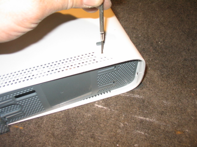

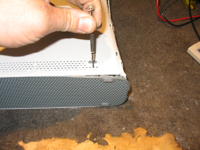

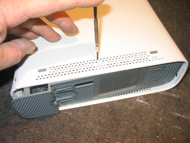

The next step is to take the side panels off. Remove any accessories from your Xbox, including the hard drive. Take a very small jeweler’s screwdriver, and while gently pulling on the front of the gray side panel, insert the screwdriver into the vent holes as shown to release the three tabs each on the top and bottom of the case. The side panels will slowly lift off the Xbox.

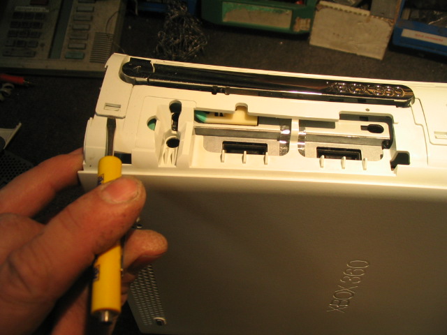

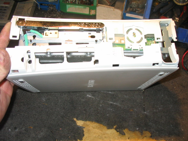

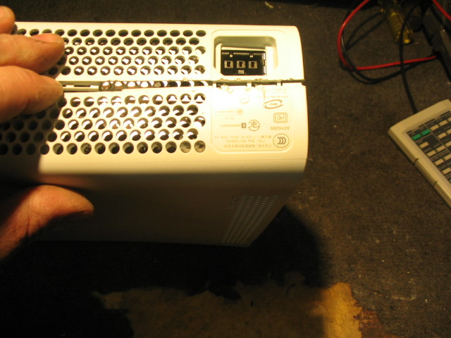

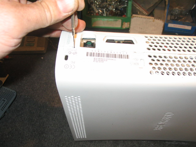

Once the side panels have come off, the next step is to separate the top and bottom clamshell case parts. There are a total of 7 small slots along the back of the Xbox that will unlock tabs holding the top and bottom covers together. Press each tab in sequence while putting pressure between the top and bottom case halves, and the covers will separate along the back of the Xbox:
(note the size of the screwdriver, it’s very small. Too large of a flat blade will not go deep enough into the Xbox to release the tabs. You’ll hear a small ‘click’ as the tabs release.)

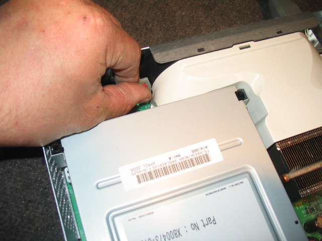

There are three additional tabs along the front of the Xbox that release with a screwdriver pushed under the tab:
Once all three tabs are pushed, the bottom of the case will come off the Xbox.

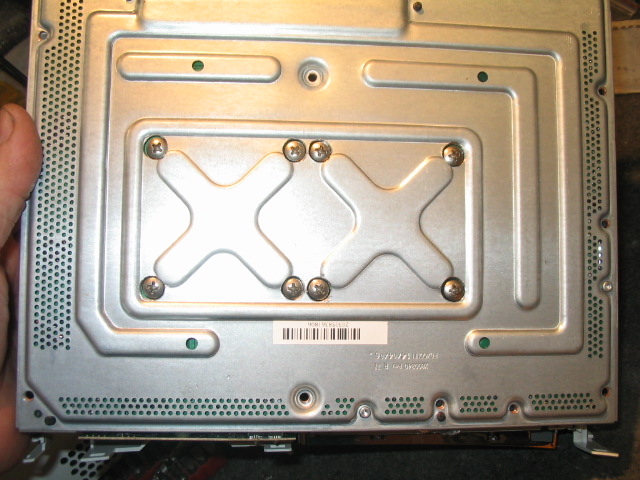

Now, on all of the later Xboxes that we’ve repaired, we’ve installed Philips screws that you can access without taking the set further apart. With the power off and unplugged, try slightly tightening and loosening the Philips screws so that the problem goes away.

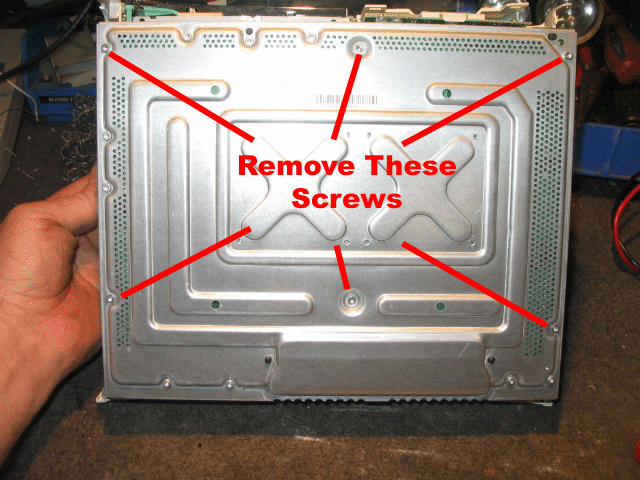

Remove the top case cover of the Xbox by removing 6 Torx screws from the bottom cover as shown:
The top cover will then lift off.

With the fans unplugged, power up the Xbox. Let it sit, but watch the front LEDs. Within 2-4 minutes of powering up, the Xbox will shut down, and the two left LEDs will flash red. This indicates an overheating condition. Immediately unplug the Xbox and tighten the 8 Philips screws slightly as shown above. Plug the fans back in, and power up.
What you’ve done is overheated the two main processing chips on the Xbox to reflow the solder connections between the chips and the main PC board. This should now bring your Xbox to life again. If not, then some playing around with the Philips screw tensions should get it to work.
