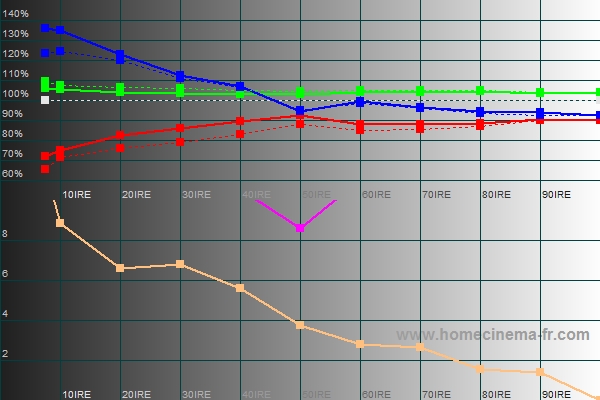

I did compare the Sencore with the Spyder using a Dell notebook PC as a source and both tracked very close. Which leads me to believe that if we can get the Spyder to work when facing the projector then the results might be more reliable. The attached graph is the Spyder as compared to the Sencore after applying the Calibration Matrix (I believe the matrix is applied at 100 IRE and extrapolated backwards). Again this was on a laptop so results will be different on a projector.

HCFR software has a feature under Advanced that will calculate it for you from your reference (or screen) measurements. Just load two calibration files and select one as your reference (the set of measures taken while pointed at the screen). Then go to the other measurement file and under the menu Advanced select XYZ Coordinates Adjustment Matrix and let HCFR calculate it from the reference. You can delete it later if you want.
This is a little different than a calibration file but I think both act on the results in the same way. English help file...? Well it's included with the program under Help Confused
Footnote: The Spyder II does indeed track pretty close to the Sencor when facing the projector with the filter on but at lower IRE it starts to diverge and becomes less reliable (I think) which is what's been said before.
Footnote 2: Correcting for screen shift (Stewart screen) has a VERY minor effect on the results from what I can tell...almost within the margin of error.
