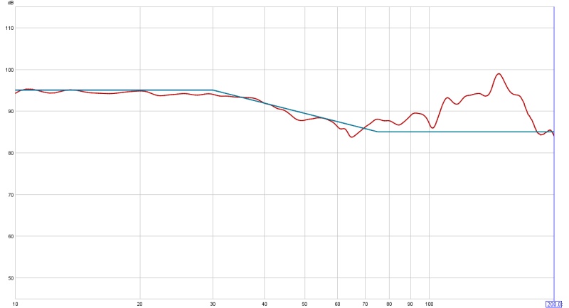

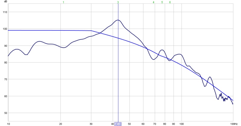

I have been using REW for a couple years, and can say that it is an excellent program! I have used it to measure first reflections/impulse response for accoustic treatments, RT60 for room reverb, as well as eq for my sub response.
I attached my in room measurement of before and after with the subwoofer. As you can see it allowed me to get rid of the large peak at 40hz and cut the upper bass frequencies to give me a lot more low end extension.
Sub and Mains
 Filesize:  39.56 KB
 Viewed:  257 Time(s)
Sub Only
 Filesize:  48.29 KB
 Viewed:  257 Time(s)
