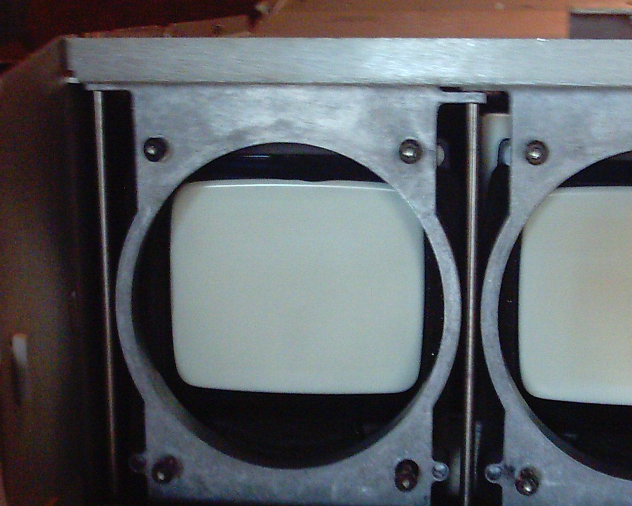

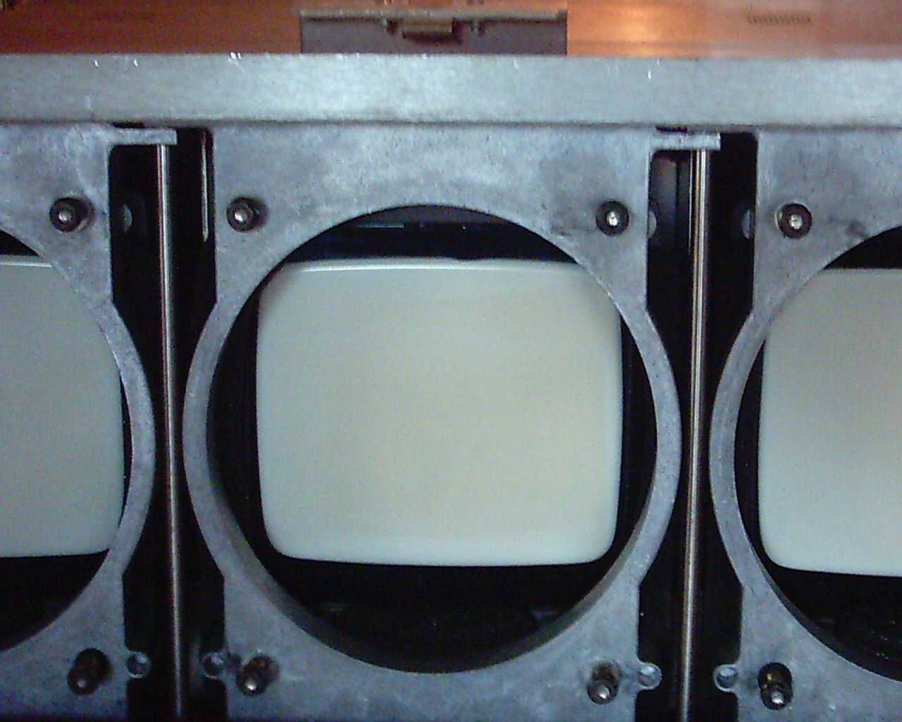

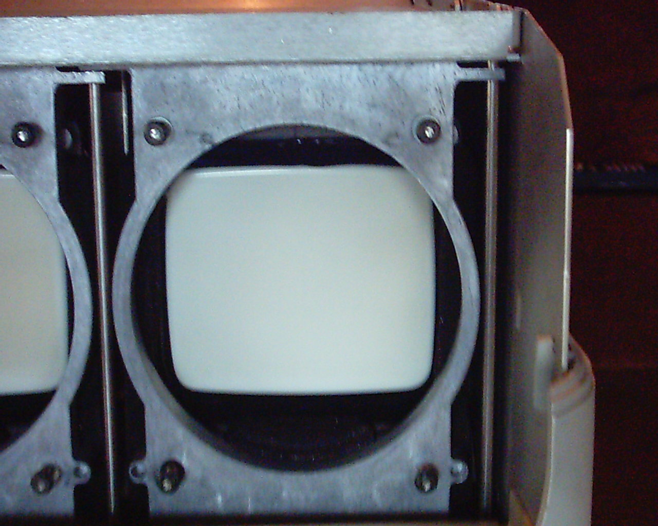

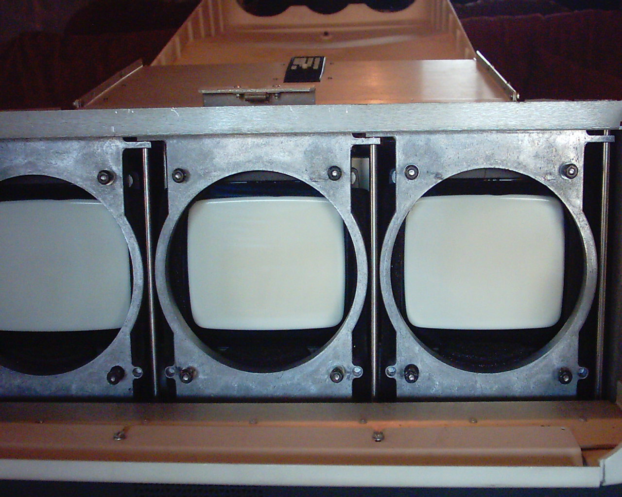

I removed the lenses today and this is what I found:
I noticed the greeb tube does have some wear on it, but i hope not enough to prolong the setup. Man I downloaded the user and install manual for the bd808...fwhew...guess I got to get that dvd you suggested. Can I start to do somethings while I am waiting, or should I wait for the dvd?

barcoguy
Joined: 05 Feb 2008
Posts: 128
Posted: Fri May 16, 2008 12:32 am    Post subject:
You got one HECK OF A DEAL!!!!!! Those are NICE TUBES!

Person99
Posts: 4899
Location: Flower Mound, TX
Posted: Fri May 16, 2008 1:02 am    Post subject:
You got a steller deal.
