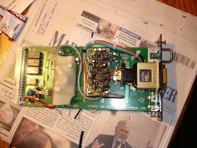

Boy does she get pissed when I do this on the kitchen table Laughing

Even cooler if it works. Do you recognize all the four main parts?
It took me two days to build it one handed Rolling Eyes

Where are the RGB wires going to? What is the board just past the fury for? Also, what did you do where the caps are covered?

A Mike Parkerized HD Fury to fit an Ampro input slot mebbe? (wild guess) Chip did not like being on the Moome/Ampro Ignore List.

Not an Ampro card. It's an RGB input card for a NEC ISS-6020 switcher.

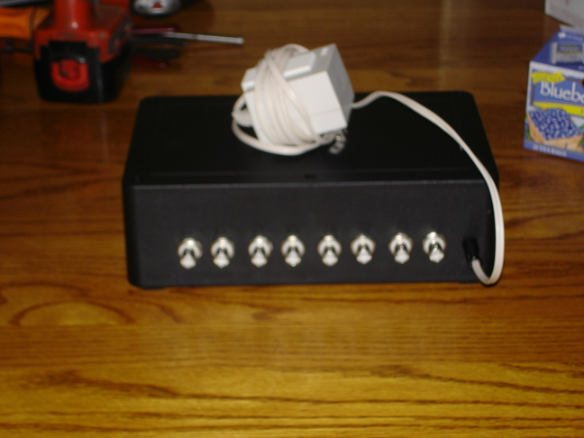

Here's another picture that I owe someone

Hey that kinda looks like tse's gamma card in a nice box Thumbs Up Thumbs Up Thumbs Up

Looks like a nec rgbhv card modded to hold the fury, nice idea I see this hapening to lots of other RGBHV internal cards now. it be nice to try on a second rgbhv slot 2 marquee card.

power supply>gamma>fury all on an ISS card Thumbs Up

Looks like an external DVI converter soldered to an input board.
There was a fella who did quite a bit of that... name started with a G but I can't recall exactly.

ISS card
HD fury
MP5
Gamma
If it all works I'm jealous. My Moome ISS card is a POS.

I'm going to pop it in tonight after Christine goes to work. Assuming it works, I'll have to make Projector adjustments as the phase will be different.

I could probably shorten it up another 1/2 inch if you think it'll help Wink
In the event that the Fury won't pump 1080P as is, I can ad external power from the same 5VDC source as the MP-1.
The HD Fury would not do 1080P from a Toshiba HD DVD player without the external power supply but will do it with a Sony PS3 without the external supply. Testing will start sometime after 3:00PM
