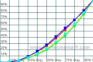

Post your Luminance curve and your gamma curve too. The 2.22 and 2.35 values are just averages. It's important to see what you're doing too. My feeling is that as long as you're not way off (neither of your numbers are) and you're not losing low level detail you should be fine. That's why I'd like to see the low end gamma values and the Luminance curve to see how fast you're coming out of black. If it's not fast enough, you need a gamma boost from something like an RTC2200, Box1020/1021, Moome card/box, scaler adjustments, etc.

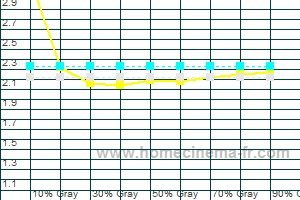

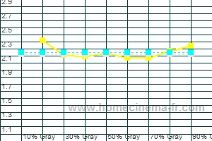

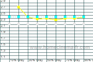

Here is one of the Luminance and several gamma plots showing the variation. Ile is helping me in another thread as I try to get the RGB levels right, as seen in the luminance plot...(something might be related to a new green tube). But I'm curious as to how I'm "changing" gamma. They are in reverse order (and the coloring of the jpegs exported from HCFR is awful) but you can see if you go from gamma.jpg up to gamma3.jpg the average gamma of my projector keeps going up starting right at about 2.2 and up to about 2.45.
I thought what everyone called "gamma" was fixed for your projector and couldn't be changed.
BTW-I have a tse gamma box I built so coming out of black is usually pretty good.
