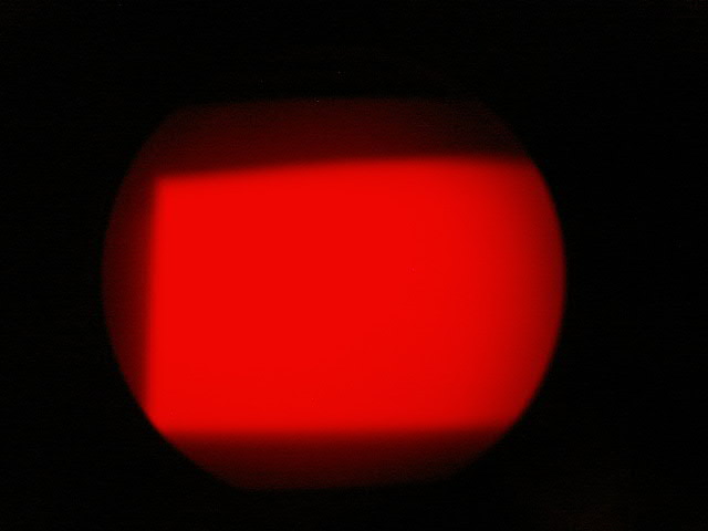

Not really any diagonal lines, with some imagination, I can see a "pattern" going almost horizontally (but it is very faint an unsharp). Theres no distinct edges of the raster - it just blurs out.
Hmm complicated to describe. I tried to take a picture, but it does not really look as in real life; in real life, it is much more uneven, noisy, and kind flaming/pulsing. And more faint. But as you can see, the raster area is visible, albeit no sharp edges. Not sure if that means anything.
By "Swap the video amps", do you mean the neck boards? Or earlier in the chain?
