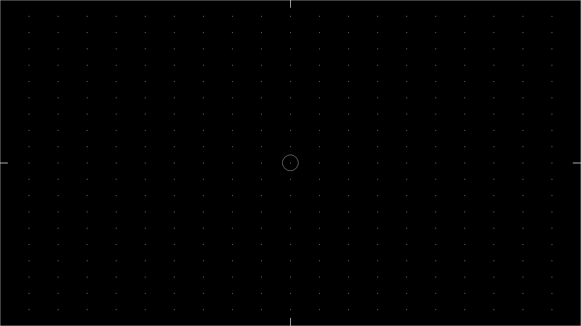

Here is also one, i dont know heck about how to make diy patterns so i asked at one friend to make this one for magnetic/astig. setup. Thanks to him. (TNR)
That circle in center helps little with 2/4 pole setup.
