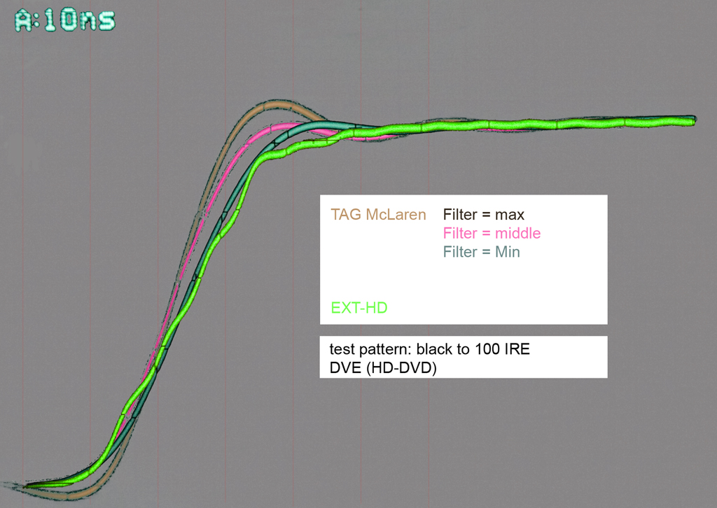

Allow me to expand on the edge enhancement a little: I like to point out that there is a less dramatic visual affect when watching a movie compared with looking at a still picture, particularly if it is a test pattern. Test pattern include maximum transitions, which are rarely observed in reality and if there are less sharp transitions then there is less the need or ability to enhance edges.
Having said this, I have used a test pattern, showing a 100IRE rectangle on a black background (DVE, recorded on HD-DVD - this test pattern includes also additionally PLUGE, 2 and 4% grey, but that part is not shown on picture_1). I have, in order to visualize the affect of edge enhancement better copied 4 diagrams (recorded using a scope and then being photographed) on top of each other. The traces have also be color converted for ease of visual separation. I had also to horizontally shifted them slightly because the trigger point was moving with the increasing slope.

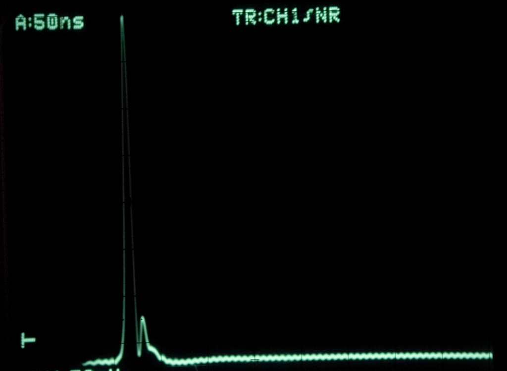

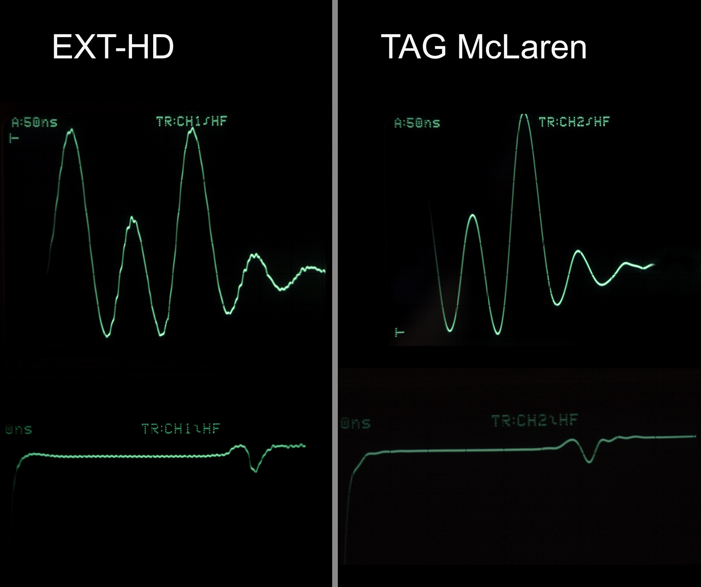

If you look at picture_1, then you see the video output (G) of the EXT-HD compared with 3 outputs of the TAG McLaren’s VSM2048 (inside an AV192R), recorded at 3 out of 7 potential steps of edge enhancement.
Non of the traces increase suddenly from 0 to 100, how could they. I do not know the steepness of the recorded transition (I guess 3 pixels) recorded on the HD-DVD, but we can see interpret the differences between the traces:
The EXT-HD’s output is shown in light green, it is drawn above all. Let’s ignore for the moment the modulation on top of the trace which I will cover a little later. What we can see, is that the trace climbs initially approx. linearly (once again ignore the hi-frequence modulation) but then reduces its slope when it reaches about 90% of the required amplitude. It takes then approx. another 14ns to reach its required level.
The edge enhancement filters within the TAG McLaren allow to reach the maximum faster but that comes, at the highest setting, at a price: ringing. However, looking at the default = nominal = middle setting which was selected as the best compromise, it can improve on the signal shape, proving that careful edge enhancement can indeed be beneficial.
The shown slope is approx. 4.3IRE/ns but that isn’t the maximum achievable. There is a test pattern on DVE (HD-DVD) called DOTS. The description describes them as single pixel transition with 100% amplitude. Picture_2 shows them for the EXT-HD. The output increases within approx. 10ns (10IRE/ns) , the same time it requires to get it down again. A pixel width would be approx. 8ns. Please note there is a second, smaller peak, which most likely is real (but might be a measuring artefact - I doubt it). I guess it an artefact caused by insufficient output filtering (allowing higher frequencies than sample clock/2). This leads us back to the observed high frequency modulation.
This modulation is, in my opinion, if it proves to be correctly identified, a problem as it affects the whole picture quality. Please look at picture_3 and you will see that this modulation is always there. I do not know the circuit diagram of the EXT-HD but I know that the TAG McLaren’s analog video outputs have 5th order Butterworth reconstruction filters with a pair of stop band zeroes for additional pixel clock suppression. The filter was added to remove image that occur above sample_clock/2 as they are not real. The additional stop band zeros are added to remove pixel clock artefacts. The result is a clean signal.
If my observation is indeed correct, then I believe additional output filtering is necessary and would improve the picture, but of course the “modulation” could also be caused by “imperfection” within the circuit layout. I remember that extreme care has been put in the TAG McLaren to separate analog and digital voltages and stabilize them locally. That might also be the case within the EXT-HD but I do not know, in the end the EXT-HD is a black box for me.
Summary: I think I have been able to show that the analog output of the EXT-HD isn’t limited by the capability of its video DACs or video buffers. However, I have also been able to show that edge enhancement can improve the video output, although its affect might be less beneficial when watching a movies (compared to looking at still test patterns). Finally I believe I might have identified a problem with the EXT-HD’s video output which might be caused by insufficient filtering, pixel clock artefact removal or basic layout.
Disclaimer: Everything I have measured is applicable to my EXT-HD and might therefore not be the case for other units. Great care has been taken to get the results but my technical tool are limited.

Posted: Fri Apr 11, 2008 1:25 am    Post subject:
Hi Udo,
I'm not familiar with the Tag unit you are using, could you give some info on it? What EXT unit do you have?
Interesting scope shots. I would alomost bet that the video dac in the ext has no post filters which would probably explain the ripples that you see on the waveform. Interesting enough the manufacturer of the HDMI chip which also includes the dacs internally (if you have the unit I think you do) only recommends a ferrite bead/cap for a post filter. Hardly the 5th order butterworth filters the Tag uses, does it make a huge difference, I don't know, I know Tag equipment is very expensive.
It appears that the rise times of both signals initially the same but when they reach the top it almost seem like the EXT signal is either BW limited or the Tag is slightly peaked in the BW to get that overshoot. Again the rippling seen on the EXT waveform is probably the result of no post filter.
The 2 signals in the 3rd picture look similiar from what I can tell with the exception that the EXT waveform again has the unfiltered look to it. Don't forget that while filters do clean up the sampling artifacts like the ripples they also tend to soften the waveform (picture). What is the bottom trace in the 3rd picture?
Perhaps you should take your blackbox configuration a step futher and open it up and scope the dac output right at the 75ohm load before it goes through the other stages because the other stages include more than just a buffer. I'd like to see what the results show for that, you could also add a ferrite bead and a small cap (10pF, 27pF etc) and see what it does for the ripple.
Interesting artifact(2nd peak) in the second picture. Where's the picture of the Tag output for this input?

The ripples are, as you say, and as I think, caused be an insufficiently processed (not edge enhanced!) analog video output.
I could not produce picture_2 with the TAG McLaren VSM2048 as it cannot store 1920x1080p, it downsizes the input to approx. 1300x1080p. As a result the one pixel wide peaks are not reproduced with identical width; they vary by a small fraction. Not an issue as such but because I do not have access to an storage oscilloscope, I cannot make a steady screen shot. As soon as I have some time, I will try one using 1920x1080i as that can be processed and as the peaks are one pixel wide, it shouldn't matter, if I use 1080i or 1080p.
Picture_3 has been recored at 50ns/div.

That must be it, Walter, since the ripple frequency seen in the scope pix is at 149 MHz (4x 37.25 MHz), and is only ~40 dB down. At that point, spurious products should be at least 60 dB down, but you don't get that without any filtering.
- Tim
VideoGrabber
Joined: 09 Apr 2006
Posts: 933
Location: Michigan
Posted: Sun Apr 13, 2008 3:43 am    Post subject:
Udo,
really nice job on the edge enhancement graph.
If the EXT-HD were properly filtered, its output would closely approximate the Min filter setting, but with 0 enhancement. It would be hard to fault the Min filter setting from the TAG McLaren, unless the source material already had EE applied, which would then be amplified even further. On a big screen, problems like these become painfully obvious.
Completely clean source material may benefit from the Mid setting, but the Max setting would be significantly worse in most all cases. Note it exhibits both undershoot and overshoot, which result in both light and dark outlining of ~15 nS (several pixels wide @1080p) around object edges.
