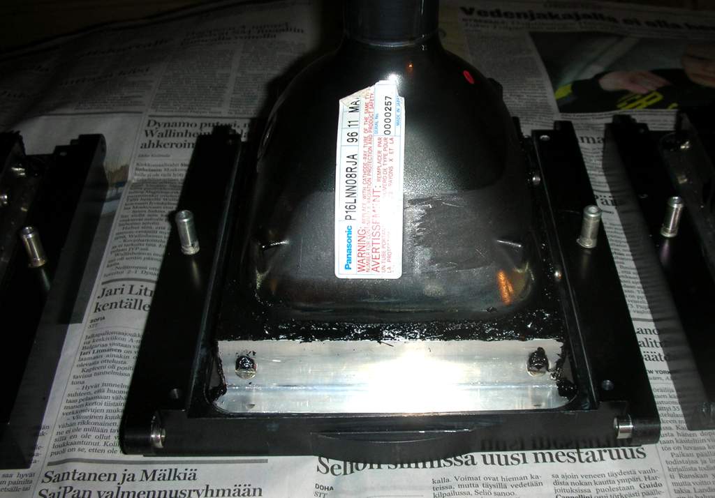

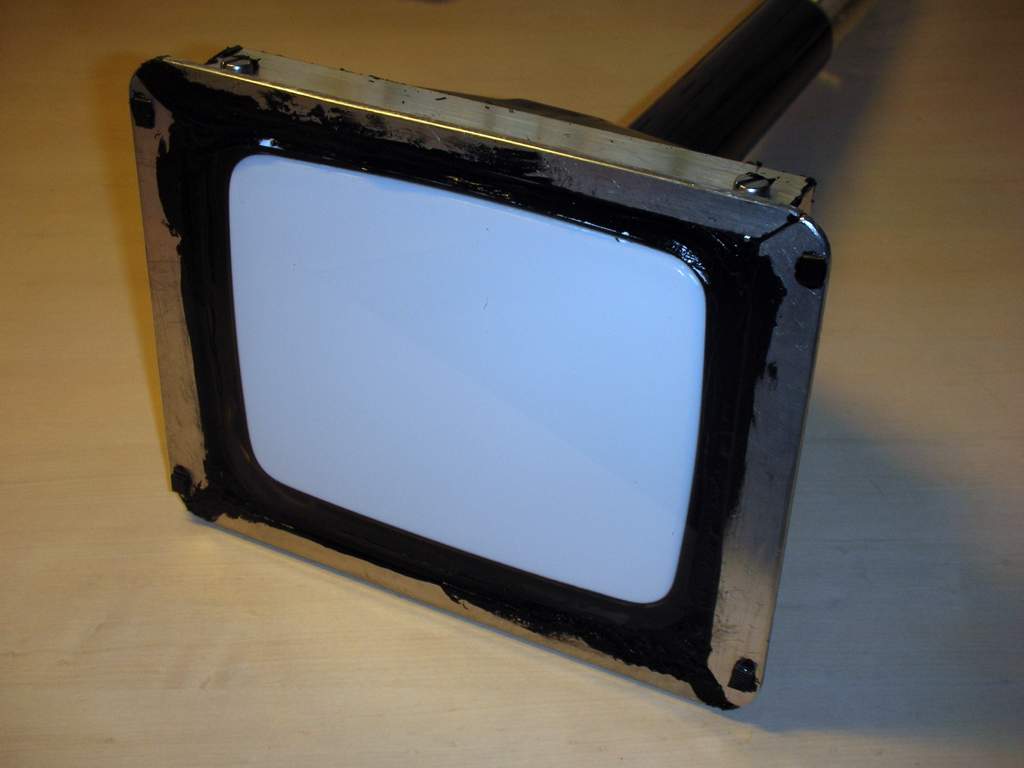

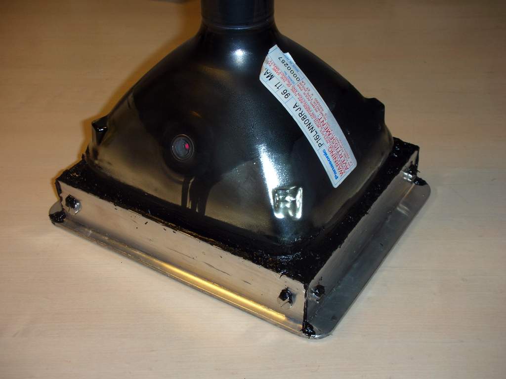

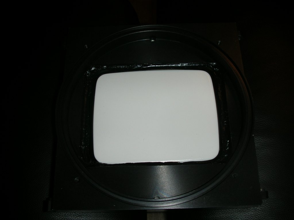

There's probably no one that has done this before. Laughing
I have all parts for it already, so why not to build one?
BG808s with about 11000 hours, original Sony tubes are pretty crappy (9,6,7)
P16LNN tubes
BG1200 LC chambers and frame for tubes, it’s 4" wider than 808 frame.
Color filtered c elements
HD10GT17 lenses
I like idea of 8" LC with HD10 lenses, because that combo have long throw, good colors and corner focus. First I was going to build this with 9" tubes, but 9-10 rated cost too much and are hard to find.

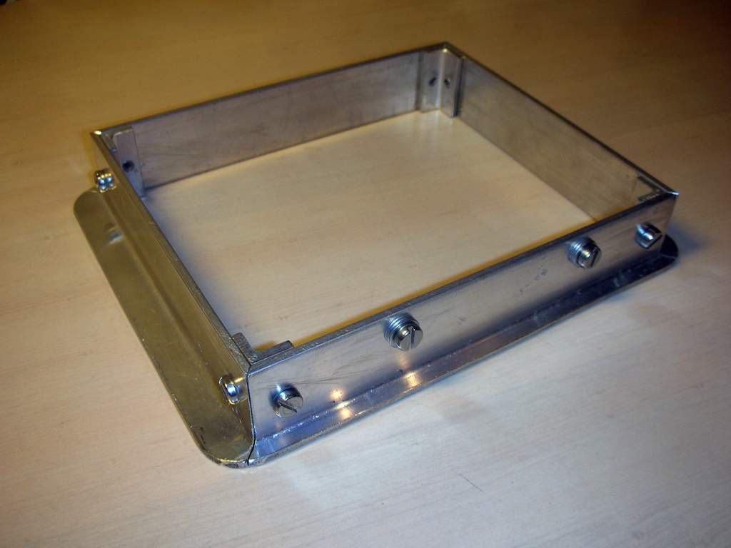

I already made tube adapters to fit those in 9" LC hardware.
BG808s neck boards needs also few chances, because every voltage need to be chanced to different position. Yesterday I finished first amp and going to test it today.
808 side panels need also some modification to make room for tubes.

No continuous sheimpflug in 1200/1209 housings. But as you see in my second picture there is small guide peaces (variable thickness) in corners to make glueing to hardware as accurate as possible. Adapters are glued to tubes in flat surface to make them to same level.

I think I have read about that rare LC 1208 from avs few years back. But I'm going to use 808 frame, because 808s high convergence tray wont fit to 120* series frame. Also BG1200 frame is pretty badly shielded, there is no aluminium covers over tubes etc.
Yep, I got idea from M8500LC.
Surface treatment isn't needed, because adapter won't be in contact with glycol.

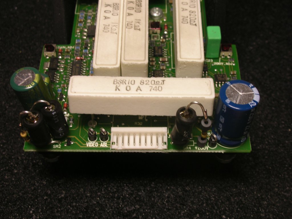

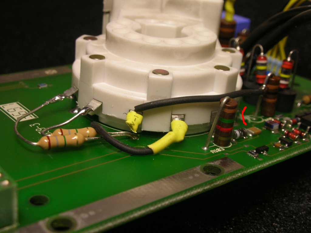

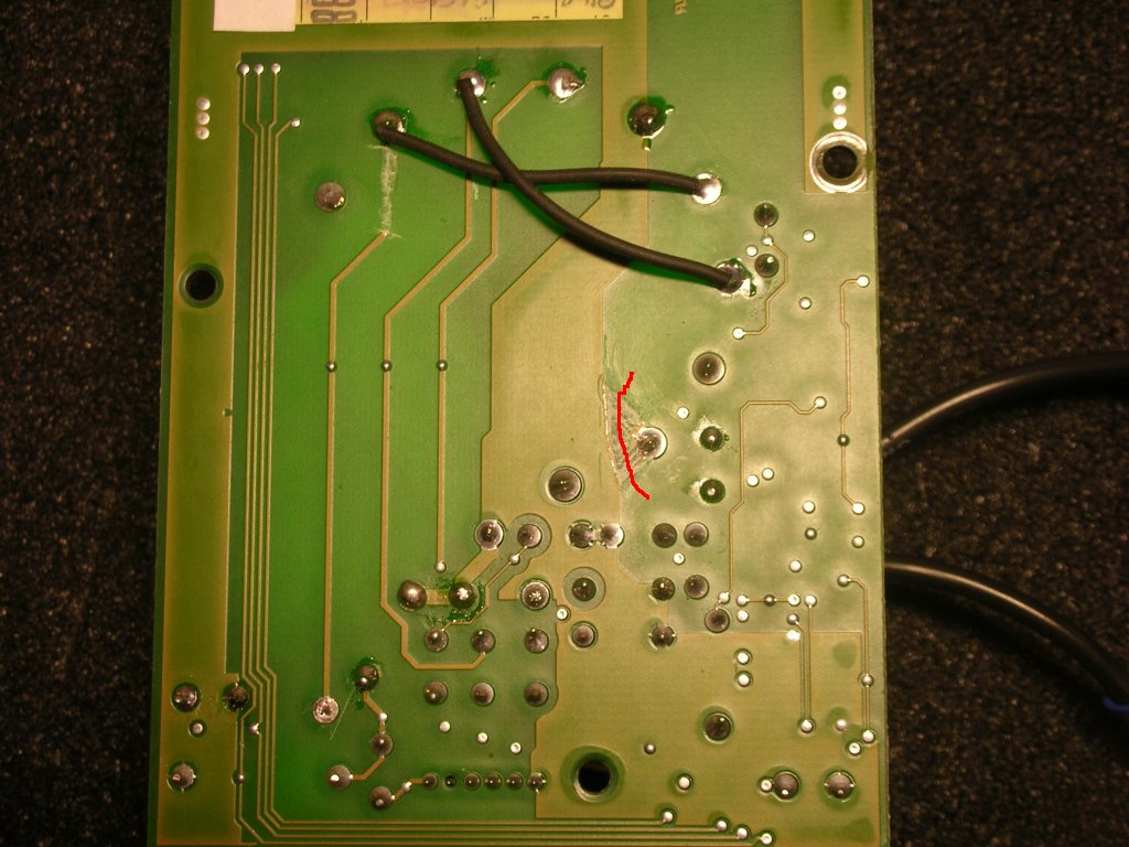

Just tested modified amp to Jarmo's (1031) Marquee test tube (toast red ac), neck board seem to work fine. Very Happy
Picture was about 30% smaller in that Marquee tube than in other two Sony tubes. Probably normal...

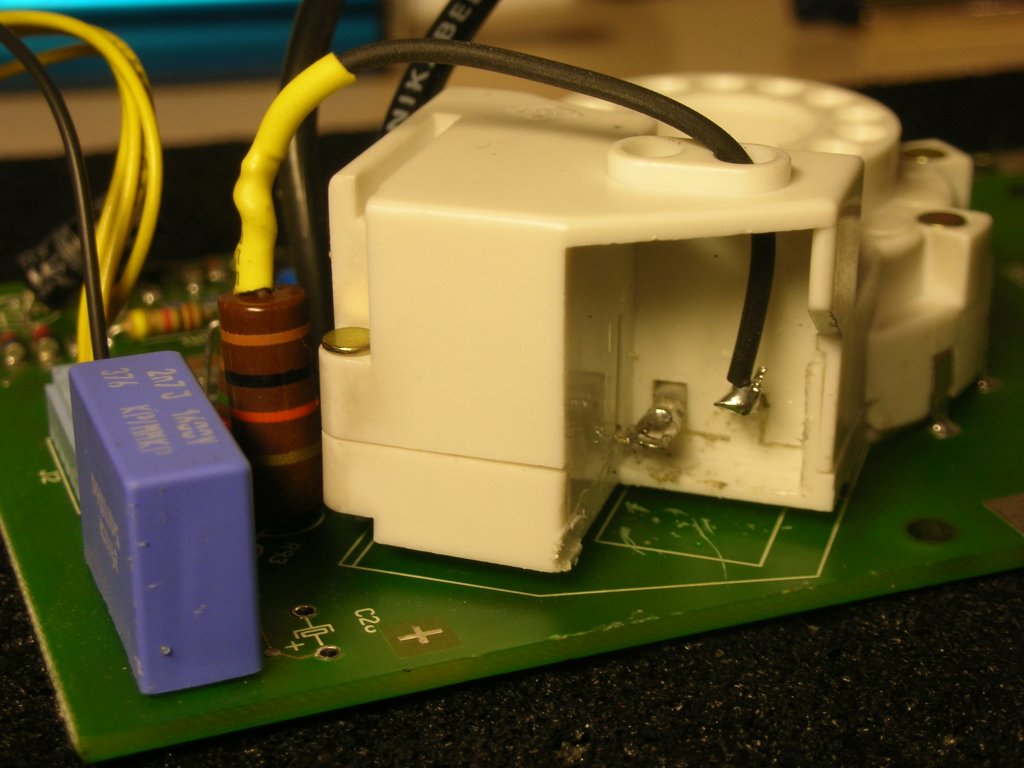

Few pictures of neck board mod.

Posted: Fri Mar 28, 2008 8:50 pm    Post subject:
There's some kinda red thing on your neckboard in image three there... Wink
Ile
Posts: 1491
Location: Jyväskylä, Finland
Posted: Sat Mar 29, 2008 12:15 am    Post subject:
That must be flux or something. Very Happy
I almost forgot to cut that ground trace, that would short G1 to ground with Marquee tube. It's too complicated to me when three pin goes to same place. Very Happy

Posted: Sat Mar 29, 2008 6:52 pm    Post subject:
Why mod the neckboard ?
My green and blue Sony 07MFP2 tubes are too burned for my picky taste, so I had to find new tubes. Good shape green and blue Sony 07MFP2 tubes aren't available, so making simple pin out mod and using M8500LC tubes (MEC) was cheapest option for me to get good tubes.
Other option was use Barco MEC tubes, but those need almost similar pin out mod to BG808s neck cards. These also usually cost little more than Marquee tubes and are bit harder to find. If pin out mod isn't option, then it's needed to find rare RG808s 120 MHz neck boards or use 75 MHz amps from 808.
Last picture was from extra line filters I added to remove noise from picture. I'm also going to ad similar filtering to other video boards later.

Posted: Sat Mar 29, 2008 9:30 pm    Post subject:
which caps did you use there on the protection resistors ?
Those are inductors in series with protection resistors
http://www.elfa.se/elfa-bin/setpage.pl?http://www.elfa.se/elfa-bin/dyndok.pl?dok=2015770.htm&lang=fi
and I also changed original line caps to double sized 105 C. Haven't tested enough yet to say if 33uH is right value, but that worked pretty well in 75 MHz amps 220V line. Some smaller sized (mA rating) work in neck boards, but I had these left from other project.

Posted: Sun Mar 30, 2008 12:37 am    Post subject:
Did you put a scope on the powerlines?
In which frequency range is the hf noise mostly present ?

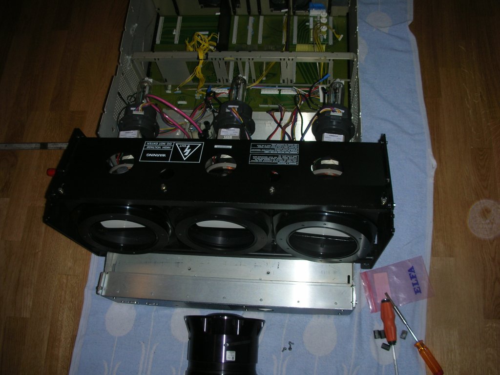

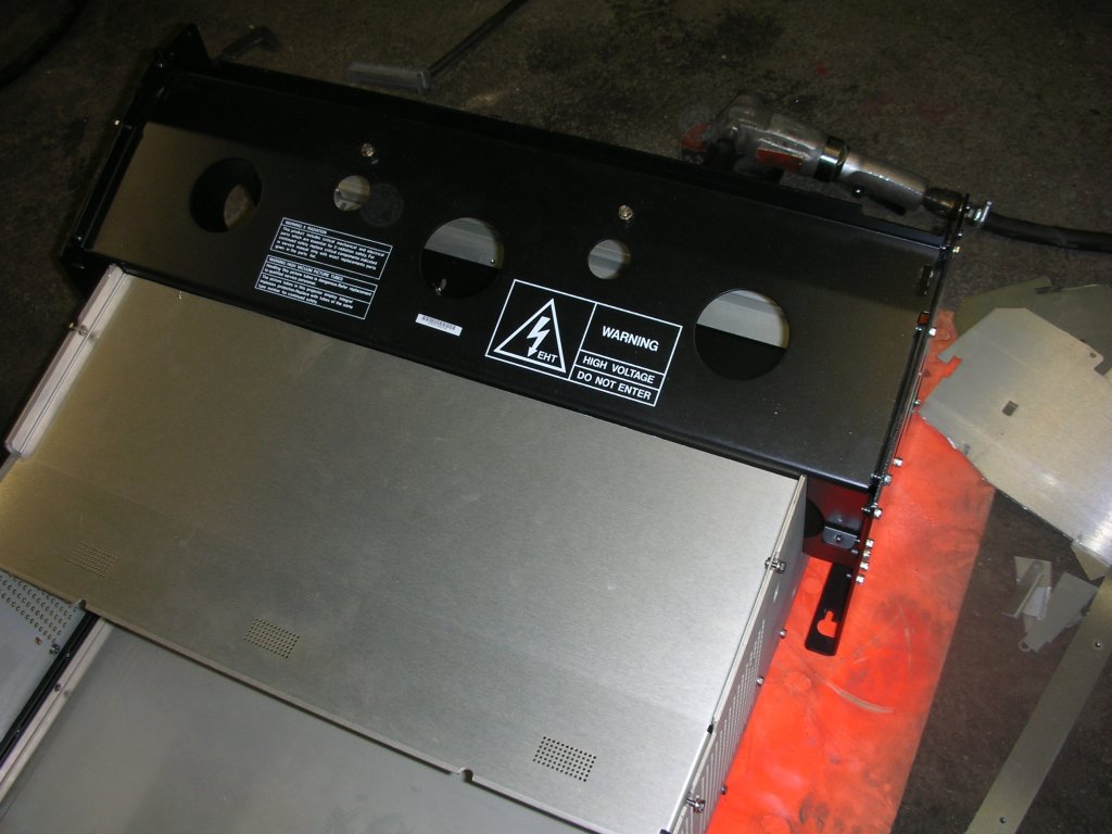

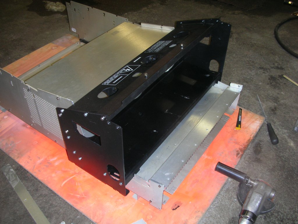

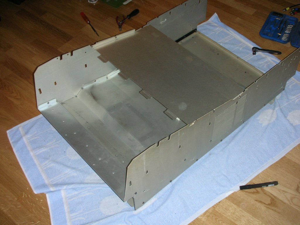

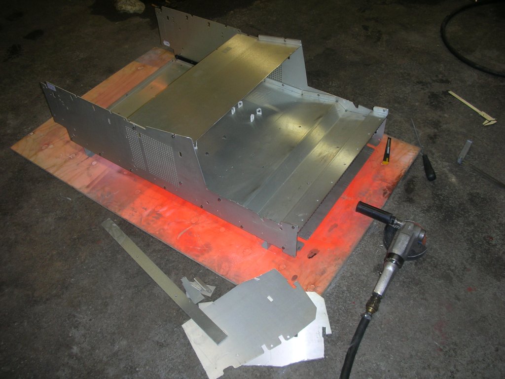

Here's few pictures of yesterday evening work. I removed everything from frame and chopped it so I got 1200 tube rack installed.
Now I need to assemble tubes and other stuff in frame to see how everything fit in place. After that it's needed to build installing hardware for tube rack.

Ile
Posts: 1491

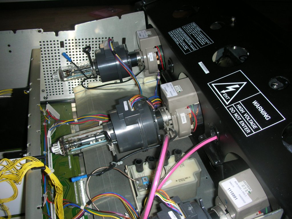

Posted: Sun Mar 30, 2008 4:25 pm    Post subject:
There seem to be just enough room inside 808 frame for R/B tube tilting. Now I have to lower tube rack down about 1/2" to get room for neck boards.

Normal casing won't fit without modification, frame is going to be too wide.
It's not problem since that hoover craft have to put inside hushbox anyway. I'm going to build it inside dropped ceiling and make air circulation to another room through back wall...
