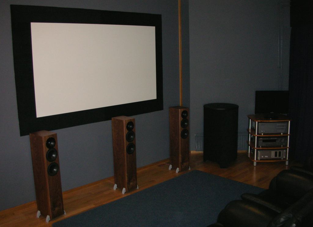

Used same gray color for front wall and glued black velvet to wall to mask overlapping picture. Picture is about 2.5" closer than black mask, it gives nice effect for diy screen with sharp edges, picture look like it's hanging in the air.
Ceiling masking, smaller equipment rack, bigger sonosub and new front speakers are still under construction...

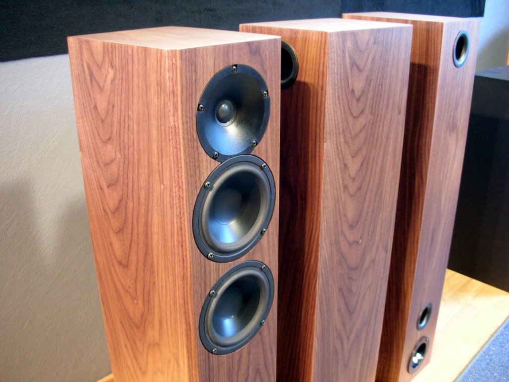

Got three AW-25i front speakers built, here's some construction pictures.
http://www.dvdplaza.fi/forums/showthread.php?t=75679&page=2
Specs:
Freq.response: 38 ... 20 000 Hz
Impedance: 8 Ohm
Crossover frequencies: 2000 Hz
Sensitivity: 84 dB
Recommended amplifier power: 20 - 250 W
Size
Height: 900 mm
Width: 180 mm
Depth: 220 mm
Volume: 25 l
Tweeter: Seas 19TAF/G-eh + lens
Bass drivers: Peerless 850601 x 2
Here's drawings and measurements.
http://www.hifitalo.com/pdf/aw25i.pdf
Souds pretty good. Very Happy
