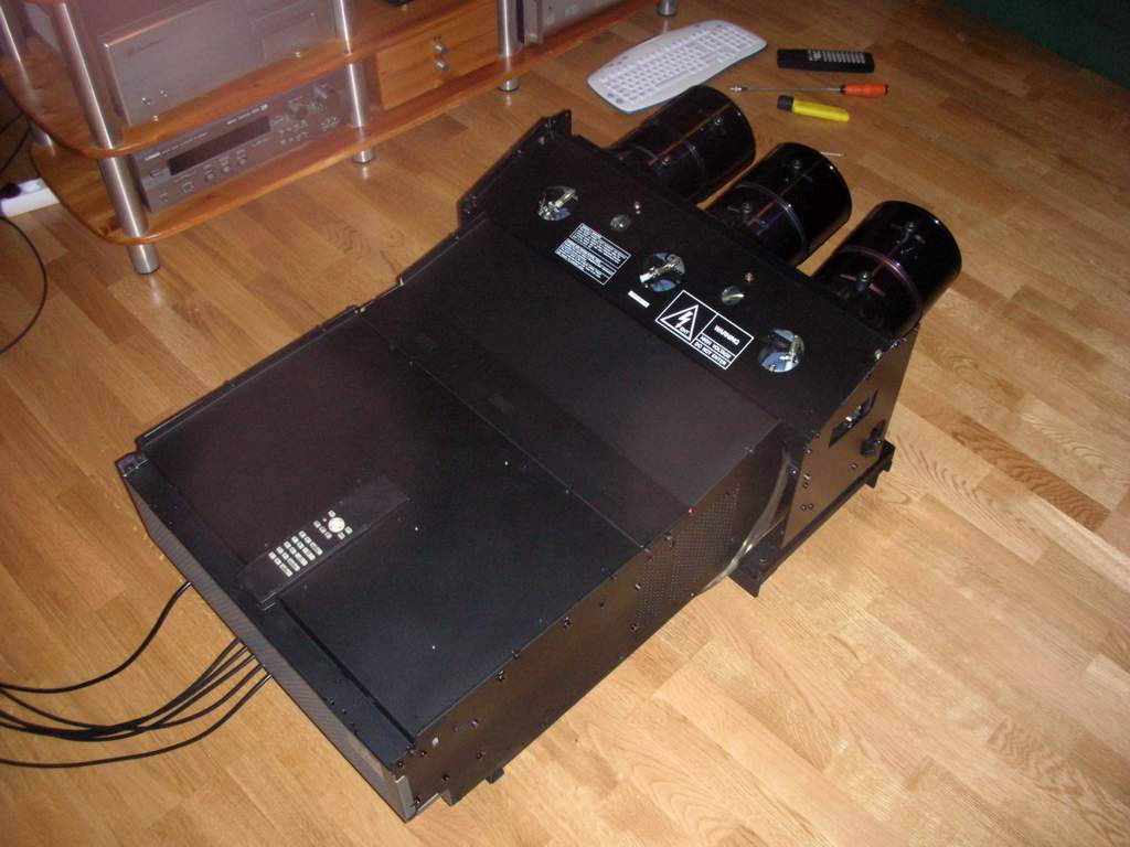

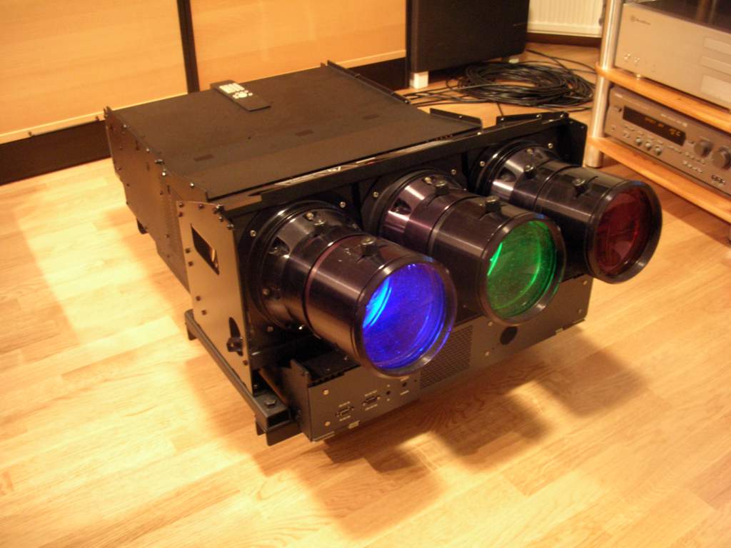

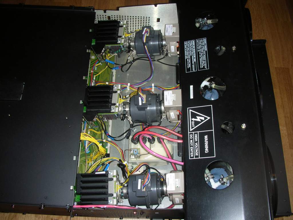

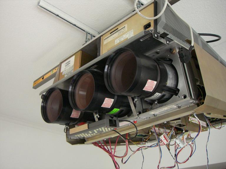

Got projector build up last night.
After start rasters was super bright and retrace lines was visible, I almost got heart attack...
But just G2 needed to turn down almost full turn, after that everything seem to be ok. When I tested neck boards with Jarmos (1031) test tube G2 looked ok as is, so that tube must have very low emission.
Heater voltage seems bit high (6.6 V) with adjustments meant for Sony tubes, so I'm going to drop it to 6.3 V today. No PQ impressions yet, but few pictures...
Yes it looks bit bulky, but that only makes me build hushbox faster. Very Happy

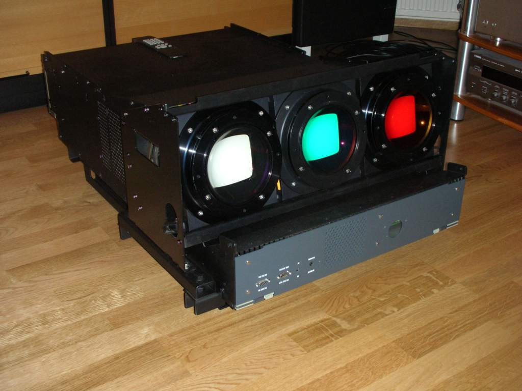

Not really beaty queen, allmoust as ugly, as marquee Mr. Green
Edit. Yes your Diy Barco is much nicer looking that naked Marquee

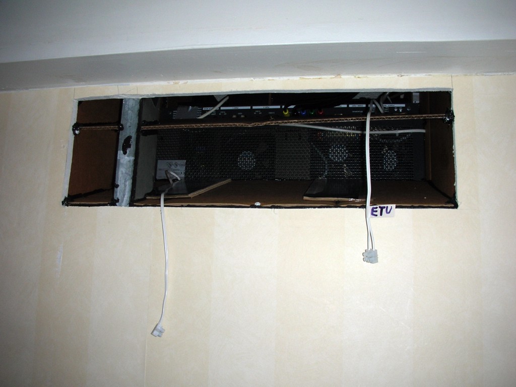

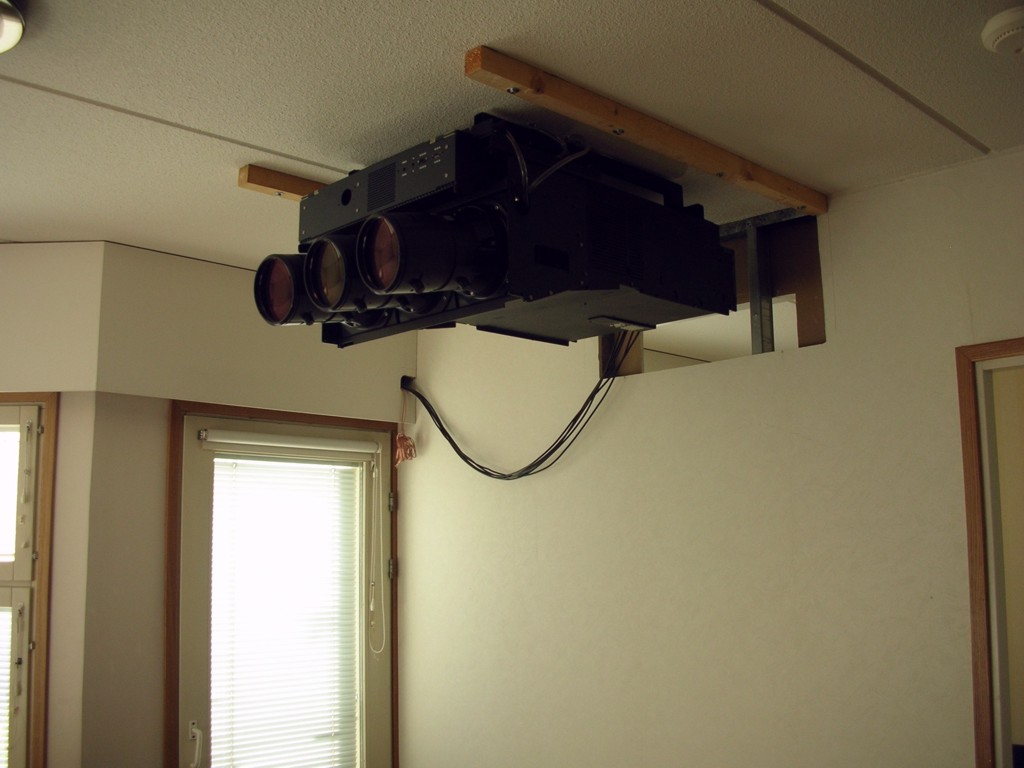

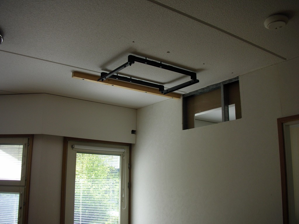

In weekend I made holes to back wall and elevated 808 to ceiling. Small hole is used for hot air channel and bigger hole over it for fresh air that is pushed between wall from floor level.
Now I "just" need to make hushbox, new screen and get ceiling and walls bit darker...

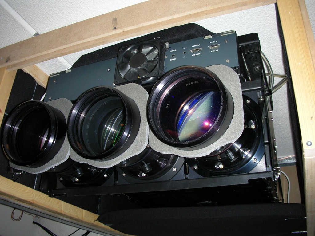

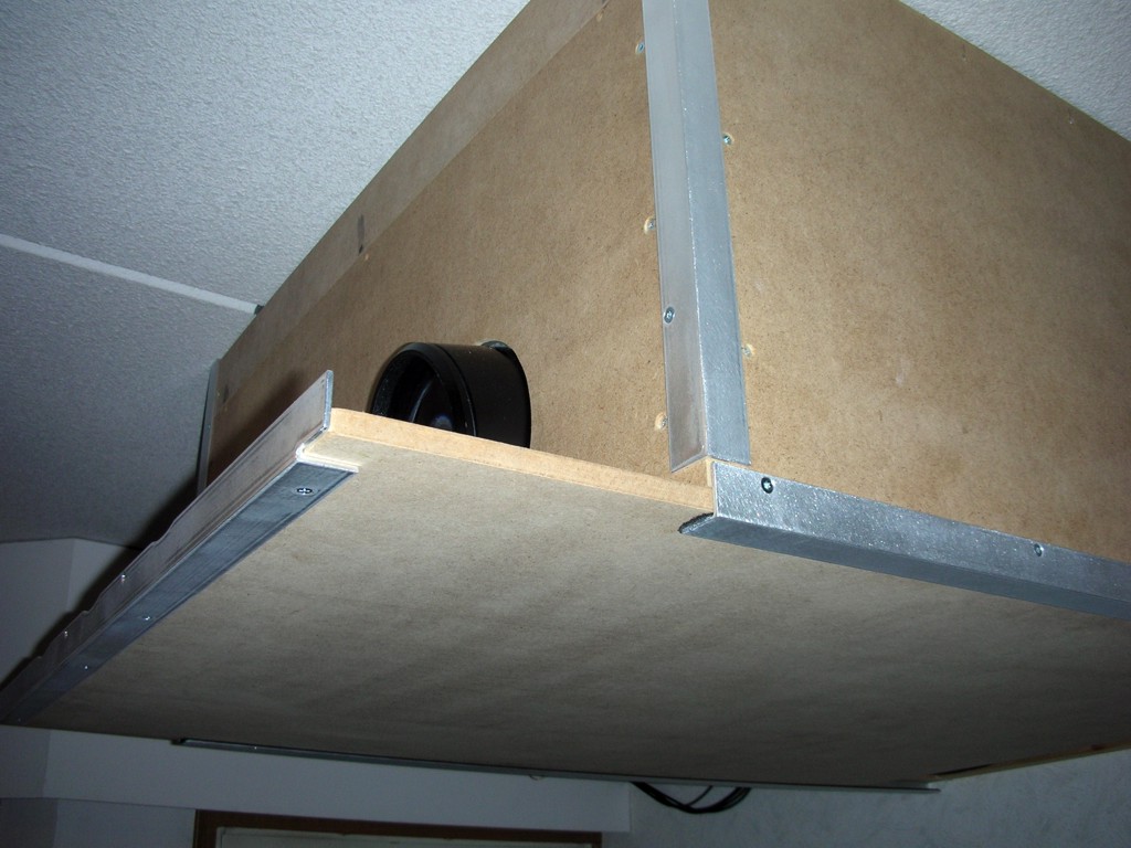

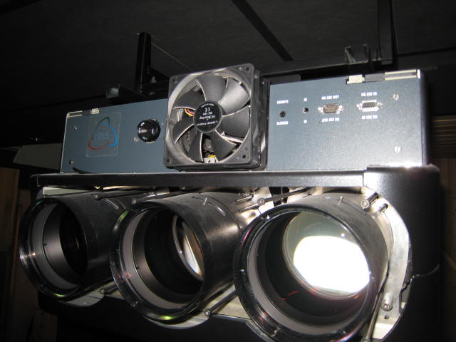

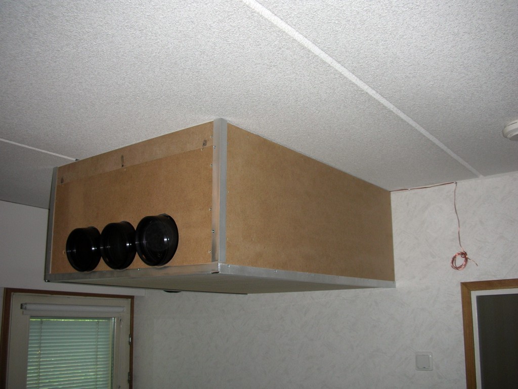

Little update.

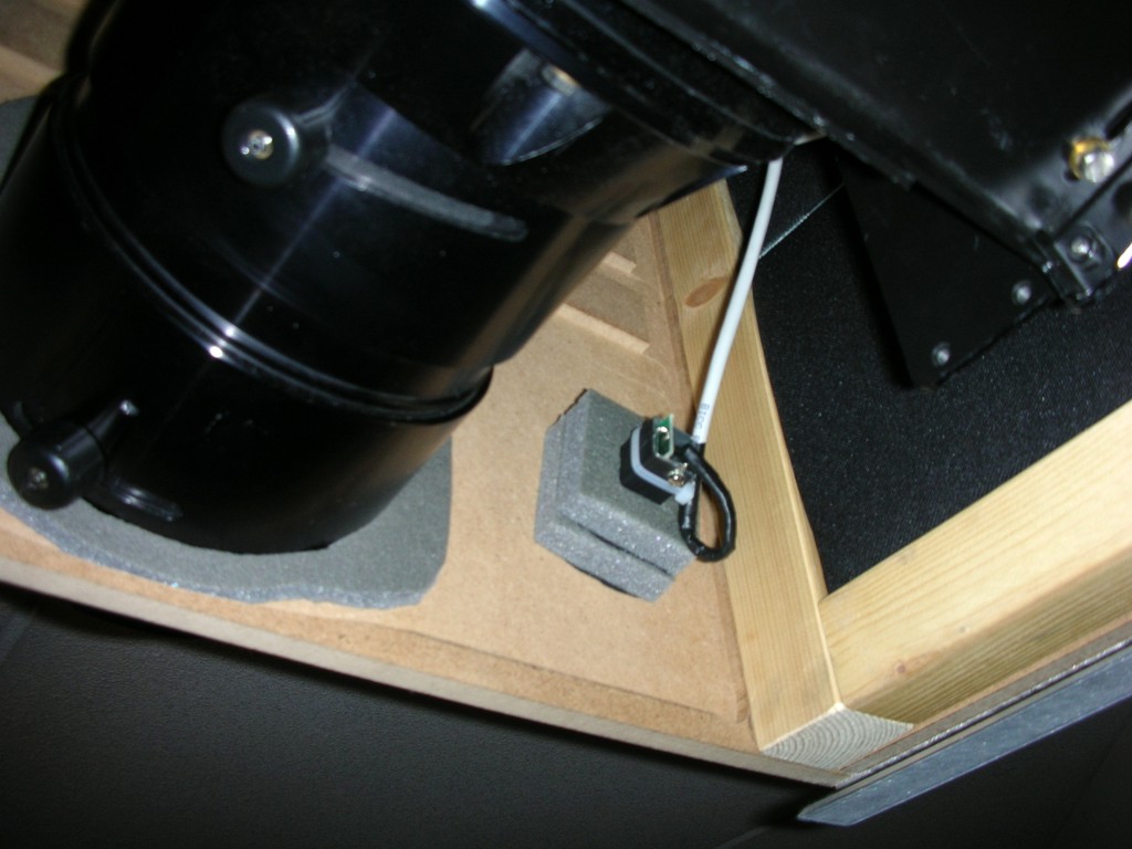

Box is working great and it's pretty darn quiet. Very Happy Bookshelf that is coming against back wall should make it even better, then fresh air fan noise through wall should be lower. Shelf under hushbox was reason why I couldn't use hinges for box bottom cover.
It still need paint and I'm going to build rear speakers inside lowered ceiling that is coming to be in same level with hushbox bottom...

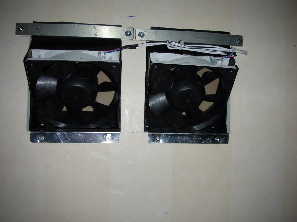

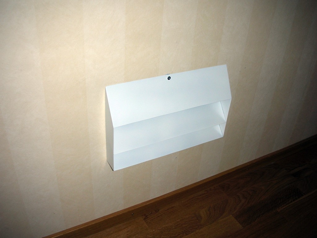

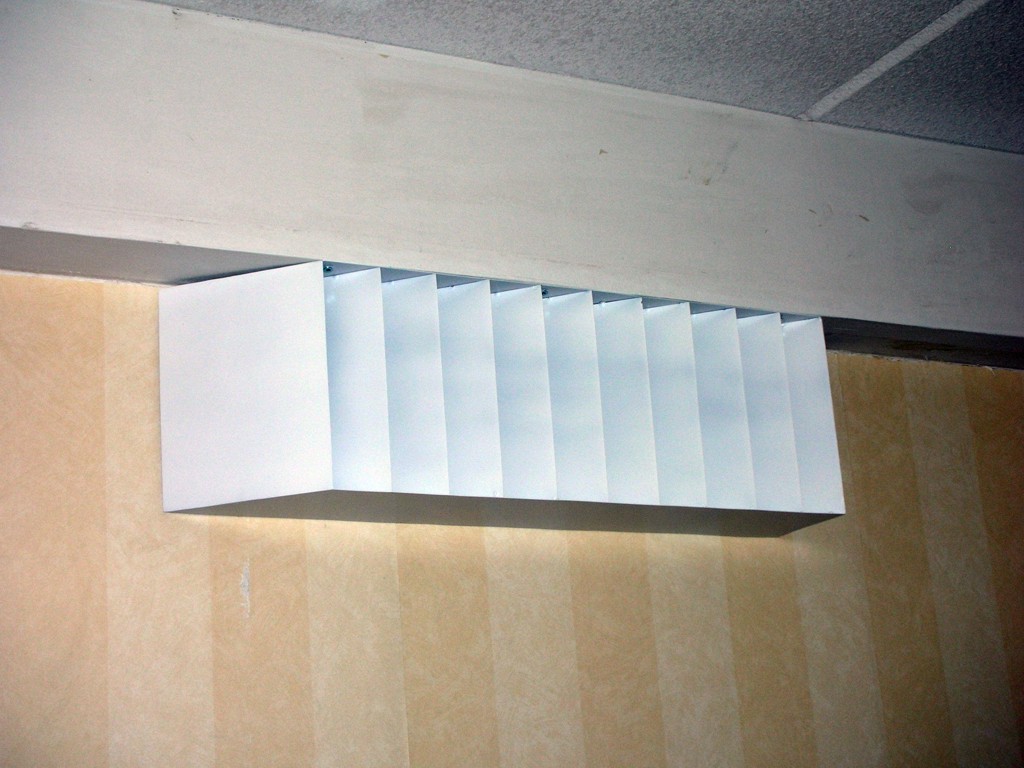

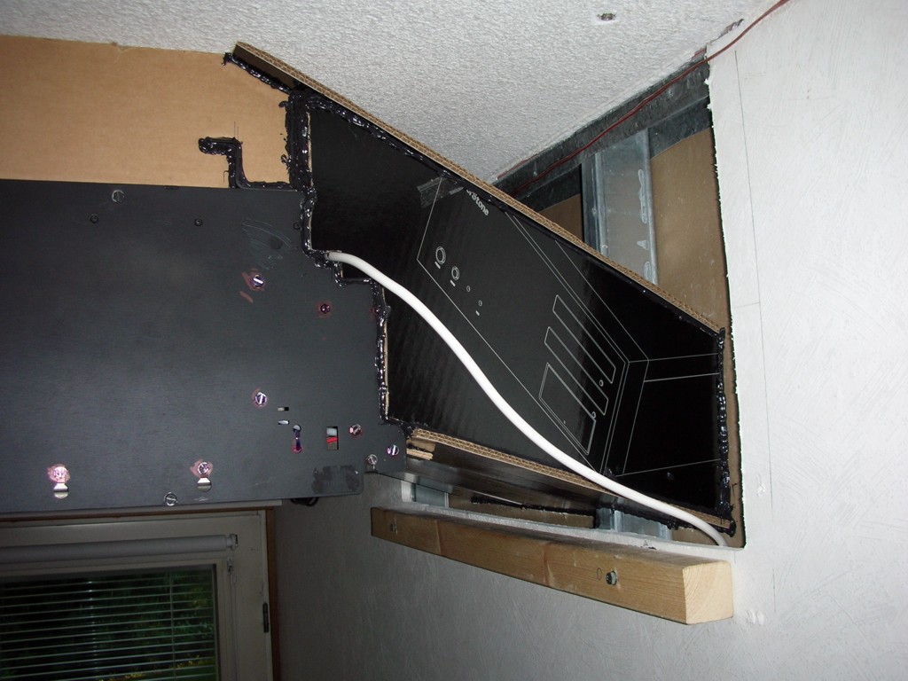

Bedroom side of wall is only ready part of my project.
I use two 120x38 mm 80 CFM fans for fresh air, those are feeded from Barco back end fan power lines. Line is feeding fans with only 7.8V, so those are quite silent. Hot air is coming out with Barcos original fans, no extra fans needed in my case.
First I dried air filtering for cooling air, but filter was decreasing too much air flow so I make only gratings for fans and hot air channel. With auto cabin filter fans was needed to run with 13 V and without filter about 8V is enough.

Posted: Wed Aug 06, 2008 1:29 pm    Post subject:
Ile, Looks very nice! Did you line the inside of the hush box with any acoustical foam?
Nice Job on a tough project!!!
Ile
Posts: 1491
Location: Jyväskylä, Finland
Posted: Wed Aug 06, 2008 2:44 pm    Post subject:
Sides, 1/2 of bottom and 1/3 of top have 2" sheets of polyester insulation material wrapped to black cloth, it can be seen in two of those pictures. Also exhaust channel and back wall (near fans) have few small peace of that same material.
