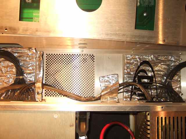

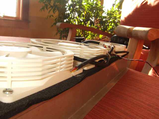

Make sure the belly fans are clean and the wires are tied up out of the way so if you ceiling mount it they wont hang down and get into the fans. Also it could be a good time t maybe do some noise reduction in the belly fan are. if you have any acoustical foam you could line the interior of the belly fan housing with it to absorb some noise I also used dynamat sound deadener. You can see how i used the foam to decouple the fans from the housing, I also have it lined on the inside of the housing. Also I added some on top of the dynamat(not in this picture) to some areas making sure i didnt restrict any airflow.

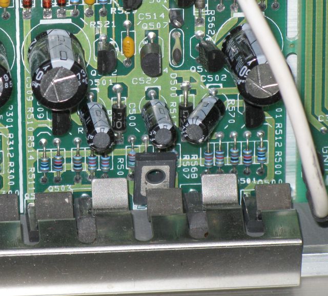

Another odd thing I've noticed... there's a transistor bent down and not enjoying the benefit of the heatsink... Q502 on the convergence board. It looks as though it was bent down intentionally, as it was well clear of the spring clip.

Posted: Sat Apr 05, 2008 10:37 pm    Post subject:
That shouldnt be bent down, even intentionally . it must have been bent down during a repair. i'd pull the clip off and put it back. but i dont think that would cause your problem i'd have to look att he schematics to see what thats for.
Ok I looked it up and that is in the blue vertical convergance section. so once you get it all back and running and you have a problem with convergance on the blue tube you know where to look first.

The HV will still come up with any or all of the tubes not connected to the splitter. All of the transistors under the spring clips should be up against the heat sink.
