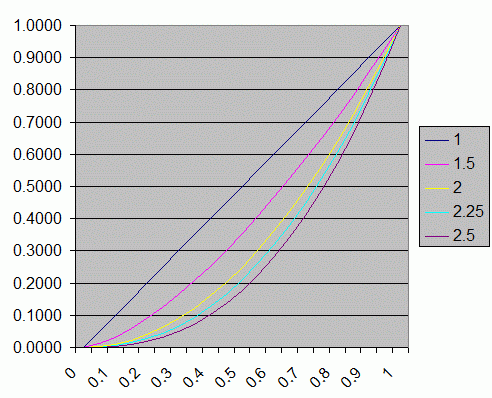

Gamma is an exponent, where basically output = input^gamma. Input is 0.0 - 1.0. So full input is 1.0 at any gamma, and higher values of gamma result in the output dropping off faster as you go down from 100IRE. See the attached pic for an example of several values of gamma. You can see that e.g. 2.25 and 2.5 are very similar, but they do have some definite differences -- especially in the low-IRE areas.

Thanks Gary. I was getting around 2.21-2.25 last time I checked (PS3 with an HDFury and an RTC2200 with about 11 turns of gamma, all driving a Zenith 1200). It looks good to me!
