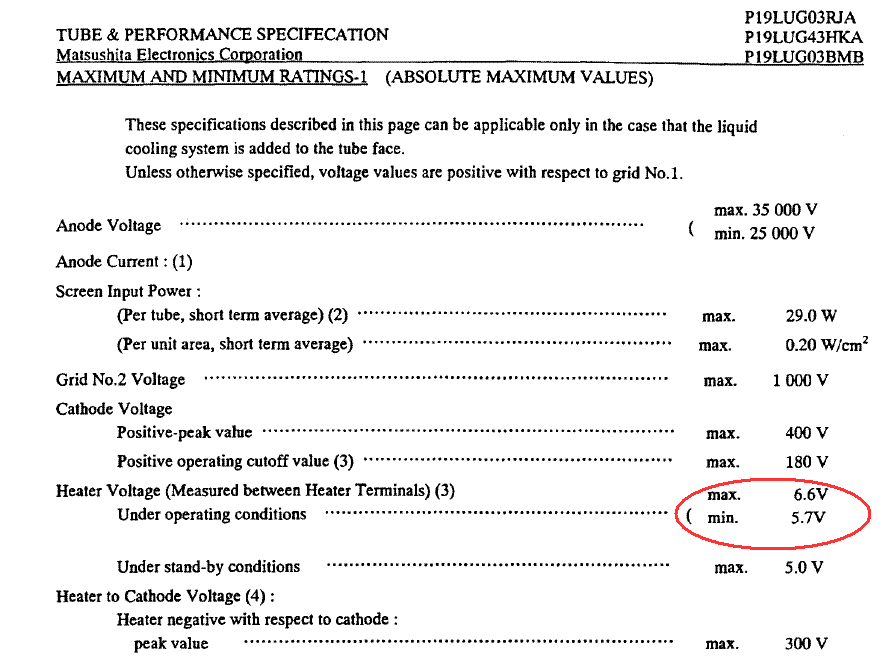

 Filesize:  30.11 KB
 Viewed:  11868 Time(s)
Thomas Jefferson
Posted: Fri Dec 03, 2010 2:56 am    Post subject:
hmm interesting Scott, those max 6.6 voltage looks too high. Now original Marquee's only had LCPs or P22's right. Do you have the spec sheets for those? I wonder if LUG's need the higher heater voltage? Is this possibly why some say they cant get the LUG to focus correctly? Do they need a higher voltage in the heater beside the Cut off voltage?

Posted: Fri Dec 03, 2010 9:08 pm    Post subject:
i'de like to know that too. I've seen burned out tubes at just 6.7 with 180DMB 8 inch tubes, so 6.6 seems rather risky unles the LUG uses a different heater?
I've also see focus suffer as you stray away from 6.35, also on stock tubes though. not LUG's.

Posted: Sun Dec 05, 2010 9:35 am    Post subject:
I agree with this, and it has also been my experience. But as you say, not sure if it's the case on the LUG's.
One thing that sheet shows and I've mentioned it before, the maximum anode voltage is 35Kv. Going above that and much below 39.4kv causes focus and blooming issues
