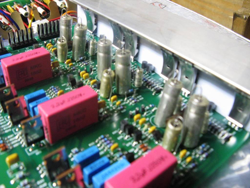

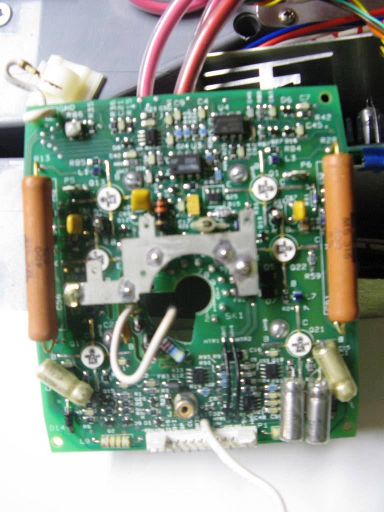

ok, here's something new and exciting Very Happy I just got this in for bellows work and maybe or maybe not board work. It's an Accurate imaging 9500LC so I wasn't sure what had or had not been done. IT's not the "super 9- X" model just the basic Accurate 9.
Note: I would never post somebody's else's work on an open forum but this company is no longer around so In my mind it's public knowledge at this point. I don't know who did the original work for them but I seem to remember Chris Stephens who also isn't into CRT's any longer AFAIK. If anyone has a problem with this please speak up (politely).
Basically what I found is that while Accurate did a hell of of a lot more than Vidikron, which basically did nothing. the biggest and coolest thing is the FGM. They added some nice looking Myca caps in the coil driver section. Neatest thing is they're axial caps which allow for more capacitance and voltage rating but still look neatly installed and like they belong there.
All the other boards are 100% untouched but the VNB's had a little bit done, not too much. The bad little blue caps at C1 & 26 were of course replaced and some additional Mica filtering caps were piggy backed over C29 + 30. Notably C1 & 26 are only 14uf and I wonder if that's enough? I remember Scott saying 22uf is perfect here?
What surprised me is that the noisy P14 jumpers are untouched, no chokes or filters were added or wires moved to back side of board. Also, the crappy little Tant at C17 is still there? Possibly an early version of the Accurate 9?

Posted: Sat Aug 07, 2010 4:09 pm    Post subject:
Yep Dragon, that is Chris Stevens work for sure. But in his notes i have of his he used Wet tants, those look like Wet tants not mica Drags. And it is odd that he has 14uf on the VNB's as his original notes say to use 120uf wet tants , i have the part number too. I think they were Vishay brand IIRC.
If you do have the entire Projector open up the HVPS, i know he did some work in there and used a bunch of wet tants in series where the film caps are.
I had a pic of it but lost it somewhere on my HD.
Posted: Sat Aug 07, 2010 4:21 pm    Post subject:
ok, thanks for clarifying. I've never seen either so it's good to know. The smaller caps close to the heat-sink do say "Mica" on them so that threw me off.
I'll double check, maybe tale a close up shot. They also say JAN xxxxx on them which might be a sign that these were possibly military spec'd part numbers?
I'll take a look if I get a chance
Posted: Sat Aug 07, 2010 4:29 pm    Post subject:
That is cool they you have one of those though, its a part of marquee Clone History. Id leave the same Caps in there unless you test them and they are leaky. Replacements are super expensive, up to 90 bucks each.
He did use BC philips caps on the other boards, I think it was 560uf on the VIM power rails, and used 22uf 50v on all the CVA caps, 560uf caps inplace of the 470uf on the VDM and Astig amp board. And twisted pair of 1uf cog ceramics on all the op amps on the vim with 22uf across the =/- pins. it mjigth not be exact as this is from memory. Haven't looked at those notes since last year. the notes are the ones given to the assembly crew who did the mods.
