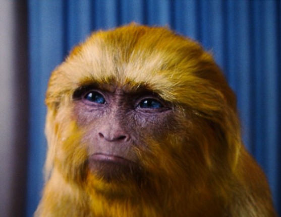

Posted: Mon May 12, 2008 10:37 pm    Post subject:
Say isn't that a young Yoda?
