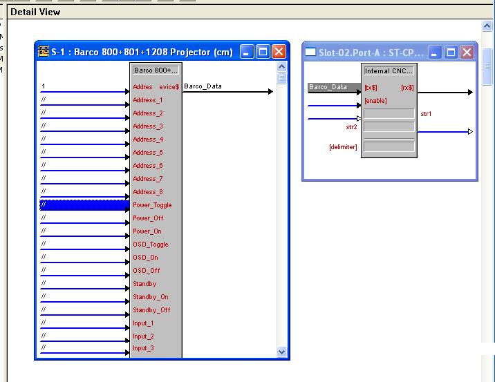

Here we go, this is going to somewhat abbreviated now that I have already laid out the steps to do much of this earlier- if you don't understand things starting at step-2 you should review the previous posts from me leading up to this one. Refer to page 6, post 8 for the index of my previous postings.
Step 1; As far as setup in Simpl, the default Baud rate is 9600-N-8-1 so if that's what the projector is set at it will not need to be changed in Simpl. If you do want to change it, go to the Configure Mode (Icon 16), then expand the System tree in the bottom right window, Find "CNCOMH-2A", expand that and right click on "Port A", select Configure from the pop-up menu. The port Configuration screen will appear. One of the tabs on top of that screen is "Serial Settings", that is where you change Baud Rate and bit settings. While your in the Configure screen you might want to Rename the "Port A, bla, bla, bla" to "Port A - Barco Projector" or something like that.
Step 2; Now goto the Program mode in Simpl (Icon 15), On the left side (Symbol Library), open the tree and find "Crestron Modules", then find "All Crestron Modules", go down the list to the "B"'s and select "Barco 800+801+1208 Projector", click down on it and drag it to the Detail View (right most window) and drop it in a open area. You might need to scroll your other symbols out of the way first.
Step 3; In Program view (middle window), open "Central Control Modules", Then Slot-02: RS232", then click down on Port-A and drag it to the Detail view just to the right of the Barco symbol (keep them both on your screen at the same time) See Attach pix below;
Step 4: In the Barco Symbol, the only hookup on the right is Device$, this is the serial output that needs to be wired to the serial port-A symbol. Click on it and give it a name like "Barco_Data" (nice pun).
Step 5; now click on the label you gave the signal in Step 4 (Barco_Data) and drag it to the TX$ line on the RS232 Port-A Symbol (it's in the upper left hand corner)
Step 6, Wire up the button press's from your Touchpanel Symbol to the Barco Symbol like you did before with the other IR devices.
Step 7, Right click on the Barco Symbol and select "Make Symbol Complete", that will add "//" to all unused lines and take the "*" off of the top of the Symbol and allow you to download your program. At this point your program should look like the picture I have attached below with the exception of the buttons you have wired up. If your program looks different you should review the above steps again.
Step 8, Connect your Barco to Port-A on the Controller, download and play!

Posted: Tue Mar 25, 2008 12:16 am    Post subject:
Hey thanks Jeff ! All is up and running 8) Would like to upgrade the ST-CP any ideas ?

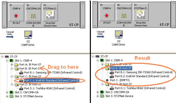

How many total devices will the ST-CP control with four separate emitters ?
You can have many devices on one Emitter, so use the blaster to cover several items, the only real reason for more IR ports is if you have two or more identical pieces of equipment that use the same IR codes, then you put a separate strip on different channels, otherwise you can combine any number of strips together using an splitter or amp. I have about 12 devices on one port now on my system with no problems. I also have a CNX series controller which is the same as your st-cp.

Tom.W wrote:
Thanks Jeff. Not expecting any conflicts but how do you combine all commands to one IR emitter channel ?
Just drag another IR driver to the same port, in the system tree you can even pull them from one port to another so if you already have a DVD on port2 and you want to have it come out the blaster on port one, just drag it from port2 to port1. Like I said you can stack any number of IR types on one channel with no conflicts, only one will be transmitted at any time.

jmayes wrote:
I knew you could do this but never had the need to try it as the CNMSX PRO has plenty of IR outputs. See, ya learn something new every day. Thanks, J
