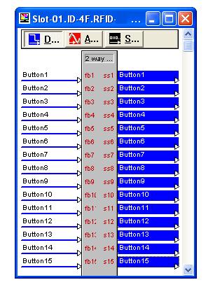

I just thought of another thing you need to do with the STX panel too, in Simpl there will be a "IN" and "Out" line (Feedback and Press) on it's Symbol. For now put the same signal name on both of them. IE: if your using Button1 to Button999 on the out's, put the same Button1 to Button999 on the in's too. That will create the loop it needs to show your button press's on the screen. Without any feedback input you can hit a button and it will work but the graphic under your finger will not move- that is the 2-way.

If the system is working and you have the buttons duplicated on both sides of the symbol you will see the button move under your finger on the TP. See the attached pix to confirm what I am talking about.
