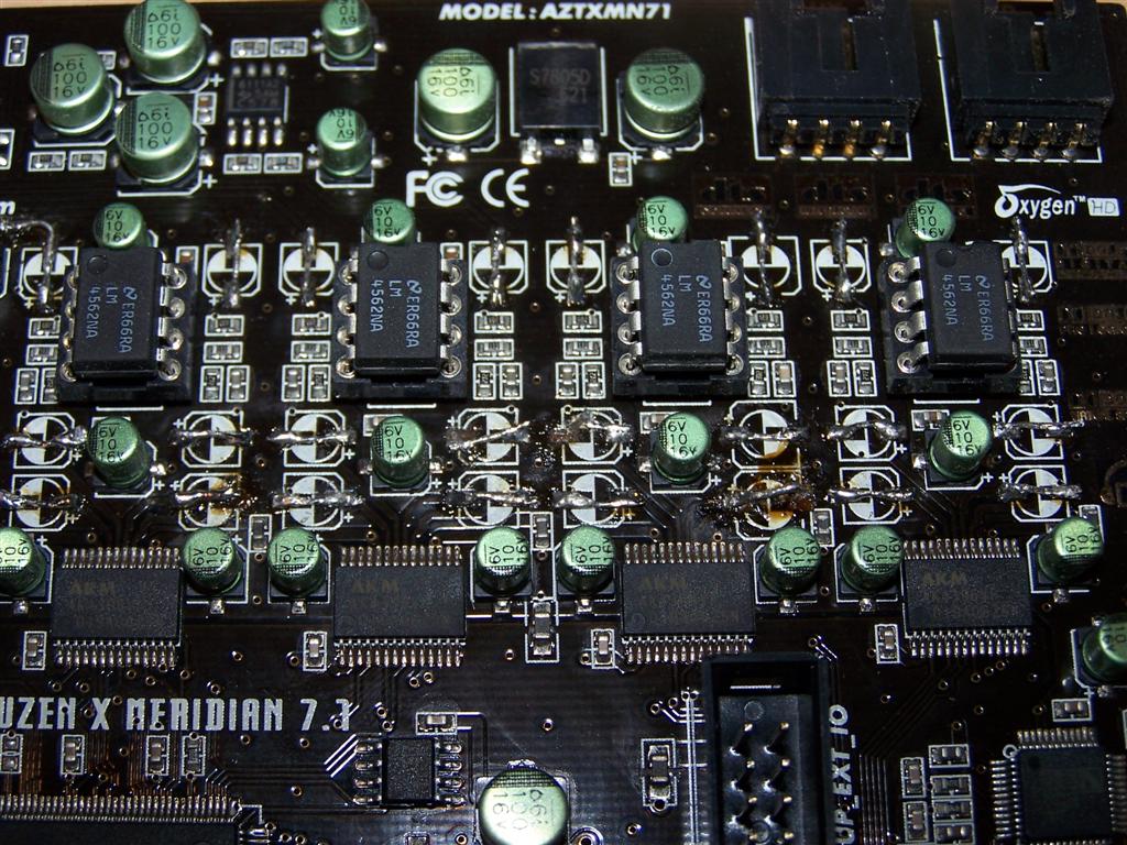

I installed LM4562's and removed the DC Blocking Caps, I will get some pics if you want. Sounds great. The Xmeridian is a sweet ass card, to bad they stopped production to replace it with that sh*tty Creative chipset.....Are you any good at soldering/de-soldering?? If can fix ya up!
The only problem with it is the high RMS voltage win windows is set at full volume, it goes will make any amp/pre-amp going into clipping...I know from experience, the voltage is alright for PC speaker systems because of their low sensitivity, but it destroyed three tweeters and crossovers on my brand new Ascends.....Do Not run the Windows volume any higher than 55, which will give approx. 2 vrms output on the xmeridian.

I will get some pics for you tomorrow, you just have to remove the DC blocking caps and jumper the pads. They are surface mount not too bad to do, I shake like a leaf and still no probs Thumbs Up
The worst part of the new card is it is Creative chumpset, and they only made one opamp replaceable, to get propar front channel imaging the audio chain needs to be identical. There is no point on replacing the L & R, without doing the center. I think Auzentech must have paid to many royalties to Creative, and couldn't afford the extra DIP sockets.
What kind of analog cables did you get? I had blue jeans make a custom set for me in 7.1, they turned out nice, and a great price to boot.

you remove DC blocking caps and short them out?
they must be in the signal path then. Does that leave any voltage potential on the output? cause that would be bad.

No, I forget the measurment that is allowed, maybe around 2mv VDC. They overprotected the card, with caps on the outputs. I belive you only need one per channel, but they had three, which in turn reduces the sound quality but saves lawsuits on there end. But all percaution must be taking to insure that there is not excessive DC voltage on the outputs, as it will instantley destroy speakers.
you don't short them, just jumper the pads to make connection to the output, I belive that they are in series.

Here are the pics of my modded card. If you do the cap bypass, be very careful it is hard to remove the SMD Capacitors withouth lifting the trace...as you can see I had to repair a couple Laughing

I just looked at the actual size of those cap's you removed. No way can I do it. I'm not steady enough. Too bad. I'll try the chip swap though that I can handle.
Had another thought. Could you swap in larger filter capacitors? Would it improve the sound?

I'll do it for you analog.
the parts I'm changing for Moome are 3 thousandths of an inch by 6 thousandths of an inch.
thats 0.003inches. that you are looking at there is 0.250inches.

There are mods as well for replacing the filter caps, but the opamps will make the largest difference. All in all I don't think the cap removal was worth the time. Same with swapping the other caps out. Someone I seen replaced them with Blackgate caps, in a super E config. I think he paid more for the Blackgate's, then what the X-meridian is even worth.
LM4562 is a great opamp, but it has been replaced with a LME series, but I can't remember the number. Best place to get them is digikey.ca.
