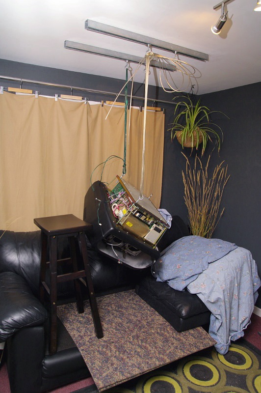

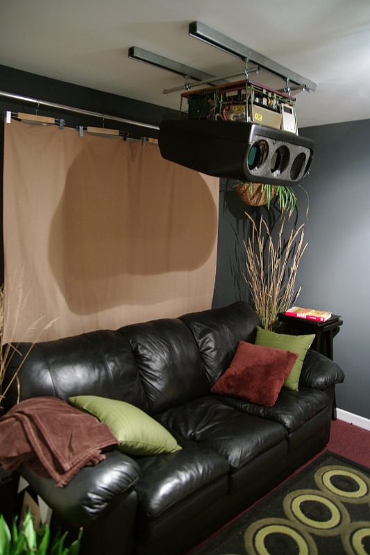

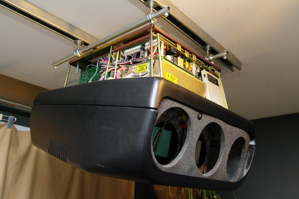

Well, the deed is done. The ECP is now ceiling mounted after a lot of tedious work from sourcing materials, cutting, drilling holes and finally hoisting into place. After cutting a single gash in the ceiling with a saw I found the exact location with two chicken/turkey skewers pushed up through the drywall to help find the joist. Nothing in this basement apartment is plumb or square. I measured from the wall to a joist in the bathroom behind water shut off valve hatch. One would think that same measurement would reflect off the living room wall, nope.. off by more than 1".
I tried to cut the washers at a hardware store with tin snips like suggested, no luck as they were too thick ~1/16" or slightly thicker. A vice and hack saw worked perfectly and they now fit the channel exactly, with probably about 1/32" movement. Thumbs Up
I may get shorter eye bolts to raise the projector about another inch higher as they bottom out in the ceiling now.
With a bit of 500 and 1000lb test clothes line kicking around, complicated trickery of hoisting each corner a few inches at a time and a bit of muscle everything went in place perfect. I tied up the back corner later on which made it al that much easier. I'm extremely pleased how it turned out. Tomorrow after work I may start the alignment and bolt it in place.

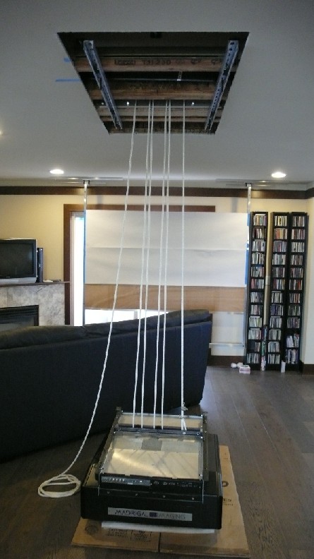

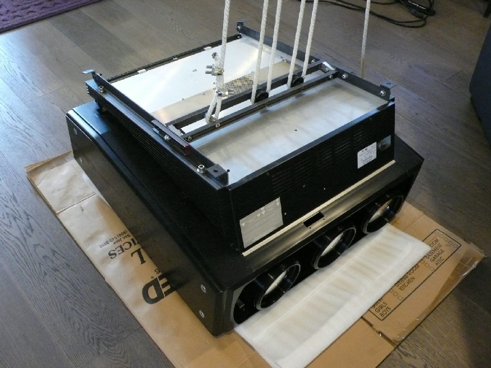

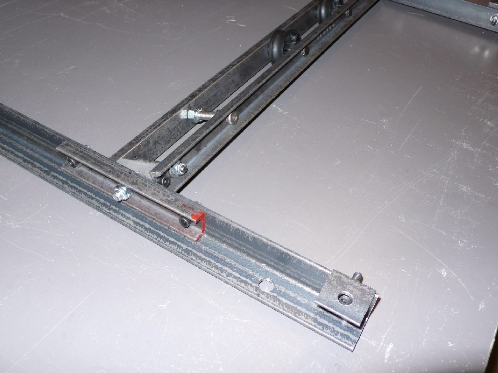

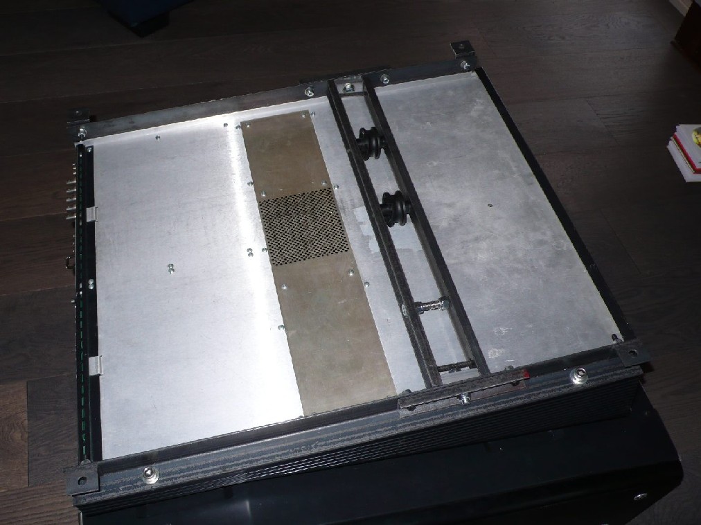

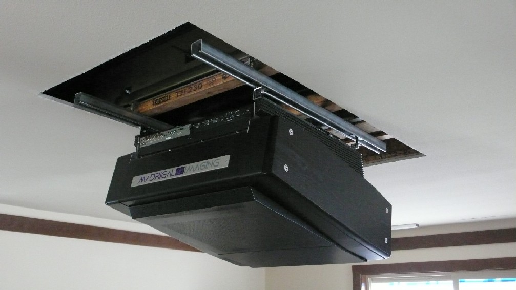

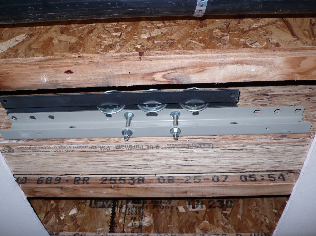

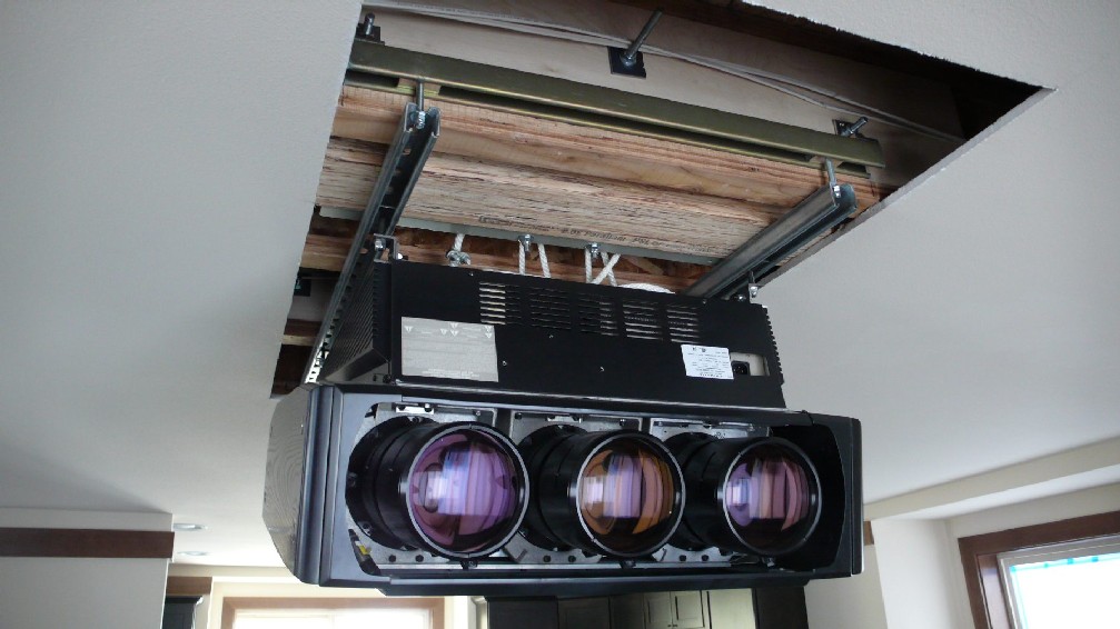

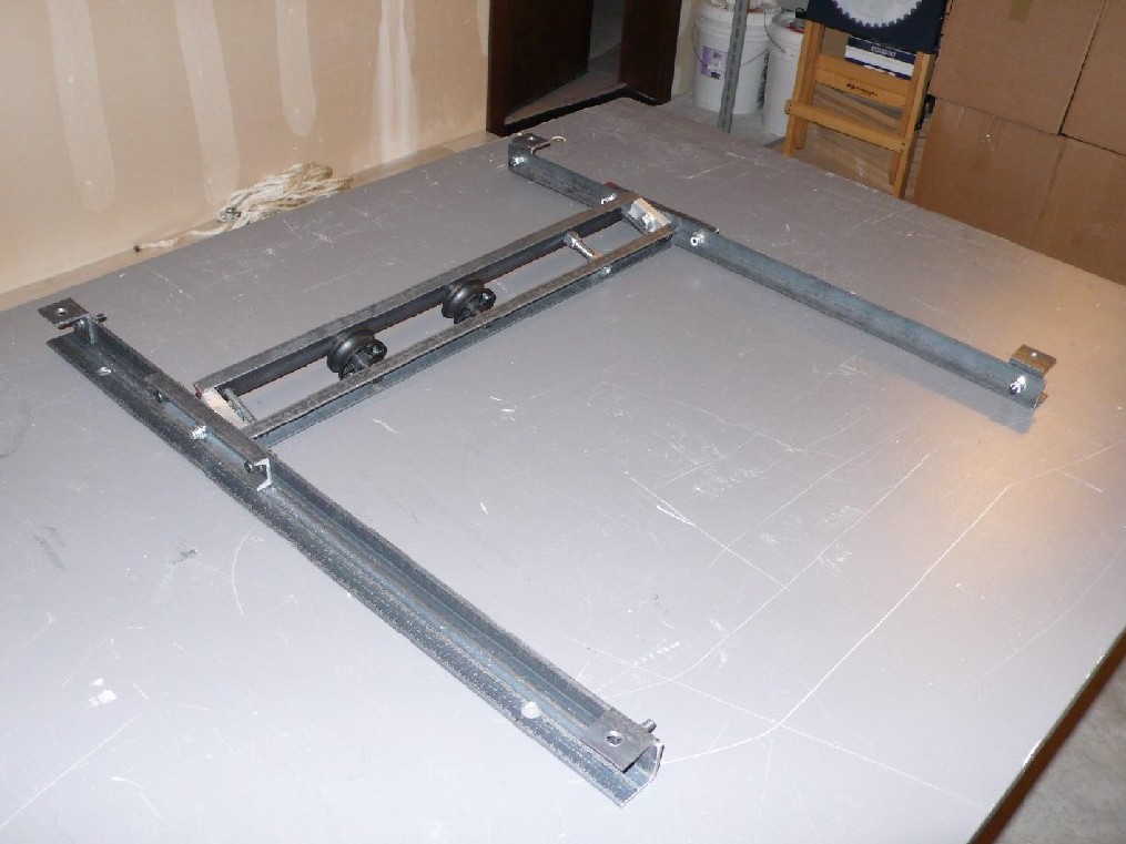

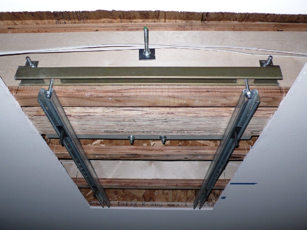

I built a custom pj bracket for my set with a pivoting pulley section. Had to go this way due to joist orientation. It's extremely strong and worked like a charm.
The ceiling mount is unistrut based, exceptionally heavy duty, full range of needed adjustment range, and tucked in fairly tight. The pulley section in the ceiling is a bit hill-billy, but still very strong, supported by (4) 6" lag bolts in sheer screwed into a large structural beam. I reinforced the supporting OSB i-beam joists by sandwiching them with 4'X8"X.75" 5-ply plywood. Supporting bolts go through reinforced joists with purchase spread over large square washers. Heavy duty brackets connect to strut. All bolts are captive. Cosmetic skirt to go up soon that will cover hole and all hardware.

I must say, that pulley system is impressively complex yet brilliant! I assume it made for hoisting a breeze for the most part? If the projector is to come down or a new one installed in place of I'll definitely have some type of pulley rigged in there next time as doing this alone was tedious.
The projector weighs about 240 lbs., so a 5:1 pully reduction makes for a ~50 lb. pull, so pretty easy, smooth and very strong and stable. It's still best done as a two-man event, although I have done it solo once, in which case you need a handy and very confident lash point.
