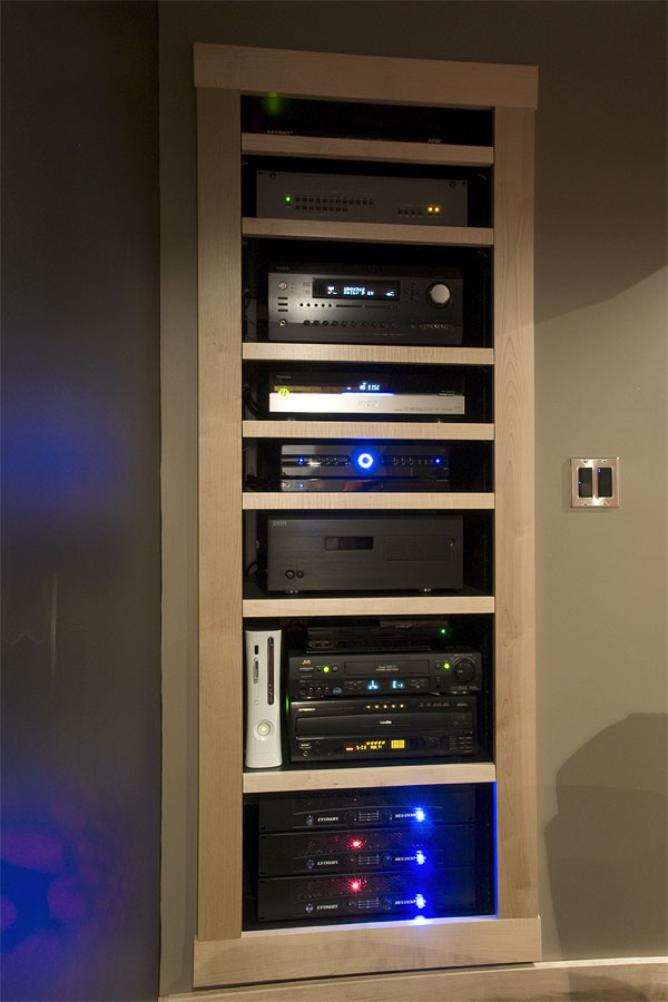

Finished front view:
I just need to fill the brad holes and tweak a couple of things. I'm thinking about selling off the HTPC case (which has never even had a computer in it) and taking it out of the rack, and putting the computer in a different room. The equipment is noise enough as it is, and I don't think I'll need physical access to it since I probably won't be using the optical drive for any playback.

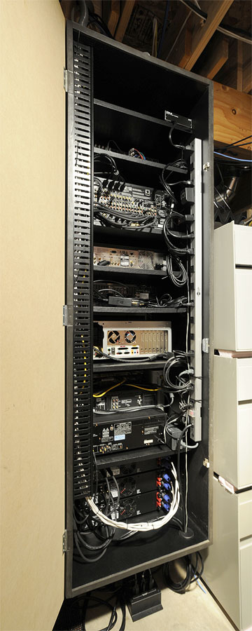

Back w/the door open:
Still a few things to do, but I'm pretty happy w/how it's looking so far.

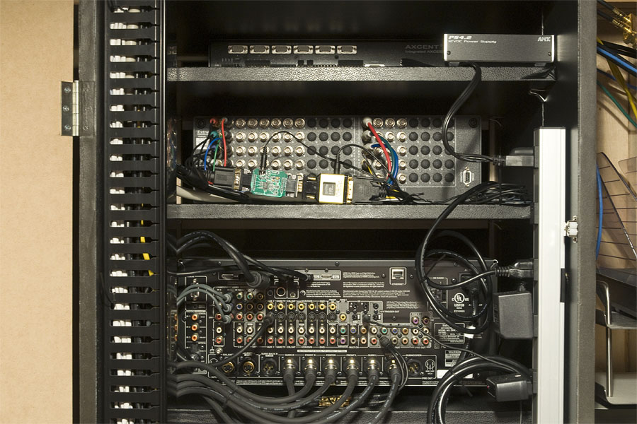

Closeup of the Integra prepro and Extron switcher with HD Fury and Kim's BUF2000:
AMX Axcent automation controller is on top. You can see it's not connected via serial or IR to anything, yet. That's because I'm still working on the GUI and programming. I'll wire it up when I'm ready to start testing code.

That is one sweet wire management setup Mr Crabb. Nicely done.
Ray
I am an iconoclast
Posted: Sun Nov 30, 2008 1:15 pm    Post subject:
Int eh "Back w/the door open:" picture you have three units of something (filing cabinets)? Are these storage for all of your DVDs?
Posted: Sun Nov 30, 2008 3:22 pm    Post subject:
Thanks, Ray!
Wan, I wish... I had to get rid of a Steelcase desk, but kept the drawers. They're leftovers. Nobody will buy those things (the commercial desks, I mean). I bought it the nice desk for $150 when a company I worked for bought new furniture. I had it 3 or 4 years and decided to get rid of it.
First I tried to sell it for $100, then $50, then I decided to just donate it... But, nobody would take it. So, then I put it on Craigslist for free. No takers for a month or so. So, I threw the desk and return in the dumpster and kept the drawer cabinets because they're really nice drawers. I'm going to put casters on them and use them in my work hole after the rest of the basement is finished.

greg_mitch
Posts: 5320
Posted: Sun Nov 30, 2008 5:04 pm    Post subject:
Is that some piece of metal contraption underneath holding up your rack?
Like I said before...very high quality installation SC.
Posted: Sun Nov 30, 2008 5:18 pm    Post subject:
Beautiful Steve. Nice cable management!
Posted: Sun Nov 30, 2008 6:48 pm    Post subject:
Thanks, guys! Greg, that's a Niles AC3 triggered outlet set on the floor. That makes the Crown amps turn on and off with the Integra prepro. I had to mod it to handle 3 amps, but it works perfectly!

Posted: Sun Nov 30, 2008 7:19 pm    Post subject:
Very clean! that rack back is almost as pretty as the front.
Are the components vented to the theater room or do you have some kind of venting at the rear?

Posted: Wed Dec 03, 2008 5:48 pm    Post subject:
SC, everything looks SUPER. It looks like a great Setup. But there's one bad spot...
In your rack, below the Denon receiver... there's this white vertical box.... it almost looks like ..... an xbox Shocked
Why would you have one of thos nasty things in a beautiful rack like that???....
A ps3 would look SMOKING in that space!! Then you could go online and race folks in Gran Turismo!!!!
That would be AWESOME
Thumbs Up Wink Thumbs Up
Super Setup Dude! Congrats!!!
Posted: Wed Dec 03, 2008 6:32 pm    Post subject:
Thanks, John!!!!
Heh heh... I HAVE a PS3 - it's hiding in that same space - right on top of the VCR. You can just barely see it.
The PS3 is my BD player, so I use it constantly. I'm going to take the LD player out and get rid of it so I can drop the PS3 down - it's a little tough to find the slot to get the disk in and out and I can't see the buttons at all. The 360 is there almost exclusively for Halo 3. I have a couple of friends I get together with and we play every once in a blue moon. Halo 3 on the 360 and Gran Turismo are about the only two games I play on the rare occasions I get the chance (or take the opportunity) to play. For me it's like... "OK, kids are in bed, it's 10pm, wife doesn't want to watch a movie (a rare occurrence)... What do I do? Play a game or watch a movie?" Usually, I watch a movie.
Games are definitely awesome, though. Gran Turismo is pretty amazing. Running the 'ring in a Z06... It's about as close to the real thing as I'll probably every get. I need to pick up some 1" square tube aluminum and weld up some sort of a steering wheel/pedal frame that clamps onto my chair or something. My seating distance makes it REALLY immersive. I love it - just wish I had more time to play (drive).
I do need to get a black faceplate for the 360 so it isn't such a "turd in a punchbowl". Wink
Posted: Wed Dec 03, 2008 6:55 pm    Post subject:
Ooops. Forgot to respond to you, Jask. No, the back of the rack is entirely closed - even gasketed. The only penetrations into the room are the HVAC supplies and return, door, and electrical boxes. In hindsight, I wish I had designed the rack with a door because the noise is obnoxious to me. The amps I can quiet down with a fan mod - I just haven't done it because I wasn't certain I was going to keep them. I am now - I just need to make them quiet. The PS3 is relatively quiet, though it does pump out some serious heat - much more than anything else in the rack.
My next task is working on ventilation and if I have to, possibly enclosing the front of the rack somehow. My to-do list looks something like this:
- Do Crown amp fan mods to slow fans. The mod will slow them considerably to barely audible, but a temp switch will kick them in to normal voltage.
- Add a good sized 110VAC muffin fan to the top of the rack to carry out heat that collects at the top of the rack. I'll probably try to build it into some sort of jogged muffler arrangement so as not to completely trash what isolation I do have.
- Build final hush box. I built a prototype out of foam core for the meet, but the velcro wouldn't hold very well and it was hanging funny, so I had to take it down. It looked really nice, though while it was up - it was covered in black fleece material. It served as a good prototype, though - I know how I'm going to build the final one - I just have to figure out the best material.
