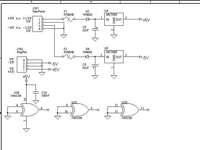

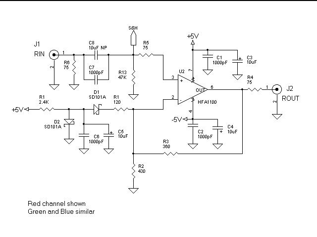

Here are all the files I can add as an attachment here...

In the “Video” circuit, I renamed (in red) the duplicate “R1” to “R7”:
VID_R R1 2.4K
VID_R R7* 120
VID_R R2 430
VID_R R3 360
VID_R R4 75
VID_R R5 75
VID_R R6 75
VID_R R13 47K
VID_R C1 1000pF
VID_R C2 1000pF
VID_R C3 10uF
VID_R C4 10uF
VID_R C5 10uF
VID_R C6 1000pF
VID_R C7 1000pF
VID_R C8 10uF NP
VID_R D1 SD101A
VID_R D2 SD101A
VID_R U2 HFA1100
VID_G R1 2.4K
VID_G R7* 120
VID_G R2 430
VID_G R3 360
VID_G R4 75
VID_G R5 75
VID_G R6 75
VID_G R13 47K
VID_G C1 1000pF
VID_G C2 1000pF
VID_G C3 10uF
VID_G C4 10uF
VID_G C5 10uF
VID_G C6 1000pF
VID_G C7 1000pF
VID_G C8 10uF NP
VID_G D1 SD101A
VID_G D2 SD101A
VID_G U2 HFA1100
VID_B R1 2.4K
VID_B R7* 120
VID_B R2 430
VID_B R3 360
VID_B R4 75
VID_B R5 75
VID_B R6 75
VID_B R13 47K
VID_B C1 1000pF
VID_B C2 1000pF
VID_B C3 10uF
VID_B C4 10uF
VID_B C5 10uF
VID_B C6 1000pF
VID_B C7 1000pF
VID_B C8 10uF NP
VID_B D1 SD101A
VID_B D2 SD101A
VID_B U2 HFA1100

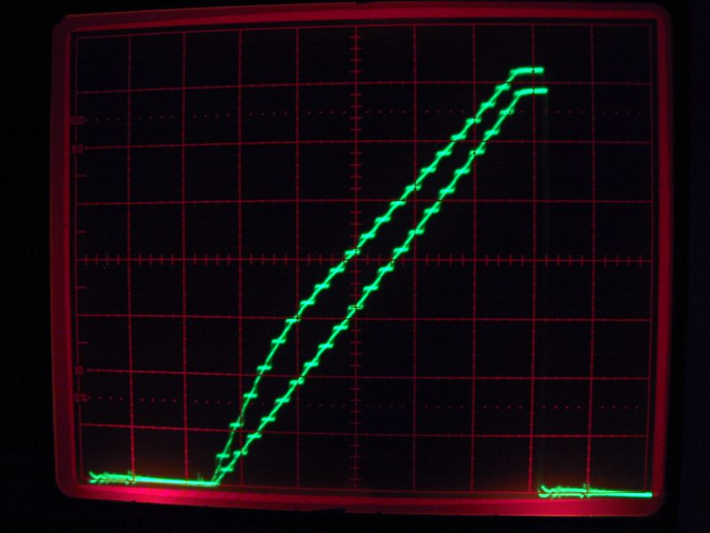

 Filesize:  47.23 KB
 Viewed:  14644 Time(s)

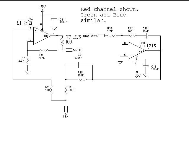

 Filesize:  29.61 KB
 Viewed:  14697 Time(s)
 Filesize:  27.48 KB

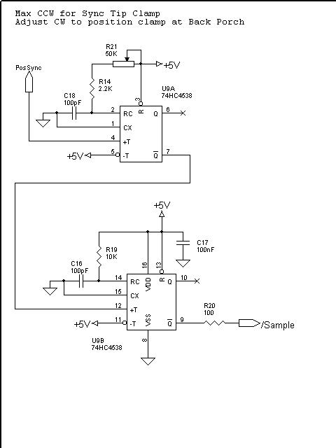

 Filesize:  28.63 KB

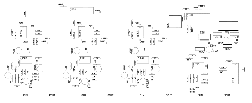

 Filesize:  32.17 KB

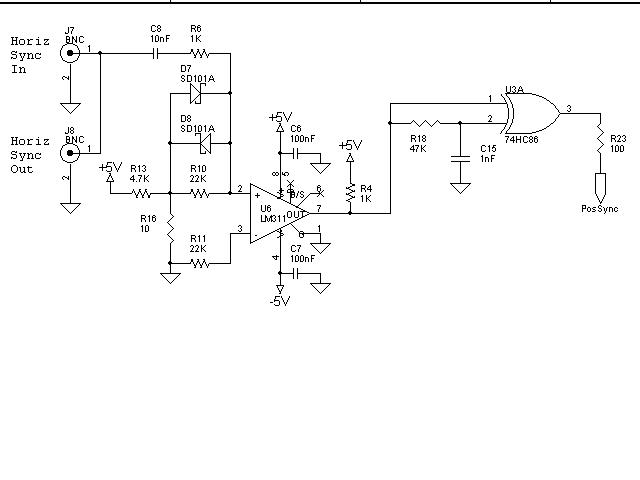

 Filesize:  27.06 KB

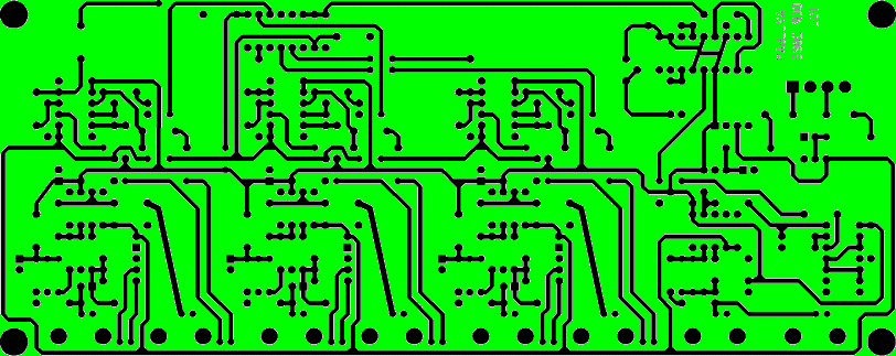

Scott could you attach the gerber files for the pcb ? Wink

Hey guys, I'm just following the circuit to see what Scott has done there. Is it complete? Where does /Sample go? What about RED and RED_SW? Seems like something is missing. Thanks.
Cary
