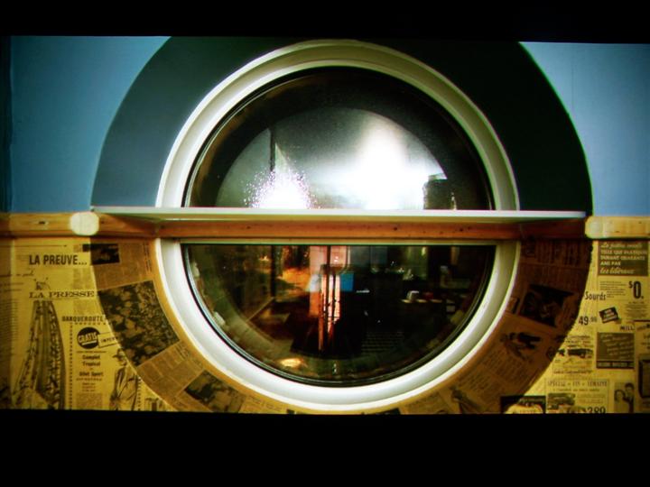

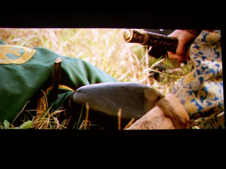

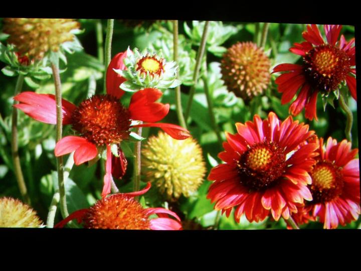

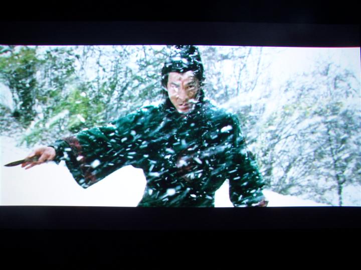

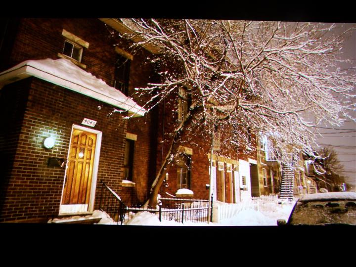

I didn't want this to turn into a G70 vs. Marquee debate, I have never seen or used a Marquee, but I am sure the G70 and Marquees both have there strengths and weaknesses.
I love the picture of my G70, and If I could move the projector back some, I am sure it would greatly reduce my geometry problem, but do to the fact of the size of my room, and the short throw of the 8500, is the only reason I am considering a change.
Here are some Screenshots from the G70, to show how good the picture is Very Happy

Very Nice,
I wish I could get my screenshots to come out like that.

I was shocked that they turned out that well also. I have a kodak 5 MP, used a tripod and the Firework scene mode.
