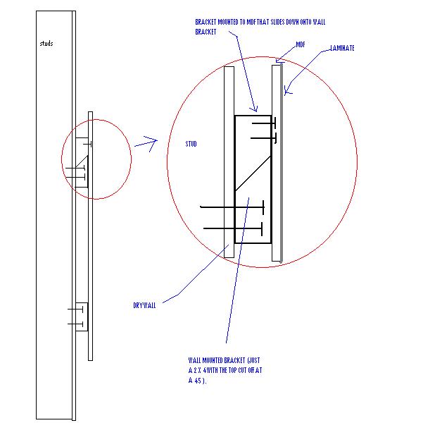

Wow, what an ordeal! Sorry, it hasn't gone well. Hopefully your latest attempt will work well enough. I wanted to do the wilsonart screen as well, but I need a pull down. I'm too cheap for the motorized screen, but I was thinking (still just thinking at this point) that this screen would do it for me...
http://www.eastporters.com/estore/cart.php?target=product&product_id=111&category_id=33 Much cheaper.
Yes it's 4:3 format, but at 120" diagonal if I want 16:9, I just don't pull it down as far. Then I'll just have a piece of blackout material I can stretch across for the top border (or use a couple velcro tabs to hold it up). If I want 4:3 format, then I get a really big screen.
I did have a thought... Could you screw a 1/2" thick sheet of MDF to the wall, then use contact cement to put the laminate on?
OR...
screw a 2 x 4 horizontally to the wall where the bottom of the screen will be (to keep the screen perfectly verticle). Then do the same at the top but cut a 45 degree into it to create a hook. The picture should explain a little more clearly. I've seen commercial cabinets installed this way. That way you bond the laminate to the MDF while it's on the floor, then get a friend to help you hook it into place.
Just an idea in case your latest attempt fails. My way would cost almost nothing to do. Just MDF and 2X4's. Hopefully your laminate will survive if you remove it again.

I doubt this laminate will survive anything else. It is glued on at this point.
I need multiple panels of MDF for my screen size, at least as I can find it around here. I've seen people talk about larger, but I haven't seen it yet.
If I had to do it again, I would use 1/2" mdf with a 2x4 frame, basically the design posted earlier by crabby:
I don't know if I want to do it again with laminate, though. Next one will be made with commercial screen material, I think. This sheet of laminate has a small flaw, a manufacturing defect of some sort, about 6" down from the top and nearly dead center horizontally. I didn't see it until after the fist cut, and HD wouldn't take it back. I can live with it for now, it is only about 1mm by .5mm, just a little dark spot, but I will want to replace the whole screen eventually.

I didn't go into detail in my earlier post, but what you just described at the top is exactly the method I used. It's called a "French cleat". The method works beautifully for any larger or heavier objects - and worked perfectly for my huge and HEAVY screen assembly.
