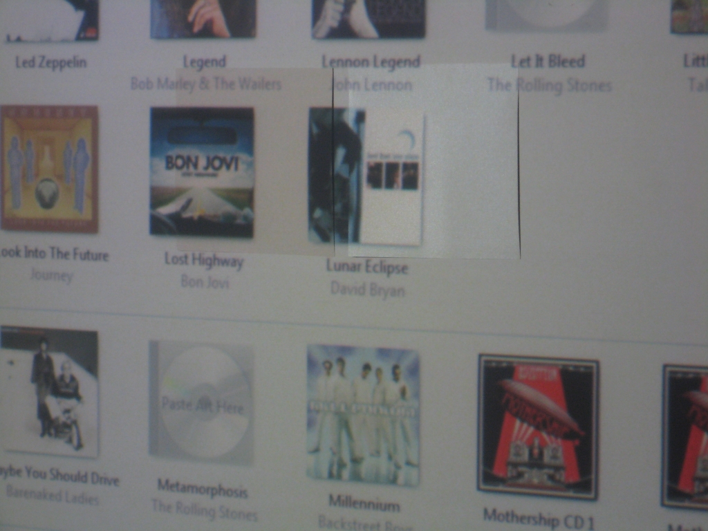

I think this is a neat comparison as well, High Power is on the left and Video Spectra 1.5 is on the right.
With the camera centered on the screen at proper eyelevel for the high power the HP is much brighter

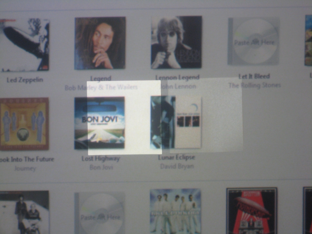

Posted: Fri Nov 28, 2008 11:46 pm    Post subject:
But when the camera is on the side of the screen ~4' off center the 1.5 gain Video Spectra is brighter. This really goes to show how quickly the HP gain drops off.

Posted: Fri Nov 28, 2008 11:51 pm    Post subject:
That is interesting....What angle would you think you were at on the second image?
Mike
Posted: Sat Nov 29, 2008 12:05 am    Post subject:
MikeEby wrote:
Mike
I know I was outside of the 30 degree viewing cone of the HP, I'd guess about ~35 degrees off center.

Posted: Sat Nov 29, 2008 4:50 am    Post subject:
> I know I was outside of the 30 degree viewing cone of the HP, I'd guess about ~35 degrees off center. <
Interesting guesstimate. You must have moved in closer than your initial "The seats are about 15' from an 8' wide screen" then, because 4' off axis at 15' would only be 15-deg. For 35-deg, you'd have to go to 10.5'.
- Tim
Posted: Sat Nov 29, 2008 5:34 am    Post subject:
Yes I did move closer, sorry for leaving that out.

Posted: Sat Nov 29, 2008 6:06 am    Post subject:
That's OK, Erik. Just give us all the facts. Smile
~35 deg off-center implies you moved in to a little under 6 feet. Does that sound about right?
Interestingly, that VideoSpectra piece seemed to maintain its gain pretty well.
- Tim
Posted: Sat Nov 29, 2008 7:20 am    Post subject:
That sounds about right. Yes the video spectra maintained gain very well with a wide viewing cone.

Posted: Sun Nov 30, 2008 10:07 pm    Post subject:
> [iI know I was outside of the 30 degree viewing cone of the HP, I'd guess about ~35 degrees off center.[/i] <
Just a quick comment... the HP isn't designed for that far off-axis viewing. It's below unity-gain at that point, which you can see in comparison with the paint.
However, if you'd been 4' off axis at your original 15' viewing position (instead of moving in close to <6' from the screen), that would only be ~15-deg, and you'd still have some gain.
> Yes the video spectra maintained gain very well with a wide viewing cone. <
I've never seen one, but wonder why they're not more popular with CRTers. Their specs would indicate a good set of design parameters.
- Tim
