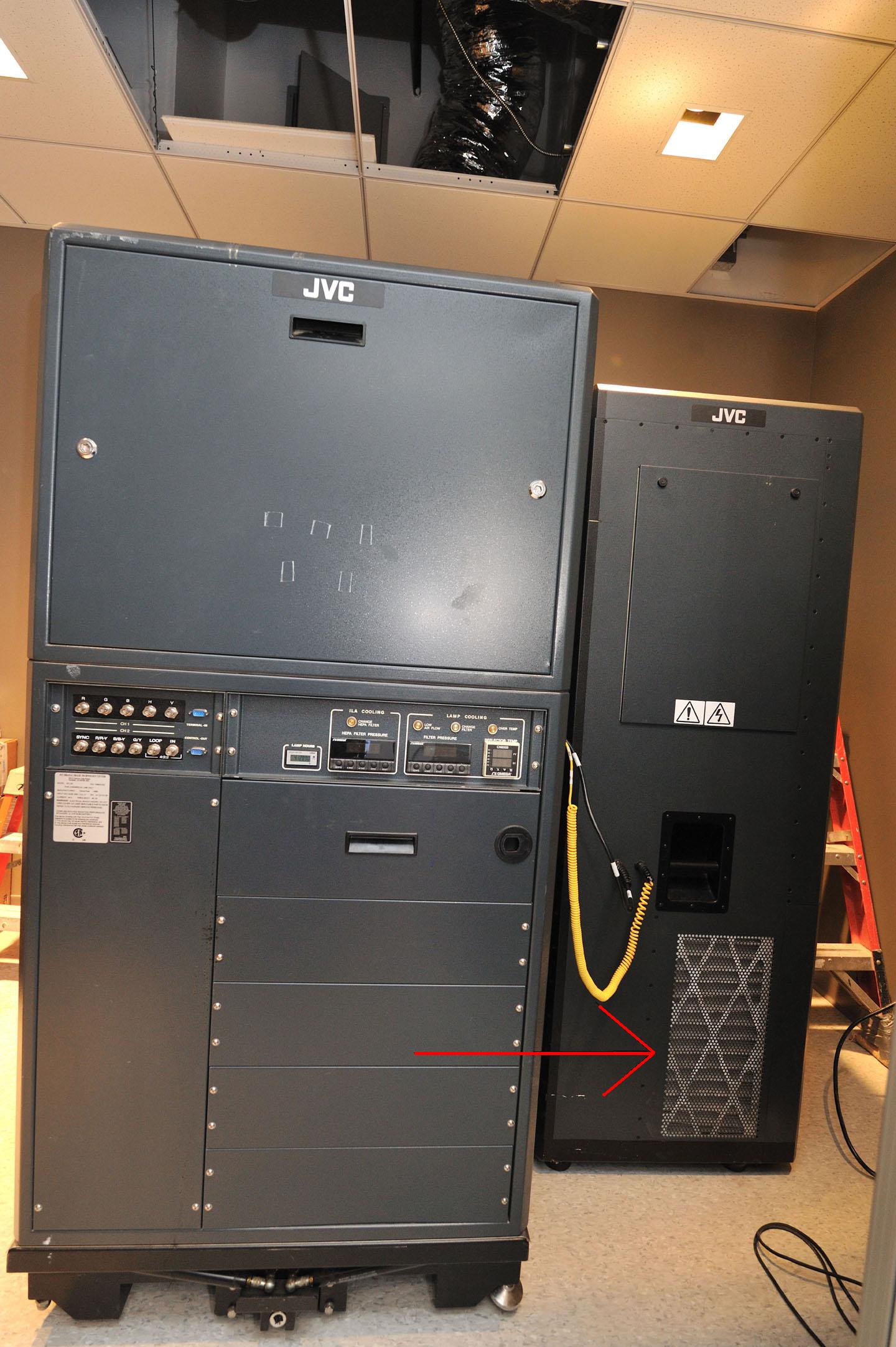

Hello Chip,
Fortunately, in this case (no pun intended) the manufacturer thought ahead, and included filtered blowers to pressurize the assemblies. One of the filters is visible in the picture I had previously posted, and the main cabinet has several more. The manual offers two different methods for pulling the heat from the projector: either direct (passive) 10" duct connection to the top of the lamp cabinet, or suspending a hood 2.5 inches above the cabinet connected to an in-line blower. The later (recommended method) is what I went with.
To equalize the air pressures, the waste heat blower is offset with an equal amount of makeup air. This is separate and distinct from the booth air handler which has it's own balanced supply and return ducts.
 Filename:  filter.JPG
 Filesize:  336.33 KB
 Downloaded:  454 Time(s)
12K Install.pdf
See page 3-4 and 3-5
 Filename:  12K Install.pdf
 Filesize:  96.34 KB
 Downloaded:  525 Time(s)
Posted: Wed Jun 02, 2010 10:19 am    Post subject:
The "indirect coupling" is basically what I was saying but instead of putting a "hood" over the projector, hard connect directly to the projector, dump it directly into the theater and make the theater ceiling the "hood". From there the HVAC returns can pick it up and distribute it. The other half of the thought was to grab the projectors supply air from low in the theater where it's the coolest. Filter it and pump it up to the base of the projector. Wire the inducer fan to come on with the projector. As the projector warms up, it will also begin to convect adding to the total airflow through the projector.
As long as the inducer is on the supply side, there won't be any dust problems within the projector.
Keep an eye on those pleated filters. They plug up fast.

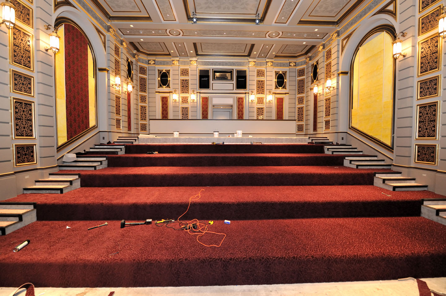

Day 2 of the carpet installation. It looks like the job may take four or five days to complete after all. Things MUST be done by Saturday as the seat installation starts Monday.
Still waiting to hear when the wall panels can be finished... Confused

Just looked at the picture of the carpet installation. This place could pass as a shrine. Thumbs Up

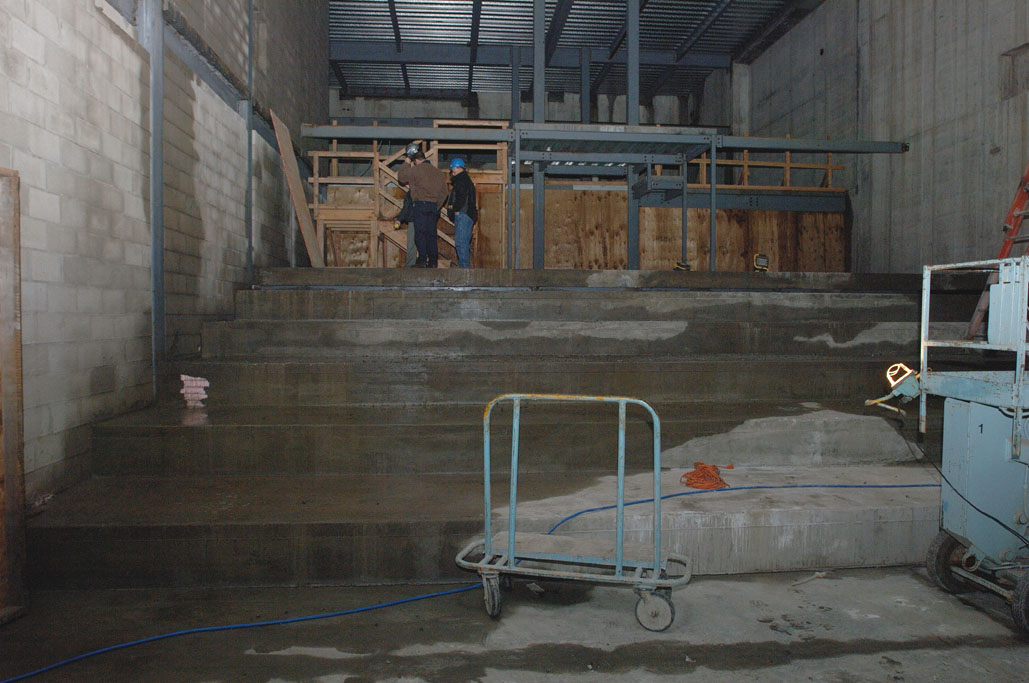

From this............

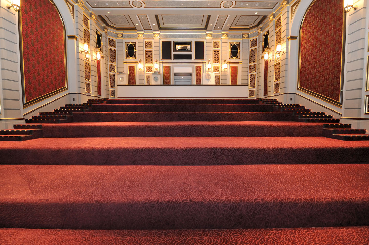

The theater in "Live Speaker" (fund raising) mode.

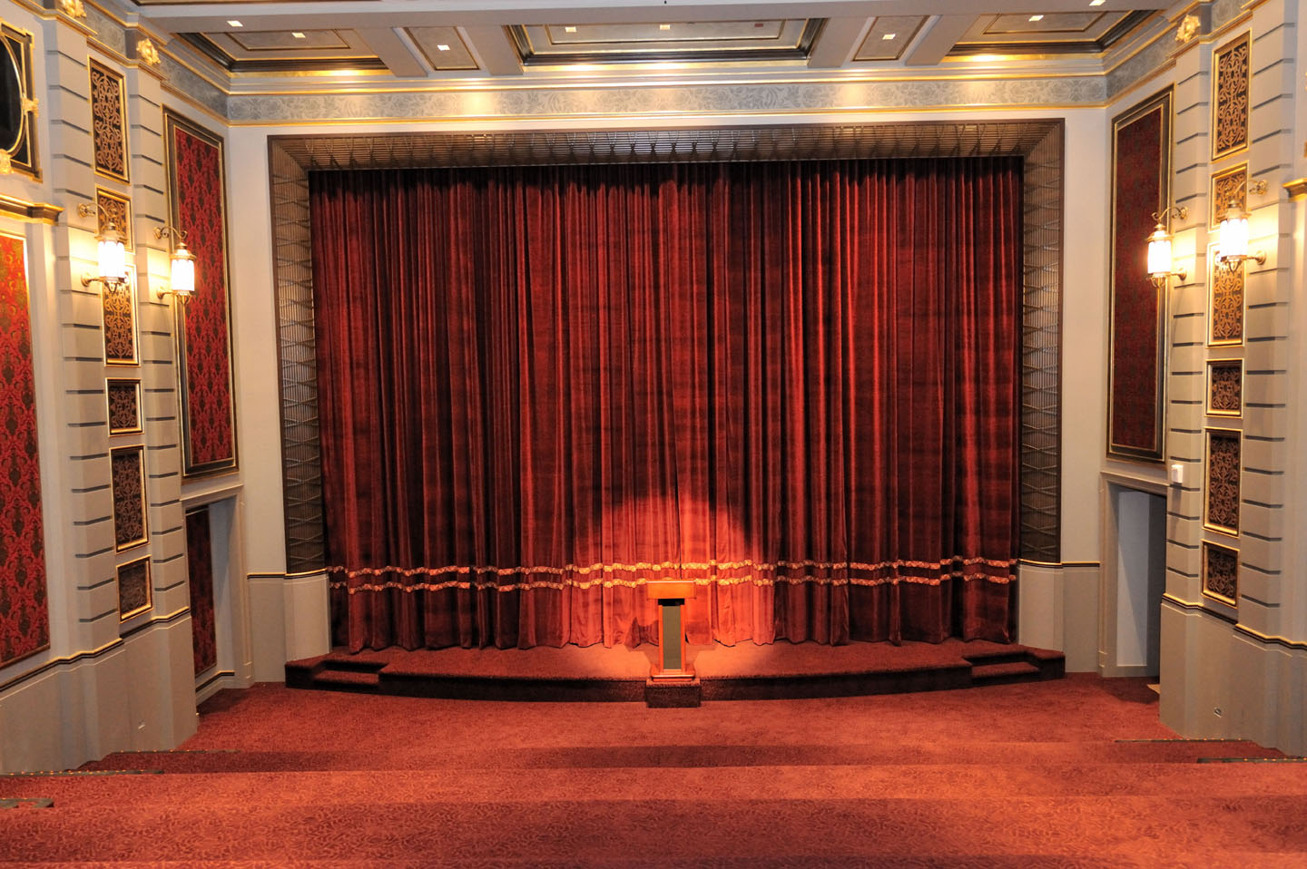

The view from the speaker's [podium)] position. The theater doors are leaning against the back wall awaiting the removal of about an inch from the bottom edge to clear the carpet height.

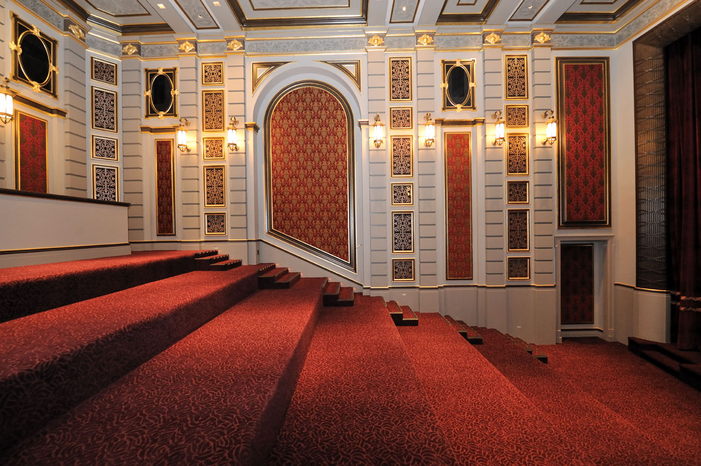

The completed theater side wall
