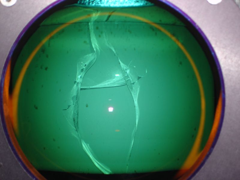

Ouch. That's the first time I've ever seen a face failure on a Panasonic P19 tube.
The pressure must have been remarkable. I'm surprised the chamber didn't just
pop before it got to that level. But silicone rubber is strong stuff.
Incidentally, the glycol in the other tubes (blue for certain) is also cloudy and needs
to be replaced.
But given the condition of the red and blue tubes, I'd say it's worth it to spring
for a new green tube.
CJ

Not so rare. Brings back bad memories
 Filesize:  51.97 KB
 Viewed:  6083 Time(s)
Posted: Fri Aug 31, 2007 4:10 am    Post subject:
Wow cracked in an 'H' shape.
I remember your post about that. That's an expensive 'H'
Posted: Sun Sep 02, 2007 12:20 am    Post subject:
Hello
We are curious, were the red and blue bellows hard (pressurized) or mushy (OK)?
I have seen two cracked greens in the last three years; I think it was glycol pressure, others think it had to be beam damage or flawed glass, any comments guys?
