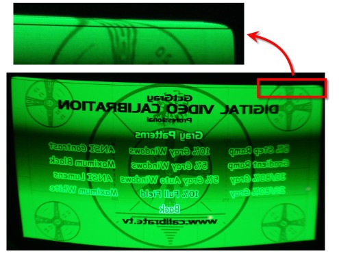

Posted: Mon Jul 16, 2007 12:47 am    Post subject:
Darn newbies, don't know their way around their new projector and ask all kindsa dumb questions. Smile Thanks for the help, John.
So, back to the flash: at this point it appears it only happens in a no-signal condition or with test patterns on the screen. Beats me what's causing it, but as long as it doesn't happen when I have real content on the screen, it won't bother me any.
As long as I've already got this "dumb newbie" thread started, I guess I might as well continue asking questions here...
* I have a dark line along the top of the raster. At first I assumed this was the ABG line, since it seems to appear in the same place as the ABG line. (Is the ABG line supposed to appear inside the active picture area!??) But I turned ABG off and the dark line is still there. There's also some distortion happening above the line, and the raster is rounded in the top left & right corners -- see the attached enlargement of the top-right corner of the raster, looking at the tube. If I have to, I can cut off the top with blanking and probably never miss it, but I'd like to fix it if I can. Any guesses?
* I was thinking the G70 had magnetic centering adjustments. I wanted to do a full reset on the beastie and then, with the centering controls reset to factory defaults, center the rasters with the magnetics. But now I can't find the magnetic adjustments. Am I missing something, or does the G70 have ONLY electronic menu-driven raster centering?

Posted: Mon Jul 16, 2007 6:25 am    Post subject:
I can answer a few of these:
1. The line of the top of the raster is caused by misadjusted RGB size/dot phase controls (center top on the remote). Play with these and you'll get rid of the line.
2. The focusing controls are all electronic, with the exception of the dot shape (circle) which is controlled by the mangets on the tube neck. Use the 2PA/2PV adjustments to adjust centering.

Posted: Mon Jul 16, 2007 12:47 pm    Post subject:
I forgot you were a newbie. I would have suggested to check your input settings had I remembered. Anyone that's owned a G70 has experienced that problem at one time or another.
I've always used "Shift" to fix that problem. "Center" adjustments will not help.

Posted: Thu Jul 19, 2007 4:01 am    Post subject:
OK, finally got a chance to fool with it a bit more. Sure enough, SHIFT sorted the mystery line right out. Now I have the image centered in the raster better.

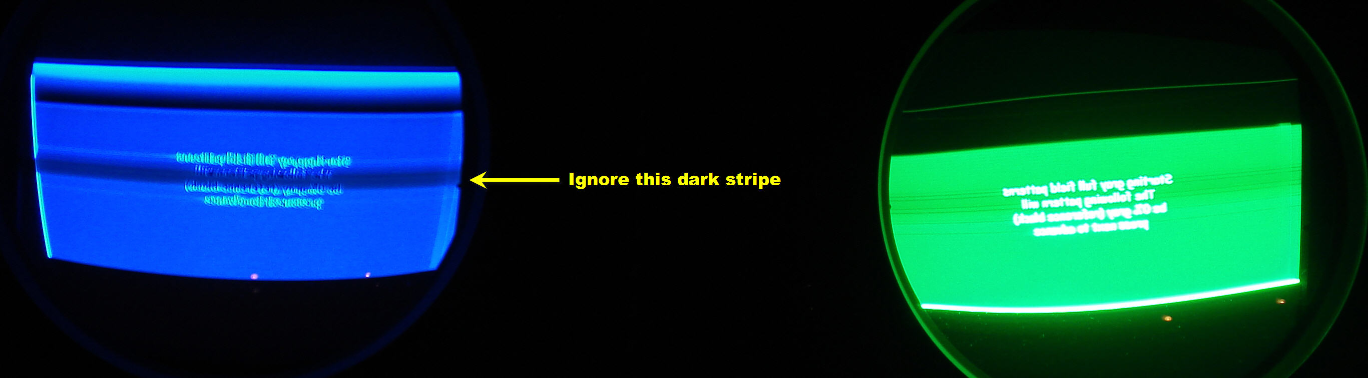

Posted: Sat Jul 21, 2007 5:34 pm    Post subject:
OK, I'm doing a rough setup on the floor. I'm trying to converge it with a minimum of ZONE. So far I haven't used ZONE at all, and ZONE is all reset.
I'm having a bit of trouble with the green horizontal linearity. It seems to compress a bit at the edges -- see pic for an approximation. I can line the red up perfectly with the green in the middle 3/4 of the screen, but the outside few green lines seem to have non-linear spacing. (Only the green does this. Blue and red are reasonably linear. Well, I haven't measured yet, but blue and red are the same.) If I set the red SIZE to match the outside lines, then the middle ones are off.
XG's have a "linearity balance" control that lets you adjust stuff like this. I see pin balance and key balance, but I don't see anything like a lin balance. Do I just have to use ZONE on this?

AFryia
Posts: 965
Posted: Sat Jul 21, 2007 9:31 pm    Post subject:
I believe the last four zones in zone control will kinda adjust the linearity left to right.
Unlike the other zones these only adjust left/right (horizontal) from top to bottom of the screen.

Posted: Sun Jul 22, 2007 3:25 pm    Post subject:
Hm, I see what you mean. The manual doesn't say anything about it, but those four zones have only horizontal movement, and they seem to control top-to-bottom.
It's still not really enough. I've got zones 22/25 maxed out and I still can't get it quite right. With a lot of juggling between size/lin and those zones I got it close, but not right, and it was not easy. It's like I can get all the zones right except the far left and right edges, and red on the edges sticks way out beyond where it should. I need another "top-to-bottom" zone like 22/25, but on the edge of the screen.
Is this common? Is there just some trick to converging this thing that I'm not getting, or is there something wrong with my projector's geometry?
AFryia
Posts: 965
Posted: Sun Jul 22, 2007 4:07 pm    Post subject:
If your graphic is a fair representation I would adjust GREEN SIZE to match RED, along the perimeter.
Then zone at the 1/4 and 3/4 horizontal position.
General rule of thumb is to work all other controls (SIZE,LIN, PIN,etc.) before using zone. Use zone sparingly as possible.
All zone adjustments should be set to 128 (neutral) before stating any convergence.
Posted: Sun Jul 22, 2007 4:33 pm    Post subject:
Yup, I did set everything to 128 before starting. Several times. Smile
Adjust G size to match R? But doesn't G always control all 3 colors? Obviously I could adjust R to match G, but just curious if I'm missing something.
I tried doing that, but still had an awful time getting things to line up. E.g. I just tried resetting to 128, then adjusting R size to line up with G at the left & right edges. (See A below.) Next I tried working with zones 22 & 23, the two "super-zones" on the left side. I could line up 23 just by reducing it to 60 or so. But in zone 22, even when I took it all the way to MIN the R is still to the right of G. Worse, moving zone 22 to the left also moved the left edge to the left (see B) -- which means now I'd have to reduce red SIZE to get the edge to line up with G, which will make zone 22 even further off!
I can also work with the Green ZONE settings to get R & G to come together, but I still have the same problem shown in B -- moving the G zone 22 to the right moves the G left edge to the right.
What am I doing wrong??
