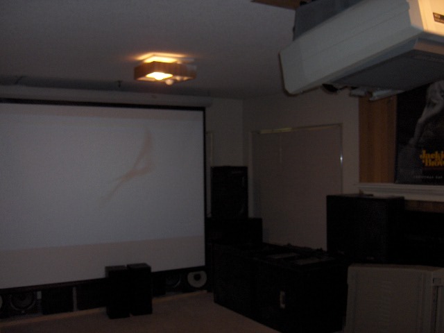

Room shot showing the 9500 and screen.

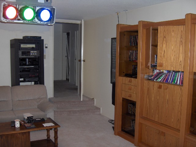

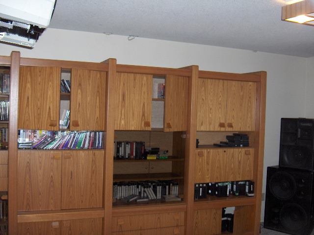

Left side wall. The teak wall unit is 11' long down that side of the room.

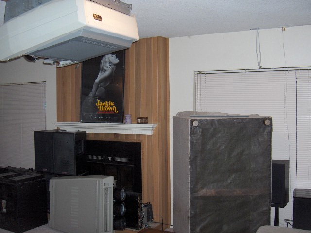

Right wall. Fireplace to the left, sliding door with cheap blinds to the right.

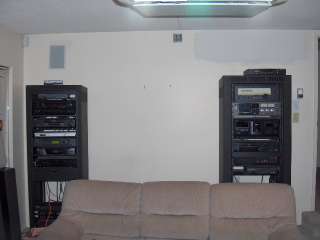

The back wall. HT rack to the left, multiroom system rack to the right.

Entering the room, you go down 2 steps. To the left of the pix are two 19" racks. The one closest to the door holds the 12 zone multiroom system.

I did step one last night: Removed the Community speakers, installed the 3 X 12 Tannoy cabinet and hooked up the 3 LCR EAW cabinets. There was a massive improvement in dialouge, the bass seems a bit punchier as well. I was only driving the cabinet with 150 watts RMS, today I'll hang the tensioned screen and will bridge the sub amp to put 300 watts into it..Smile (the sub can handle 1000 W RMS.)
