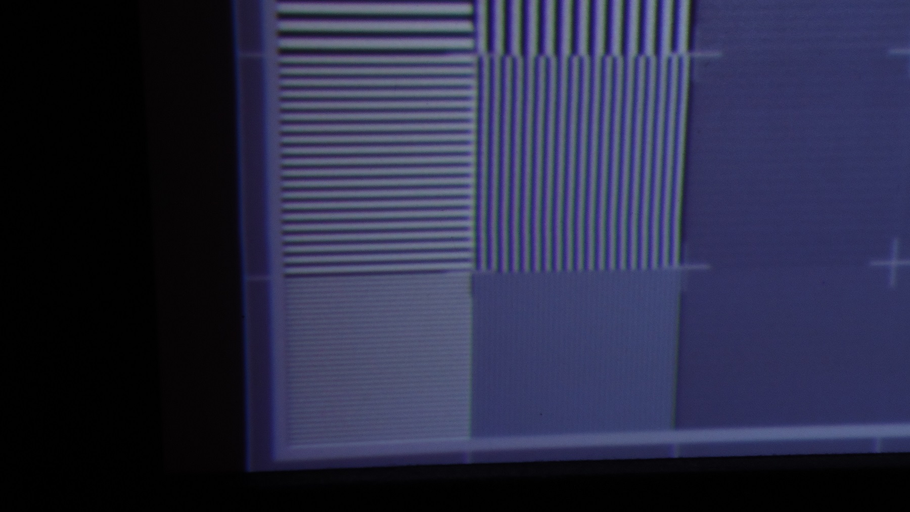

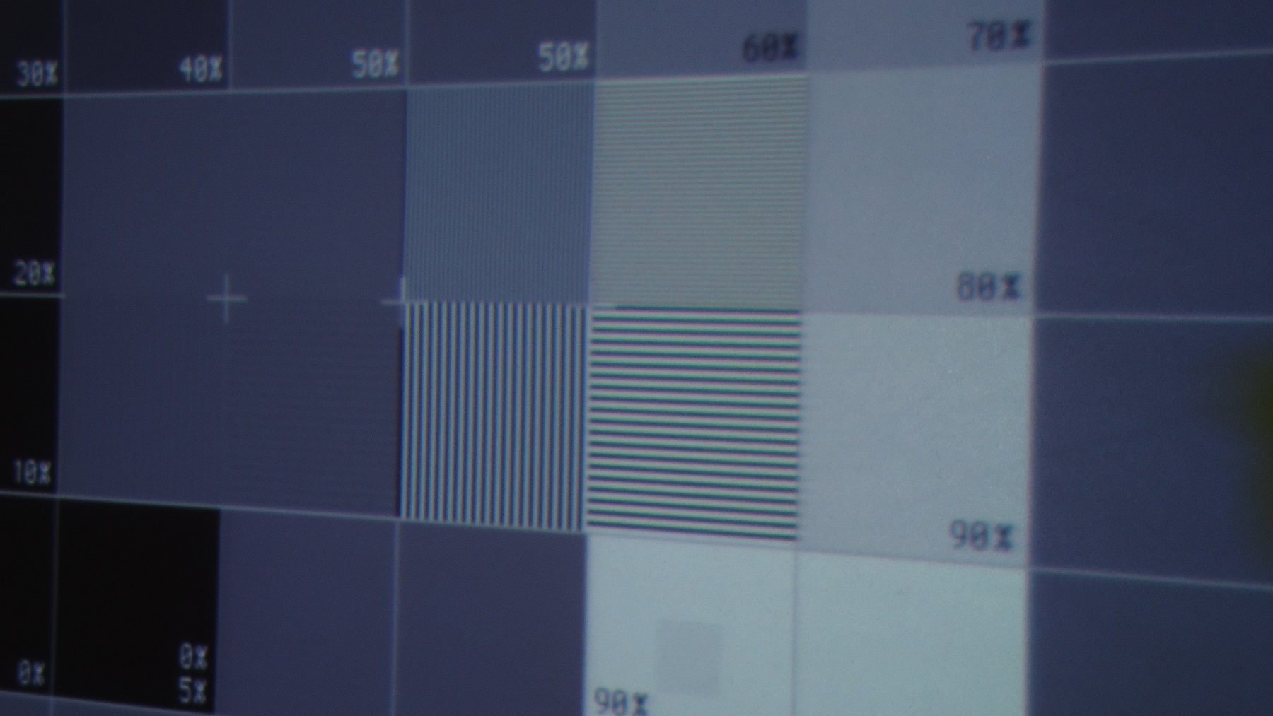

Posted: Wed Jun 03, 2015 10:02 am    Post subject:
What happens after a more precise filtering and tuning on a test neck board.
An almost perfect (no peaking, smearing, streaking, banding) SMPTE - 1080P

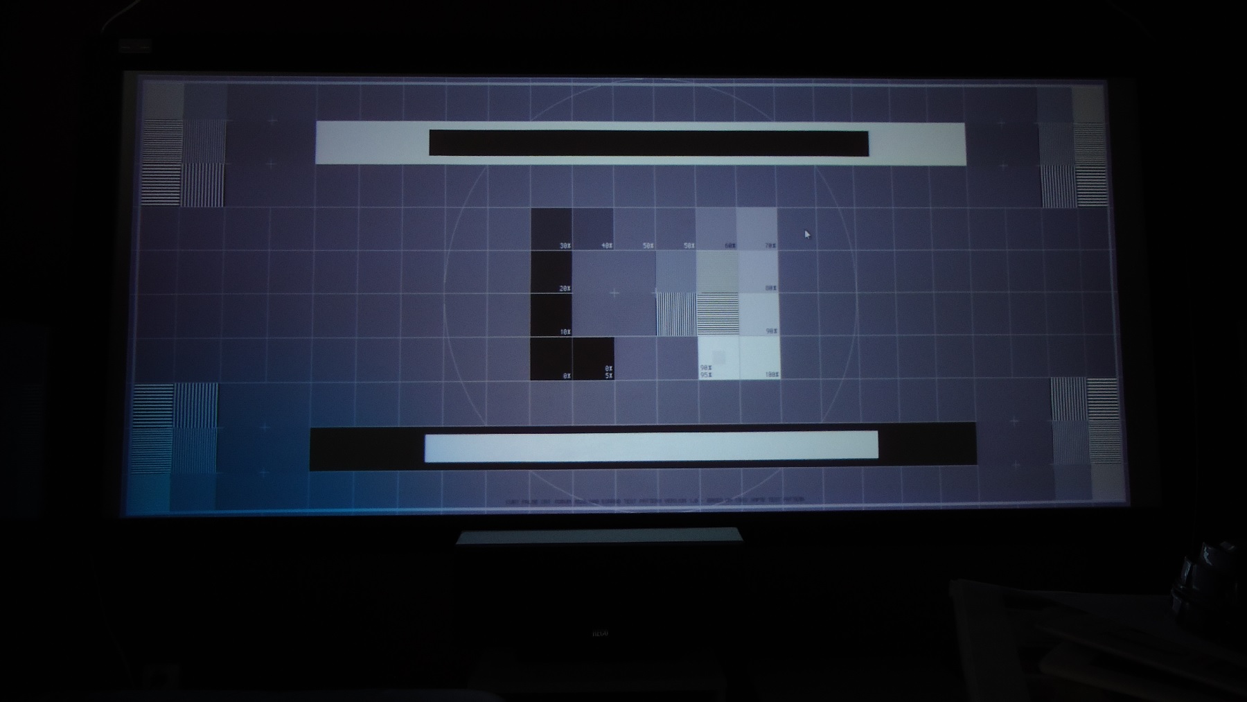

I have totally rebuilt my computer, and now run a fully modded projector! Finally it works.
With a new motherboard, a beefy cpu cooler, an ssd hard drive, a GTX960 graphics card and new moome v3, I got it to work. The later really made a huge difference in how blacks are shown, with small letters being really black now and not discoloured without that awful dual color that was shown before with the moome v1.
The new graphics card might have something to do with it too, but haven't made any a/b comparisons because it was a bitch to install next to the cpu cooler and all the wires.
The 1:1 looks a lot better and more uniformly grey now. But that's all I know about it.
Thank you Mike!

Posted: Sun Jun 07, 2015 10:02 am    Post subject:
Thank you Mike!
That's good to hear..Very Happy I'm glad you got that two color problem solved.
That Smpte is well matched (neck boards matching), but it's showing roll-off. That is most likely in your source, something that may be HTPC related. But we'll get to the bottom of it. It's just that I'll not be able to help with the HTPC tuning.
Looking good otherwise. The text is clear clean and sharp. That's a really good sign..
