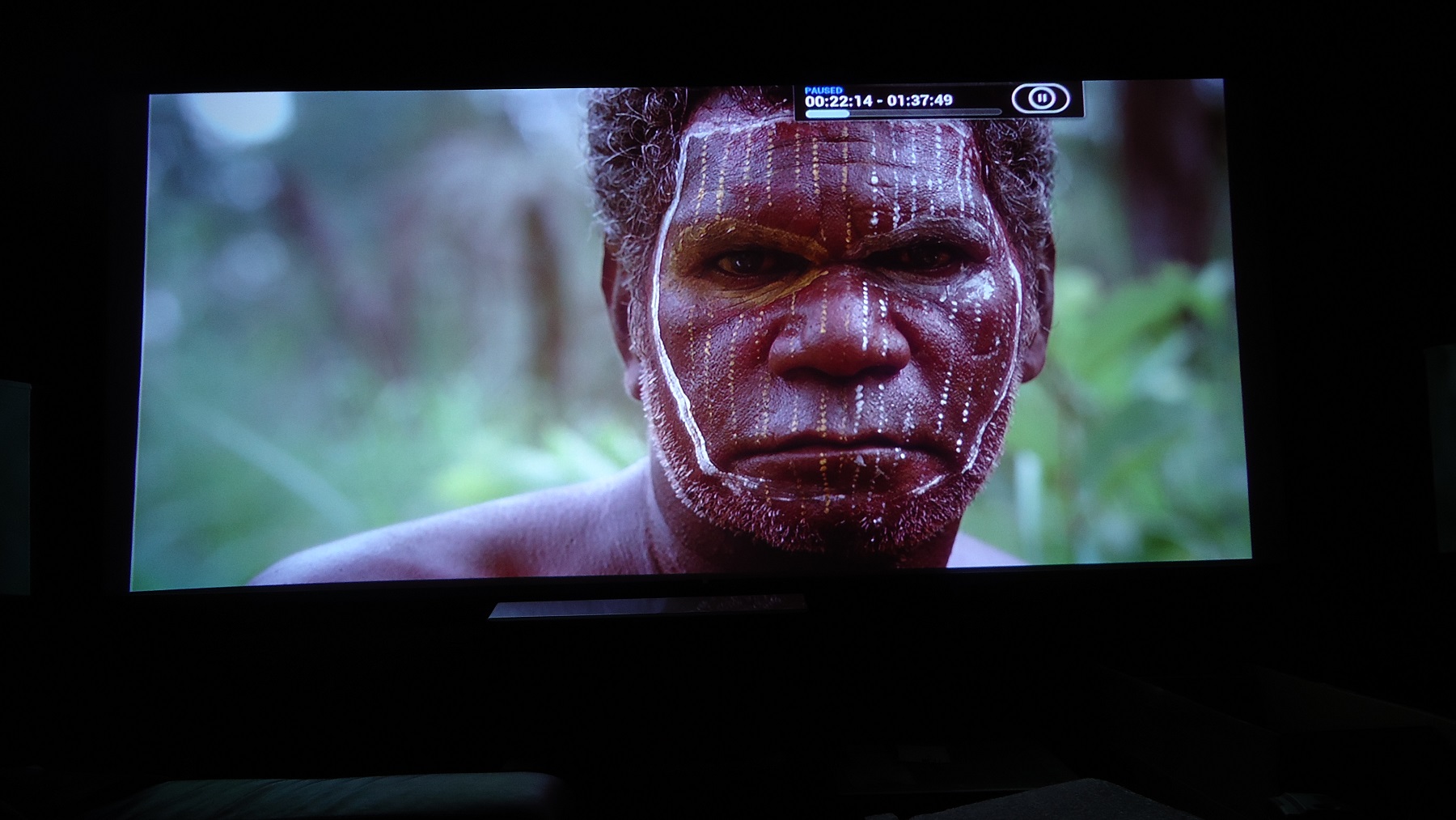

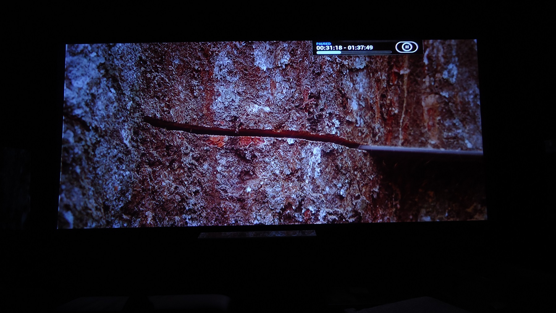

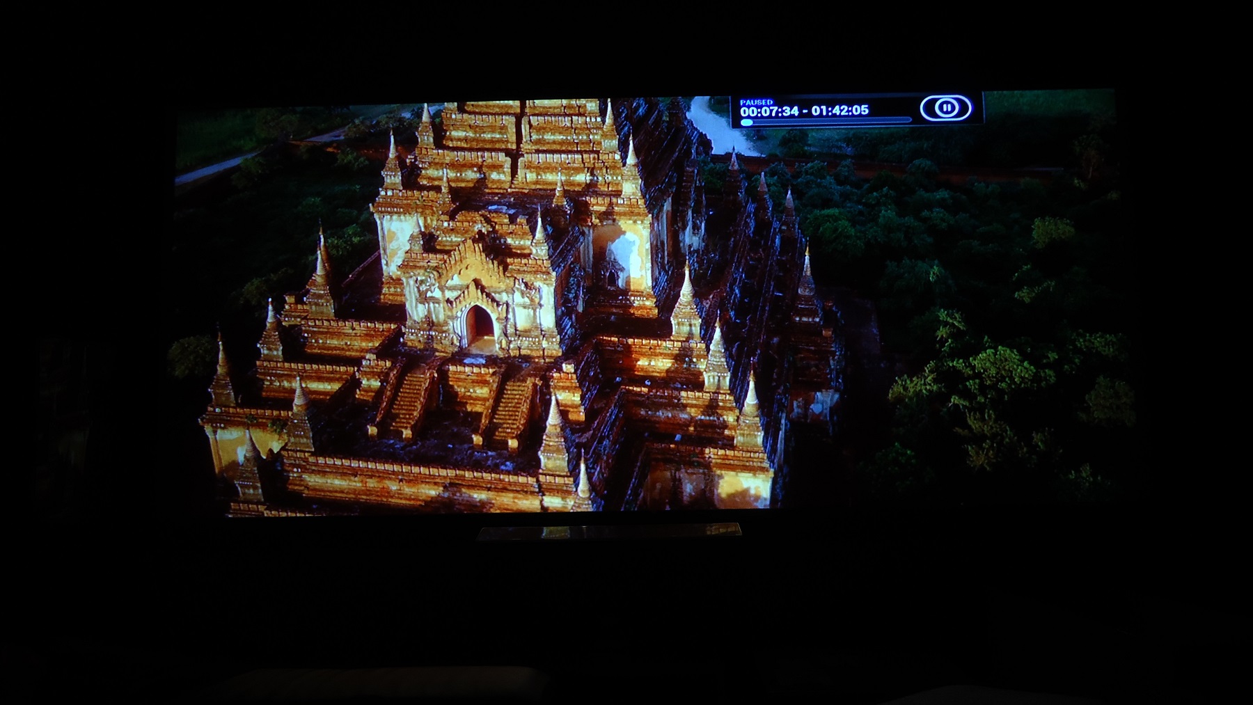

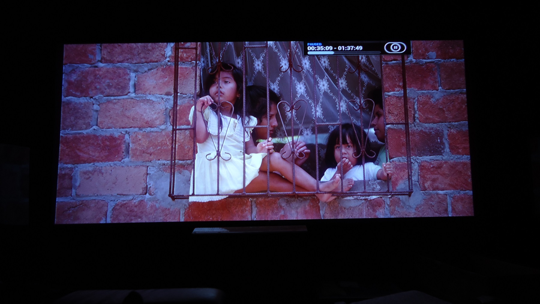

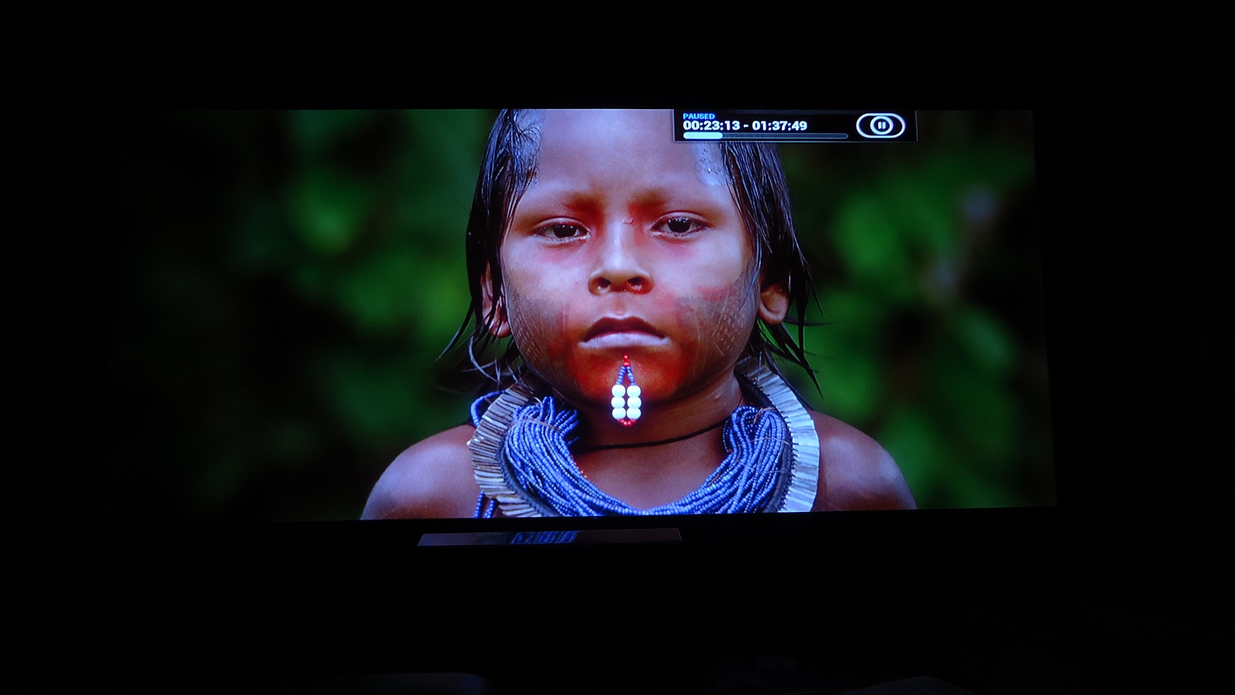

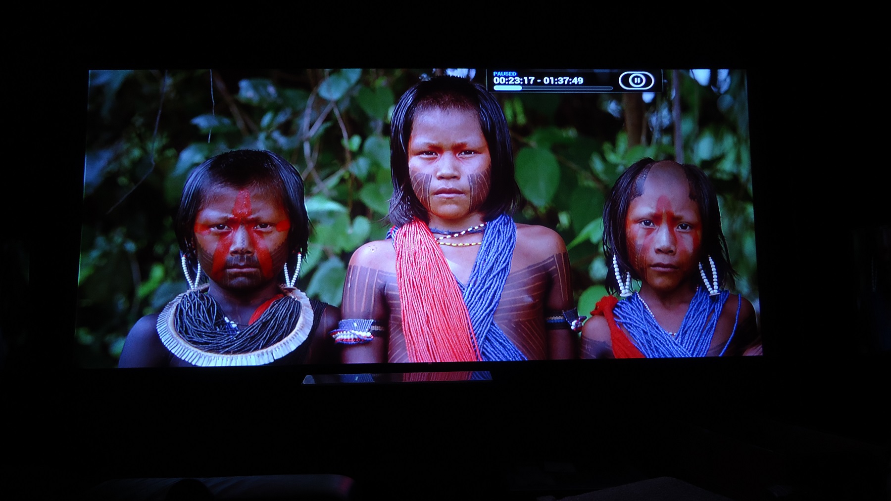

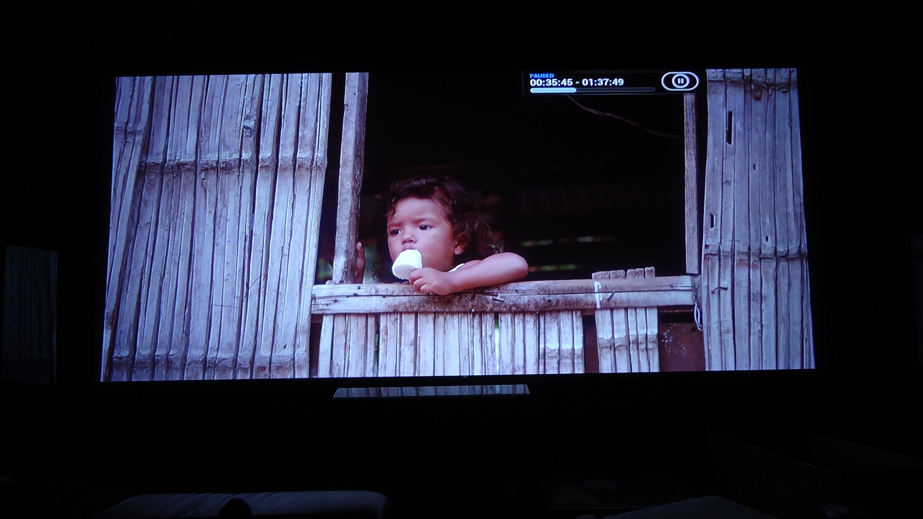

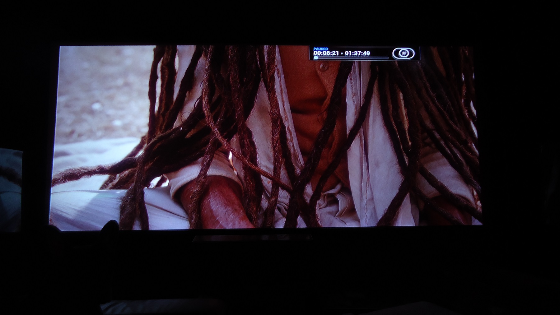

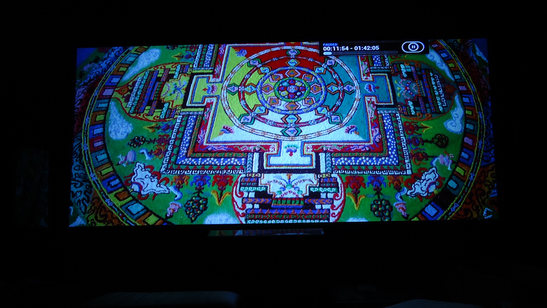

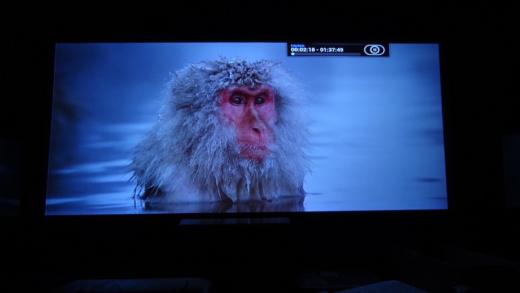

I installed the modded parts today, and all I can say is - wow! Talk about 3D! I almost feel dizzy looking at it. This is with very bad magnet set up I might ad.. but it doesn't matter because it looks fantastic anyway.
I can't wait to get this baby all dialed in. Very Happy
