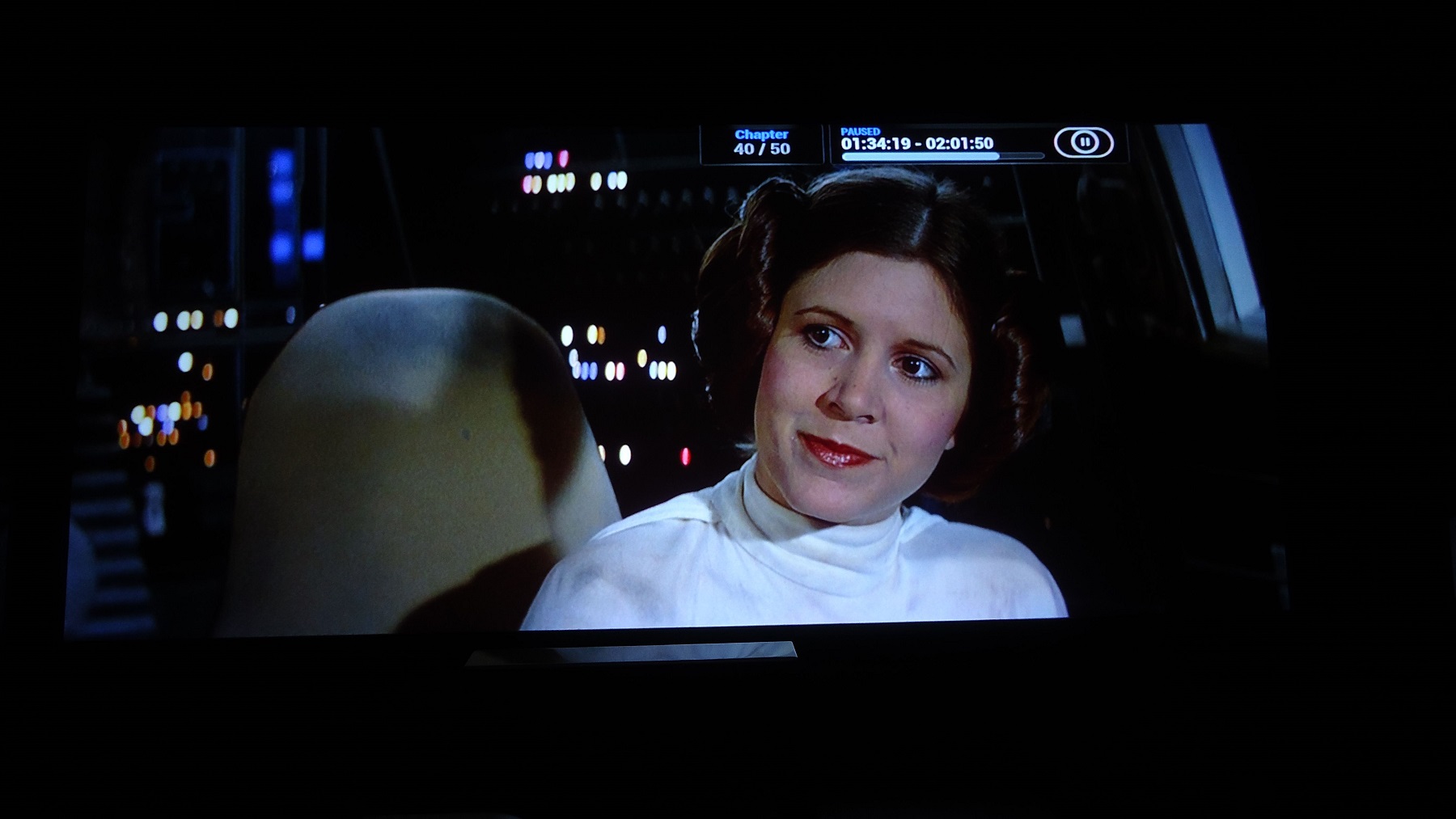

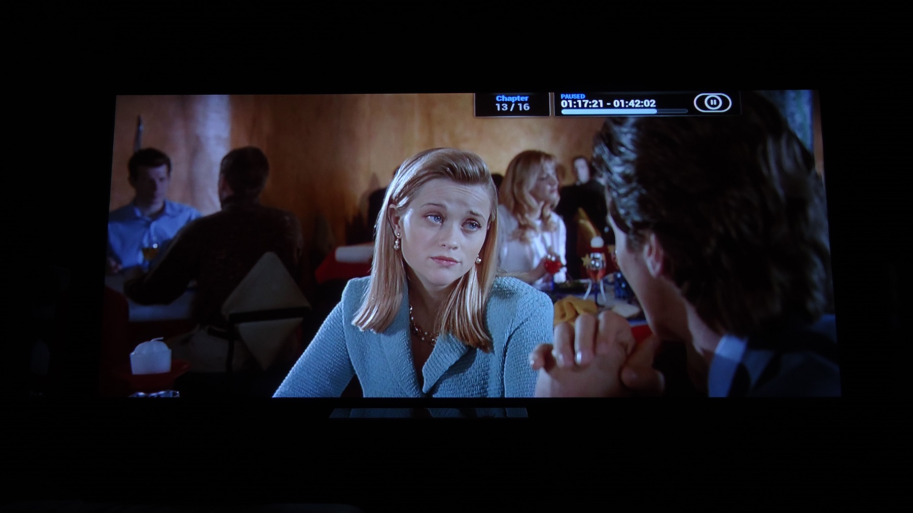

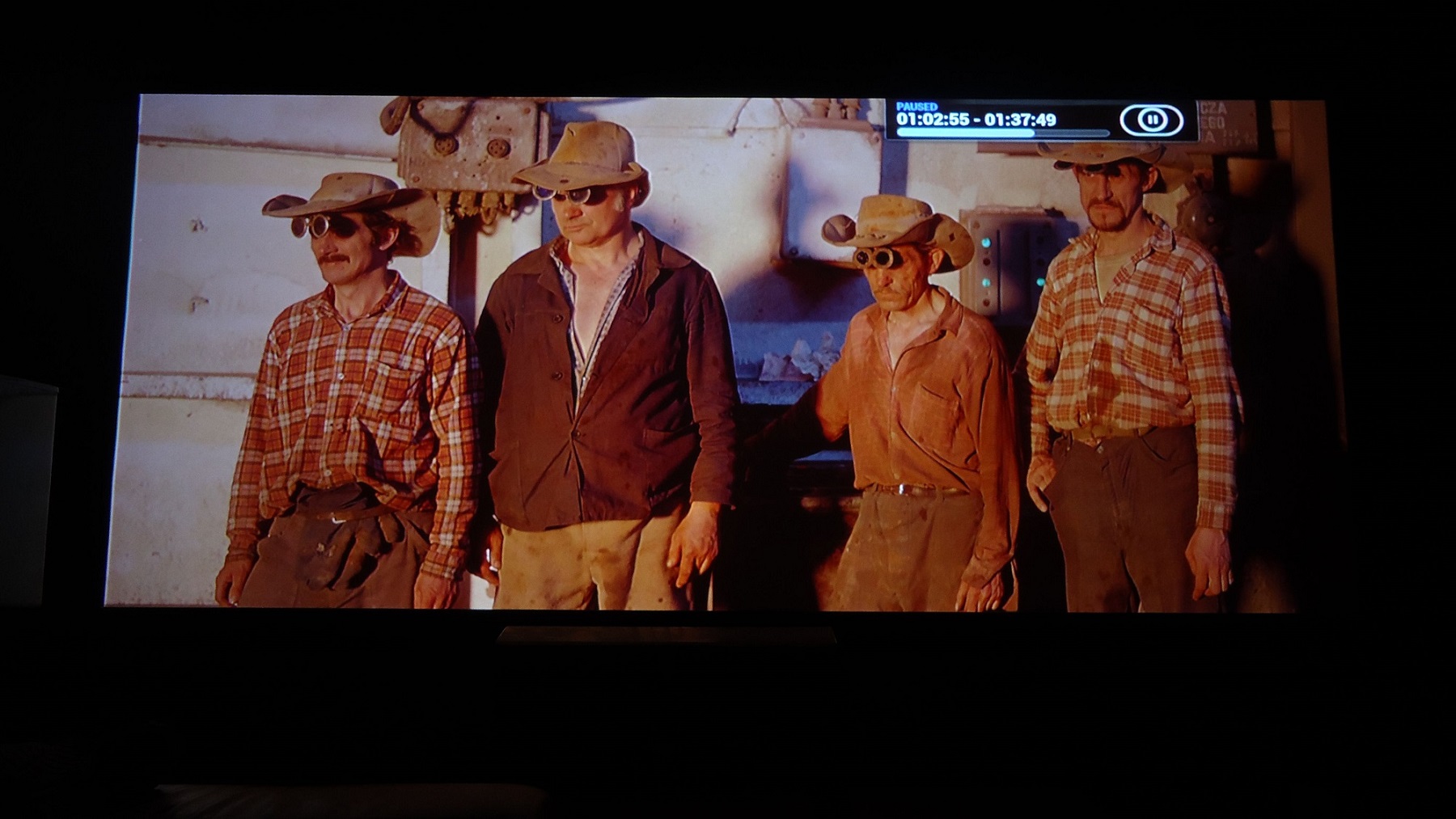

Posted: Thu Feb 05, 2015 6:07 pm    Post subject:
redfox001 wrote:
@Thewolfman. I keep thinking that skin is to blue. Did you try to calibrate?
I have used blue sub bright excessively, yes, and way more than red sub bright. I go back and forth between the two in effort to make hue as human like as I can. Other than that I use Etech for set up with colors.
From one day to another, my view on my images changes, some days I think it looks good and the next day it suddenly looks off. Though, nothing says it doesn't become even more off with continuing tweaking the colors.
I don't know how to calibrate, but will reduce the blue sub bright and try again.
With the Leia photo; it looks like she's been roughed up by Harrison a little bit before take off. She's a bit purple on the chin and between the eyes. And where she's suppose to be cheeky rosy she's also a little purple there to. It could be the camera doing this and will look more carefully tonight and see. I didn't see the purple at first and only noticed it after posting them.
I don't want to buy a VP, but wonder if a light meter could help balancing the colors along with the brightness and contrast as bonus. I already have ChromaPure installed and just need a meter if so. I have been eye-baling the X-Rite i1 Display for this.

Posted: Thu Feb 05, 2015 6:34 pm    Post subject:
Wolfie has nailed it boy's!!!!
very very nice!!!
Maybe a click or two down on your Brightness control to get deeper blacks, but otherwise I like it!

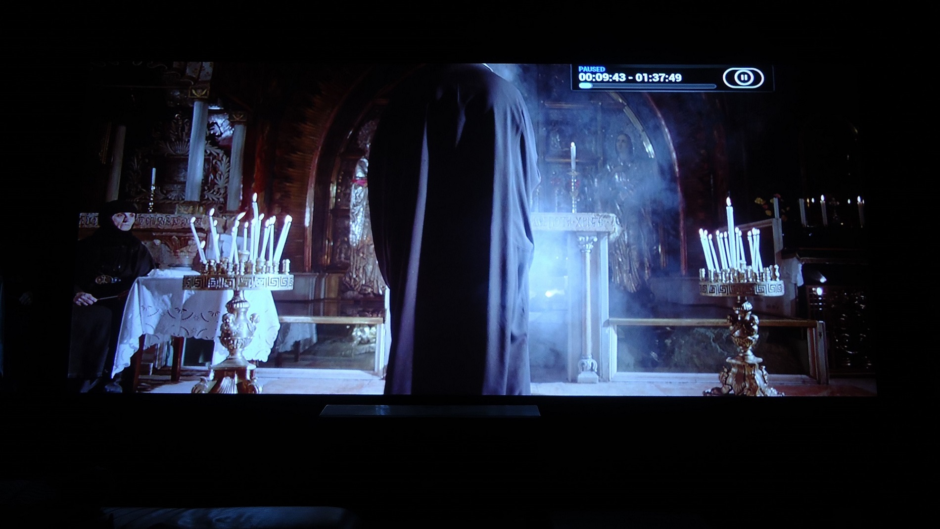

Posted: Thu Feb 05, 2015 8:31 pm    Post subject:
Here's a few more I did last night. They can only be appreciated when you're in a dark room or environment

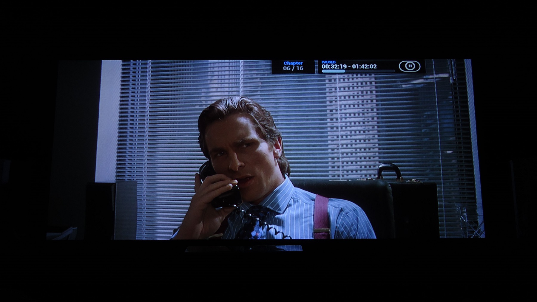

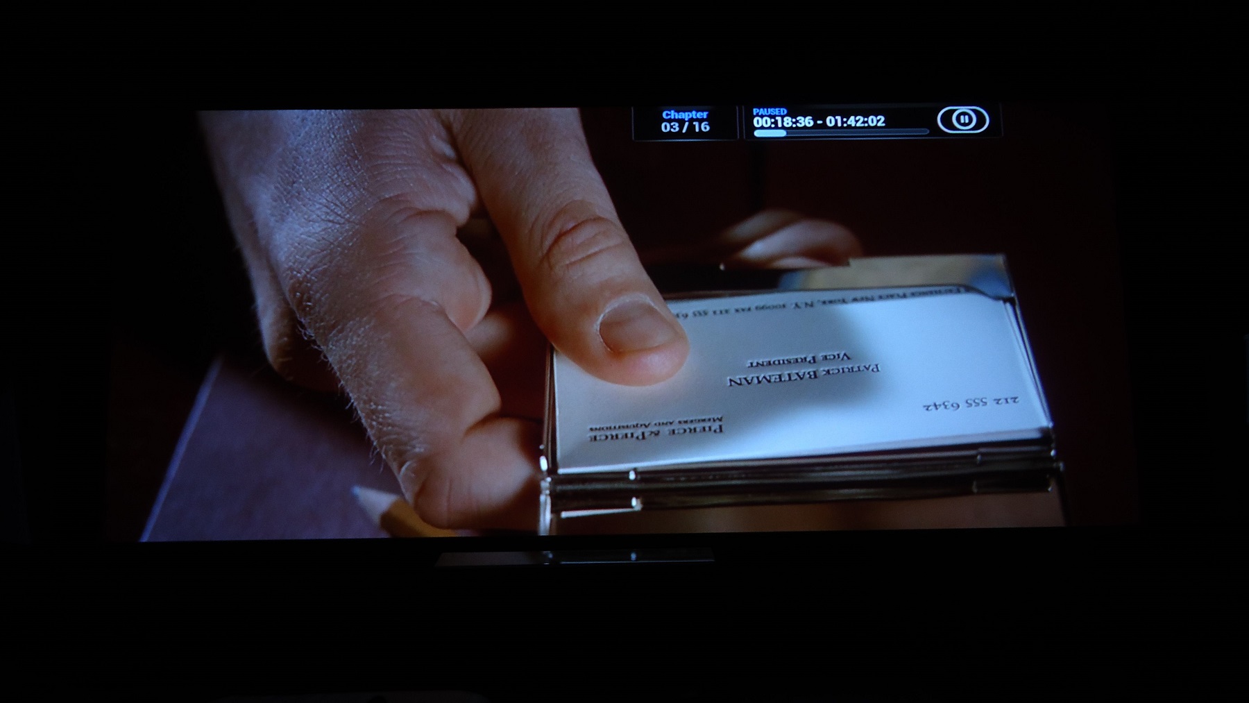

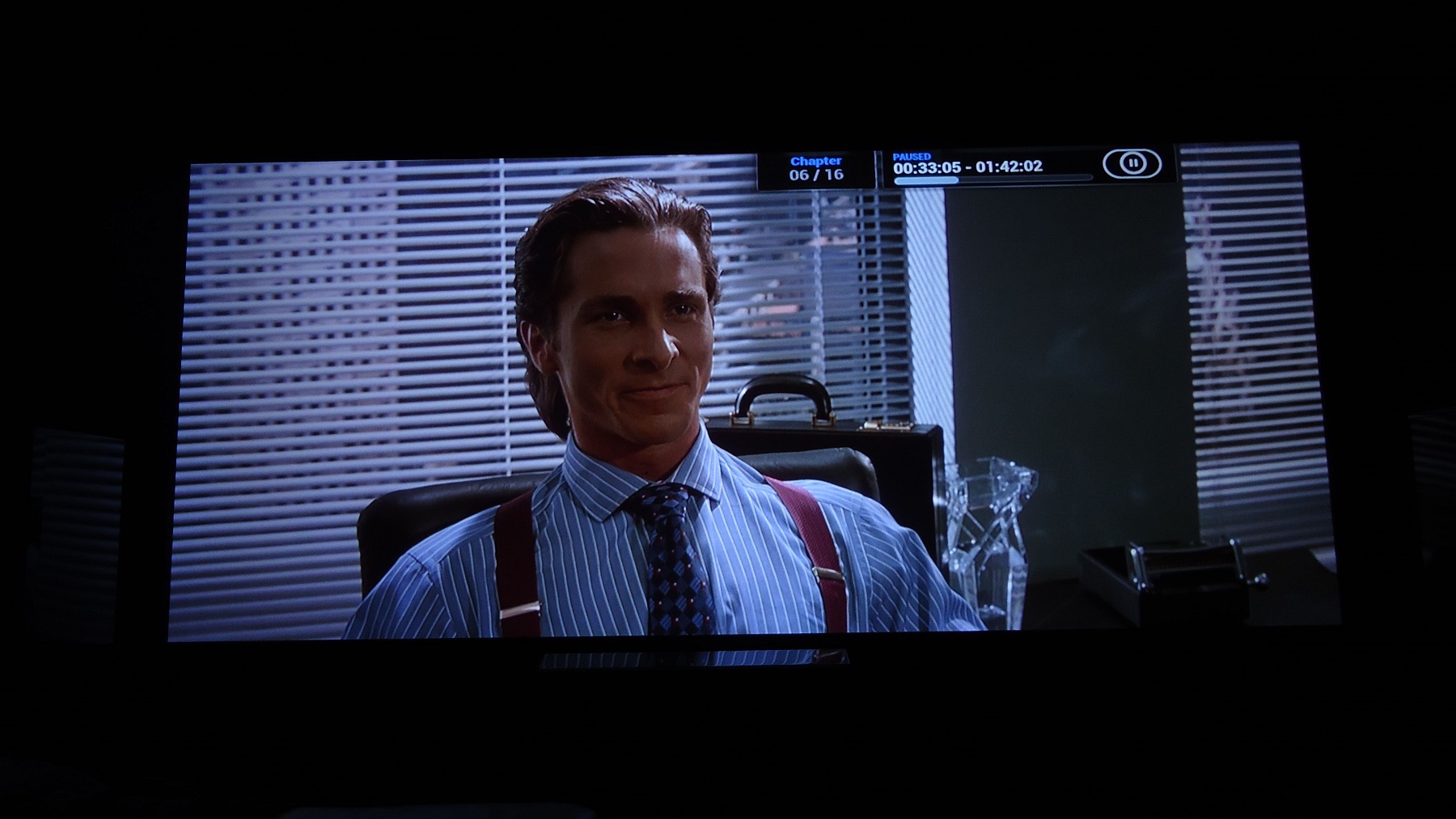

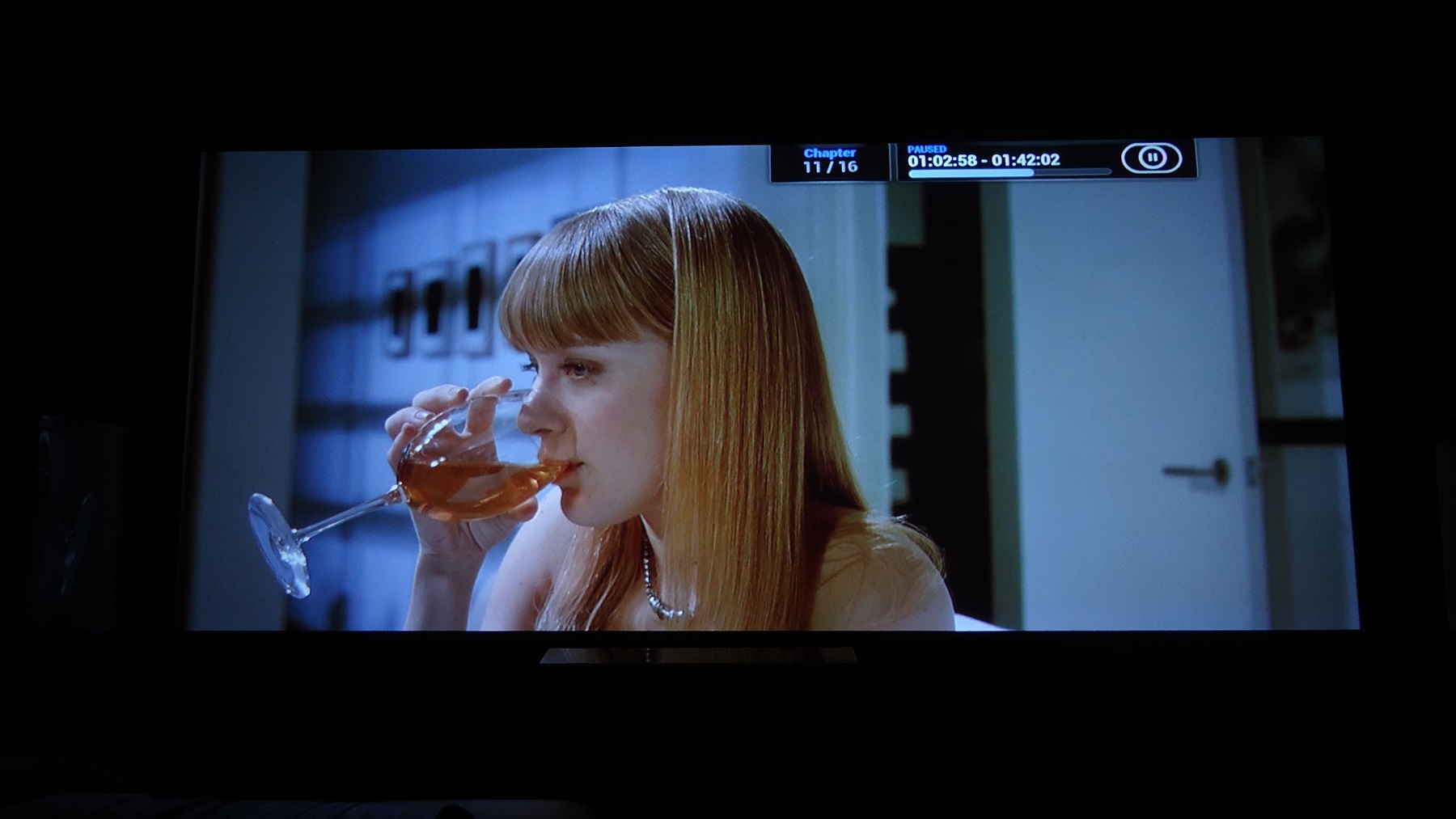

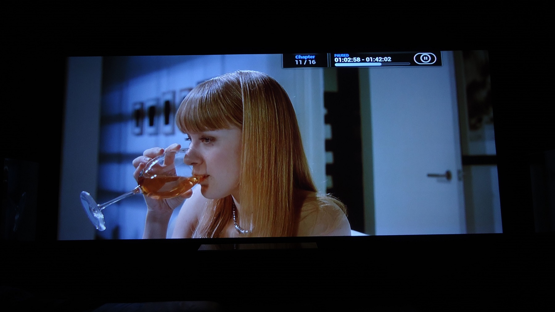

Posted: Fri Feb 06, 2015 7:22 am    Post subject:
Red Drive 37 - before 35
Red Sub Brite 56 - before 60
Blue Drive 59 - before 55
Blue Sub Brite 80 - Still 80
Contrast still at 60 but Brightness down from 14 to 12 + a little fiddling with G2 levels. All in all a tad more red and a better image, imo. Thanks for your input! Smile
As for the Leia photo, she is slightly purple in the movie also so nothing wrong with the camera.

Posted: Sat Feb 07, 2015 1:17 am    Post subject:
I'll try more later when the new moome card gets here, Kurt.
But for now I took the easy way out and just gave them some color.
A little less stiff looking and getting more and more life like with each step. It isn't until I see them side by side on a photo that I notice how pale they were before.
New settings
Red Drive 40 - Red Sub Brite 56
Blue Drive 57 - Blue Sub Brite 75
Old settings
