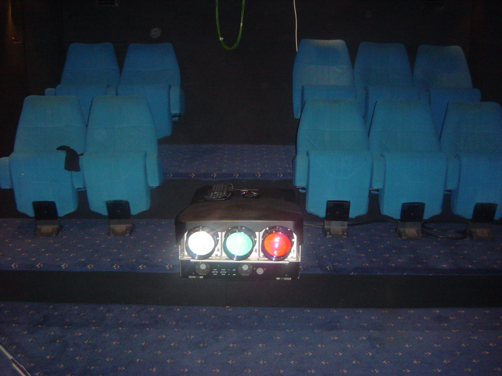

The 909 temporary setup in my theatre.

Yes it's naked.

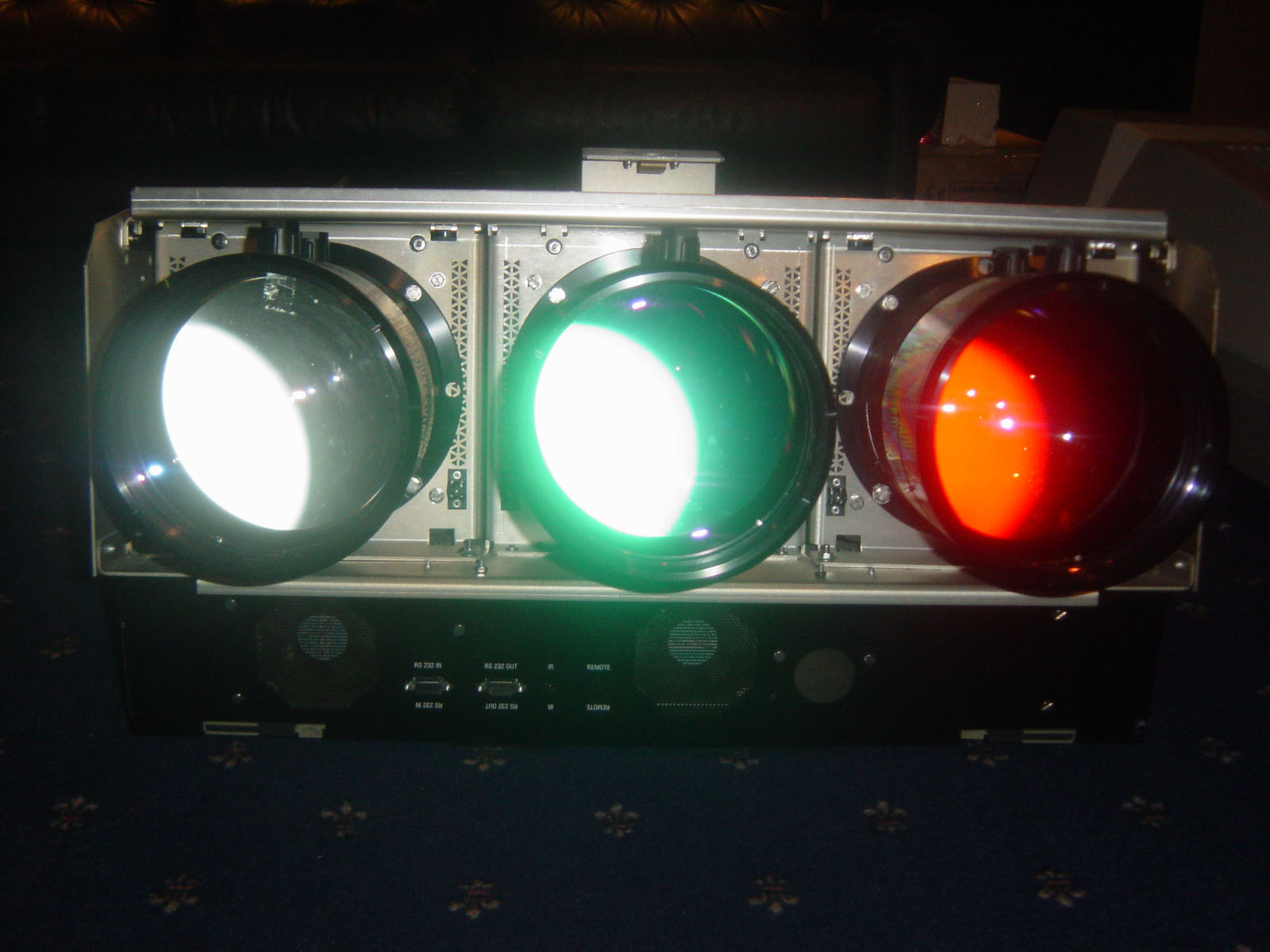

909 up close and personal.

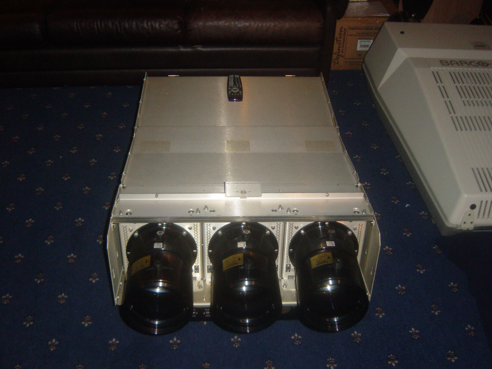

There is the 909!
