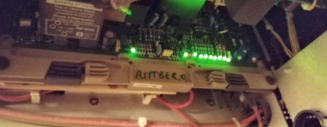

Attached pictures from the Barco:
 Filesize:  497.54 KB
 Viewed:  1327 Time(s)

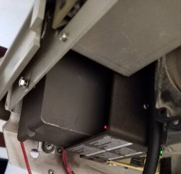

Posted: Wed Jun 26, 2024 7:50 am    Post subject: Additional picture
Additional picture
 Filesize:  368.21 KB
 Viewed:  1317 Time(s)

Posted: Wed Jun 26, 2024 9:42 am    Post subject:
Check first if the red led on the EHT board is lit. If yes, the quad, splitter, EHT could be defect, or you have a shorted tube.
Aso, be aware that not each combination of mainboard/quad/EHT will work.

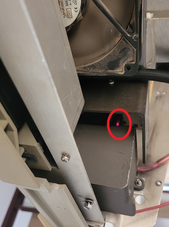

I checked the EHT and one red led (in the attached picture) is on, do you mean this one ?.
I diconected the 3 cabels from the splitter and the Red led keep to be on .
Is there any other way to check if there is a shorted tube ?
 Filesize:  227.7 KB
 Viewed:  1306 Time(s)

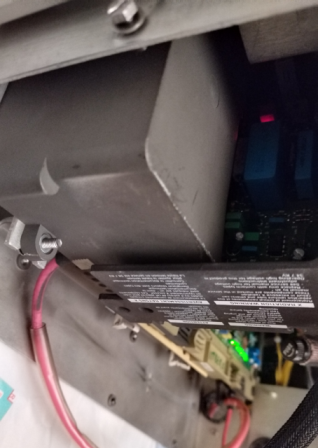

After replacing to another EHT , now the red led is in another place . is it normal ?
still no picture .
 Filesize:  266.7 KB
 Viewed:  1299 Time(s)

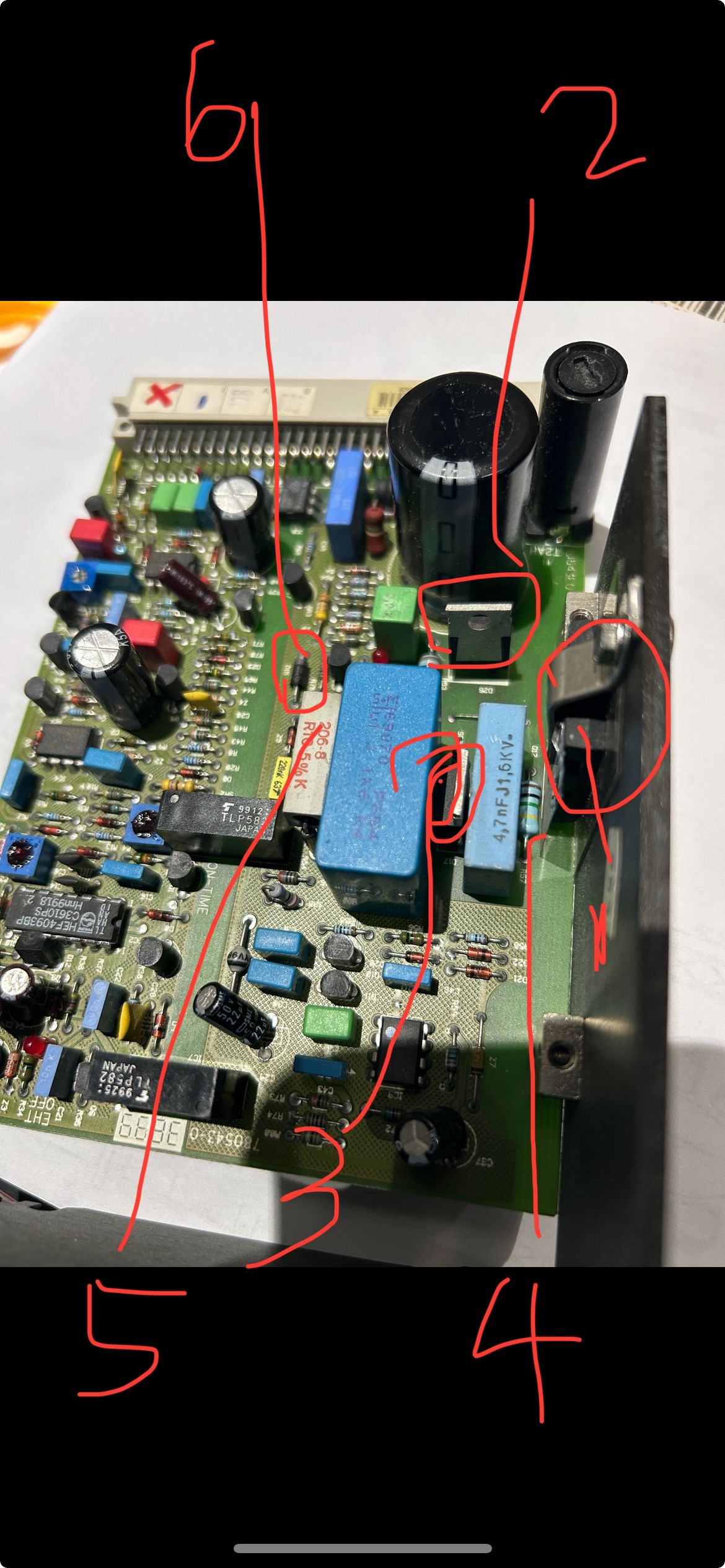

Posted: Wed Jun 26, 2024 2:02 pm    Post subject:
Please carefully check the EHT board. The resistance and triode.

Posted: Wed Jun 26, 2024 2:26 pm    Post subject:
Please use the multimeter to check, the fault is easy to find

Posted: Wed Jun 26, 2024 2:59 pm    Post subject:
Where in The EHT should Check ?

Posted: Thu Jun 27, 2024 1:39 pm    Post subject:

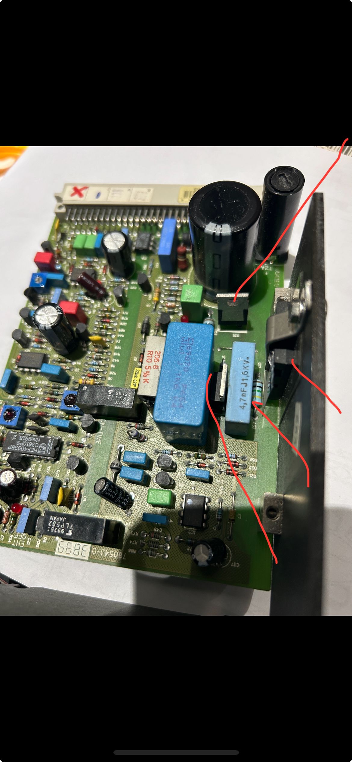

Posted: Thu Jun 27, 2024 1:40 pm    Post subject:

Posted: Thu Jun 27, 2024 2:21 pm    Post subject:
Thanks,
In order to check and to reach the points you have mentioned , I should remove the Quad,
I understand that to check the points you indicate I should power on the Barco ?
Thanks.
bluemoonhu
Joined: 16 Feb 2021
Posts: 259
Posted: Thu Jun 27, 2024 2:40 pm    Post subject:
Remove the EHT board from the machine and measure them with the multimeter

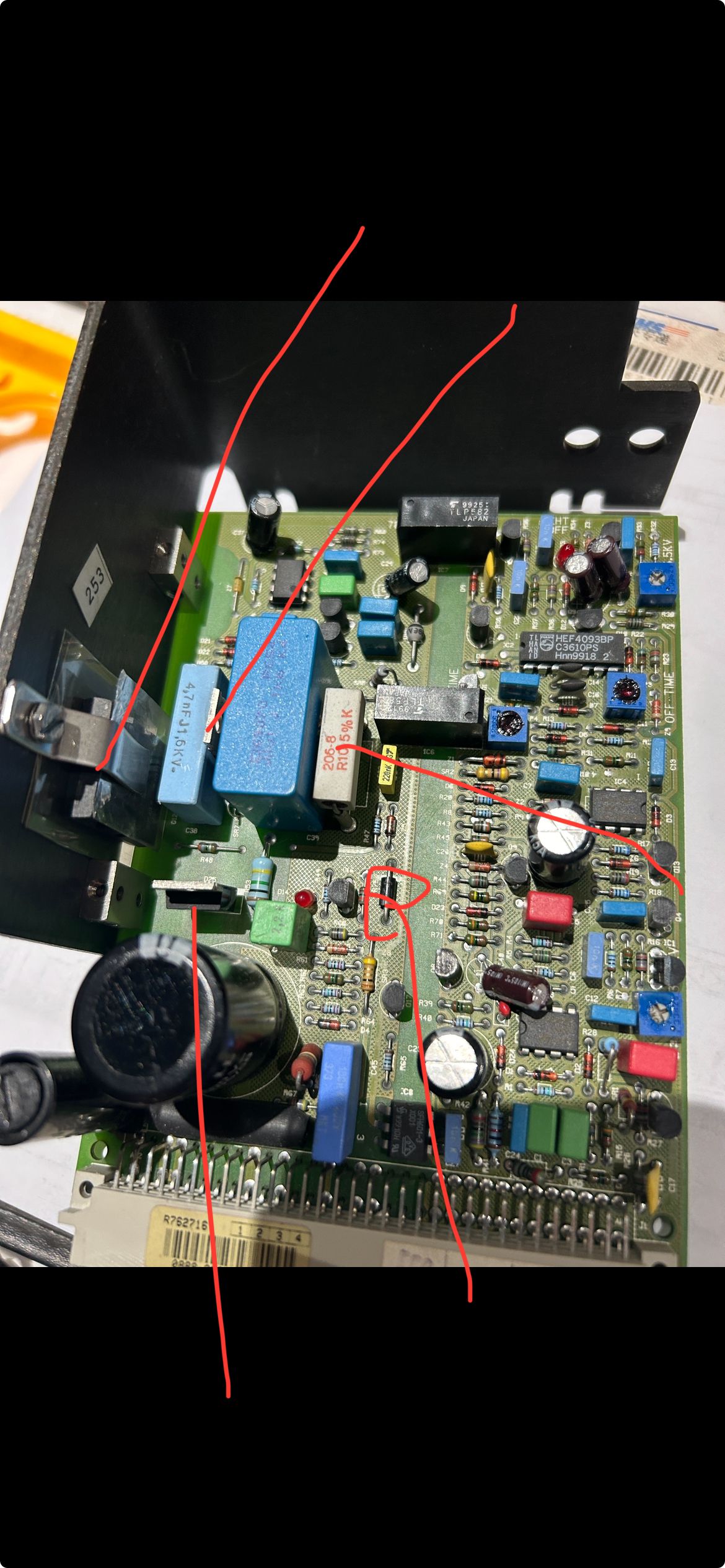

Posted: Fri Jun 28, 2024 12:10 am    Post subject:
Rittberg wrote:
So what I can check with the EHT removed is only the resistance ?

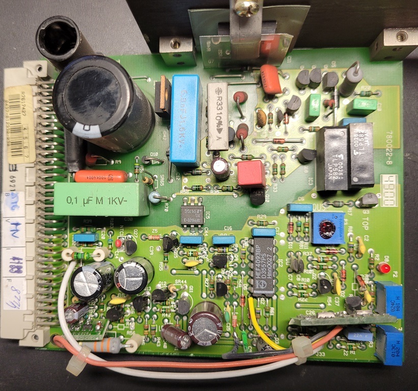

Posted: Fri Jun 28, 2024 3:12 am    Post subject:
Hello,
Thanks for advices,
my original mounted EHT that keept blowing the 2A fuse looks different from the one in your pictures.
The EHT original pictureת is attached.
I have 4 spare EHT , one that looks indentical to the original and another 3 that looks identical as in your picture .
I installed and checked all my 4 spare but no picture, but I can see the a red led is on (in different place) depended in EHT one that is instaled .
Thanks for your support.
 Filesize:  294.41 KB
 Viewed:  1202 Time(s)

Posted: Fri Jun 28, 2024 3:27 am    Post subject:
My EHT board is used for Barco CINE9, you need to test similar components
