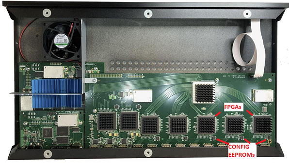

FPGA is an acronym for Field Programmable Gate Array. I believe most all of the video processing that the Lumagen does is done by FPGAs. Typically of that era, the FPGAs get programmed on each power up by a EEPROM on the FPGA JTAG bus. Near as I can guess, you are successful in downloading new firmware to the MPU/EEPROMs, but not all of the FPGAs are happy when they try to suck their config bits from the EEPROMs.
If you haven't done so already, I'd echo the multiple suggestions of trying a new power supply. Perhaps the old one is noisy or droopy and it's well enough to get some activity, but not well enough to service the brief inrush surge on power on config.
If you've already tried a different PS and observed the same symptoms, you may be running out of DIY troubleshooting options.
