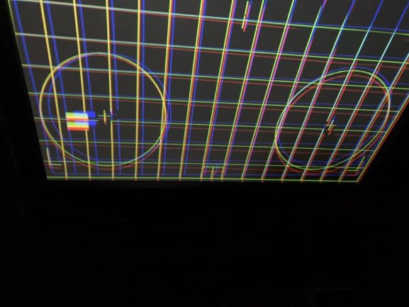

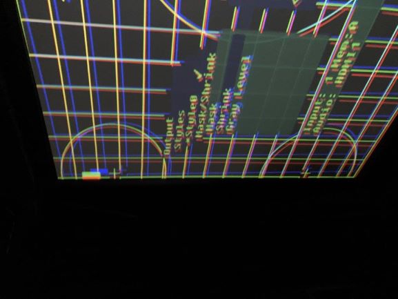

Posted: Fri Jan 15, 2021 2:53 pm    Post subject: .
before setting shrink function in the lumagen the circle isn't complete.
also masking is set to 0.
sorry about convergence didn't set yet....

Posted: Fri Jan 15, 2021 3:26 pm    Post subject:
So the projected image is off the screen. You can adjust raster size on the projector, the image size within the raster on the projector, or do this within the lumagen. Normally you'll want to maximize phosphor usage on the projector. This comes down to proper CRT projector setup for maximum tube life. See: http://www.curtpalme.com/TubeRasterSetup.shtm
If you need to change porch settings that can done in the Lumagen.

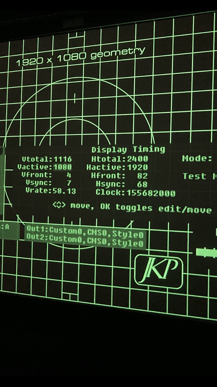

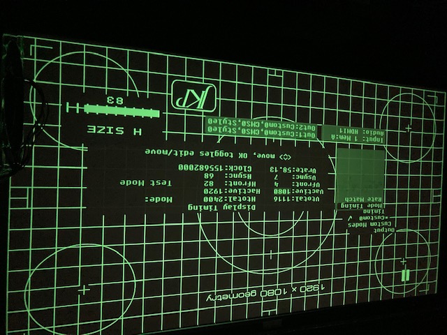

Posted: Sat Jan 16, 2021 2:50 pm    Post subject: .
I succeed to get all picture on the screen.
I did that be increasing the Htotal and together with Hfront.
but now i have Vrate at 58.18. trying to fix it with clock and doesn't work.
is it ok to be at 58.18 or needs more tweaking?

Posted: Sat Jan 16, 2021 3:45 pm    Post subject:
Alright, it's looking beter. The V rate automatically changed to accommodate the altered porch timings you just did. Don't worry too much about that.
However, you should touch the horizontal linearity on your Barco. The pattern squares must have the same width all over the screen, and the circles on the right-side should be round too.
