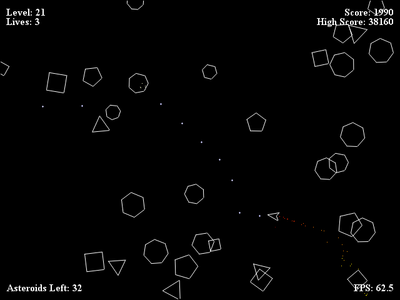

Simple.. no scanning lines. Back in the 80s there was a video game where your plane shot at shooting stars. It was done via a vector display, and at the time it was the sharpest looking image out there. BAck then I had no idea why until I got into the CRT thing, and someone explained it to me.
There was a company also manufacturing a vector planetarium display that I saw about 15 years ago. Same thing, no scanning lines, no raster, and CRT tubes that were absolutely stupidly expensive.

| Curt Palme wrote: | | Simple.. no scanning lines. Back in the 80s there was a video game where your plane shot at shooting stars. It was done via a vector display, and at the time it was the sharpest looking image out there. |
Are you thinking of Asteroids? https://www.youtube.com/watch?v=_TKiRvGfw3Q
It was a vector display. You can see bright spots anywhere two lines intersect, because the phosphor got drawn on twice.
There was also Battlezone, a two-player 3-D tank-battle game. https://www.youtube.com/watch?v=Ctr54kopo8I.
Those games came out in Nov 1979 and Nov 1980. Gaming has advanced a bit since then...

Yes, Asteroids. Couldn't think of it earlier. They made a small tabletop version for $99, I almost bought it just to tear it apart.. but didn't.
