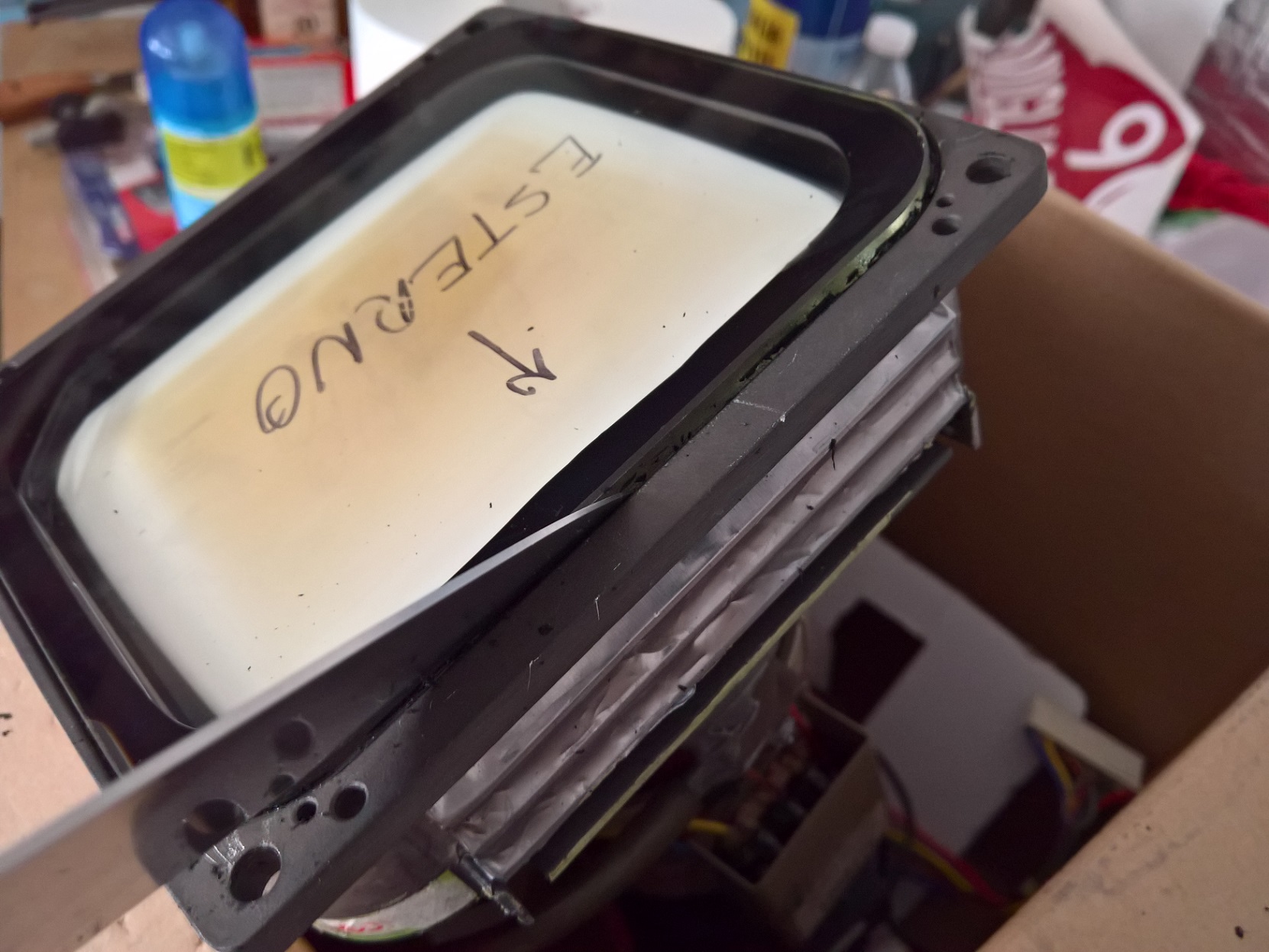

I reopen this old topic because I'm in the same situation.
I've bought a new refreshed VDC 180DVB22 for GB808.
It was cheap because the front glass broken during the transport. The glycol is still inside.
I thouht to change the glass using one of another one almost dead tube.
But I cannot take out the glass.
I removed the glycol and cut all the black silicone around but is still very strong to remove.
Do you have to heat up something ?
Thanks,
Alberto

Posted: Sun Feb 18, 2024 11:01 am    Post subject:
Anyway not an easy task with a 180DVB22.
The glass is not flush with the frame.

Posted: Mon Feb 19, 2024 4:42 pm    Post subject:
Not designed for easy service. You may try soaking the silicone in vinegar, That may soften it as well.
