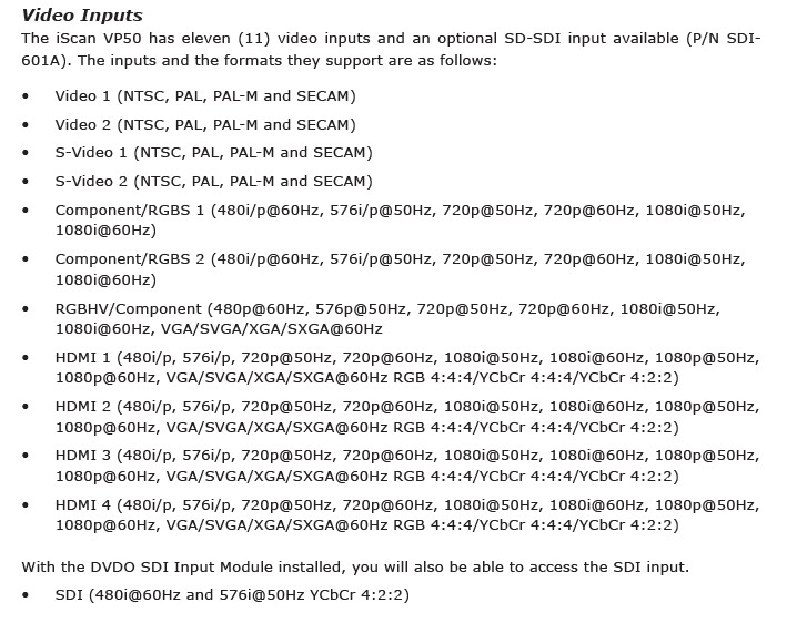

According to the manual: http://static.highspeedbackbone.net/pdf/DVDOiScanVP30Manual.pdf (link says vp30 but document is vp50...) section 5 table 2, there is a mention of passthrough, but i can't find that option anywhere in the menu tree...
The vp50 does support 1280x960 as output.
I was just looking at the resolution table on page 8 of the manual. It says SXGA but only at 60Hz which does you no good.
I can't find the pass-through settings either.
I also had a look at the Atlona we use to use to convert 50hz to 60Hz AT-HD560 but it doesn't list 1280x960
Neither does the Atlona DVI550 nor the HD550. Guess there's no way the creator of the Atari DVI board could add 60Hz output? That would be way more compatible with everything.
