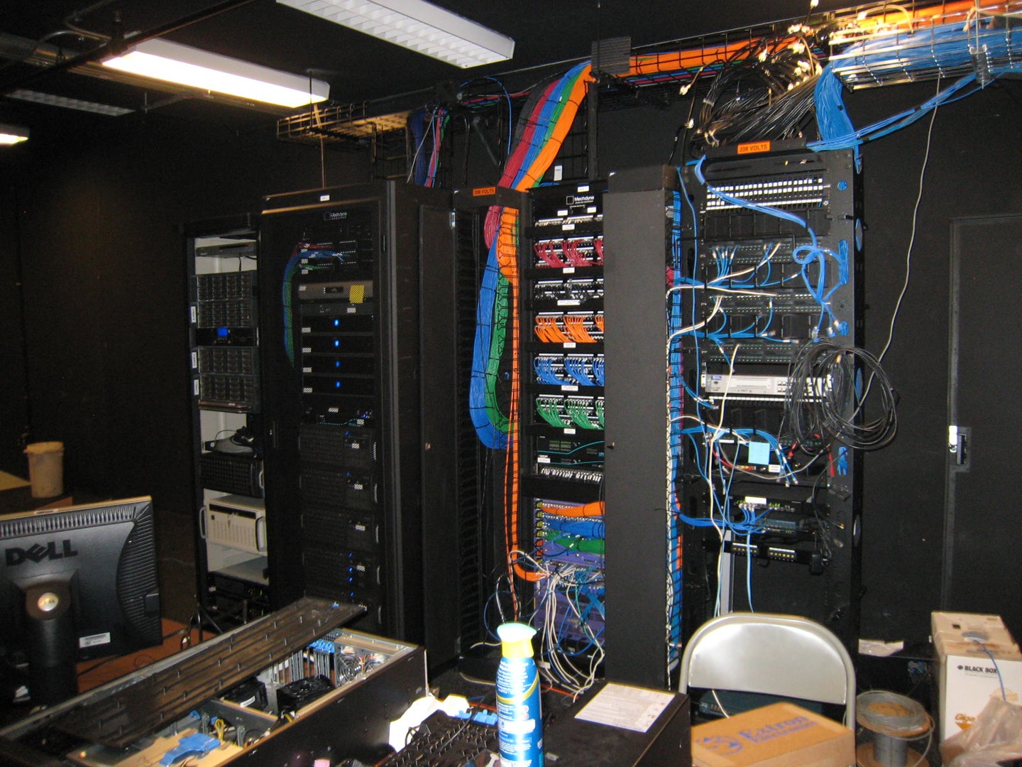

It's way more complicated than that. And why the use of cat5 or Cat6 (shielded) is now being used for high resolution video transfer (room to room,etc).
Fiber optics as simple as it seems is very finicky in actual operation. The cable part of things is fine, but the receiver and transmitter is where the problems really come in.
There was a time when fiber was being used both in network racks and for A/V. Now it seems like most of the really higher end system are using Cat6 Shielded for everything.
The Rack in the picture handles both data and video for a massive medical immersive (3D) system that has maybe 20 dual DPI HD 1080 projectors placed behind a 10 tall rap-around screen. Everything video is definitely Cat6 shielded, and I I'm sure that was the case with control signals. This system had maybe 100 computer Nodes (High speed mini super computers( - there are six in the rack left of where the multi-color wires are going. Everything to and from the Nodes is Cat6 shielded, both control and video. I'm really not sure if all the cabling in those racks are Cat6 shielded, but do know for sure that everything video and video system control was cat6 shielded. No fiber in that system, or any of the other ones I dealt with.
Fiber when used with video was a pain in the azz..

Thanks for illustrating my point, Mike!
All that well-managed cat 6 cable ends up being a bundle of cables as thick as a fat man's thigh.
All that data can be carried over a single fiber and a system can be built to drop the signals to the projectors
where needed. Right now that would be more expensive but it would also be more efficient and reduce maintenance
costs. Quick, there's a fault in one of the cables in the blue bundle. Go find it!
If you're using the internet, or placing a phone call, the data is going over fiber at least for the long hauls.
Of course the transceivers have to be well engineered. But once you have good fiber transceivers, you've now beat all the
many problems associated with metal cables. Limited bandwidth, limited range, greater susceptibility to environmental damage.
Optical data paths are the future. Right now the cost/benefit analysis favors copper for many applications but do you think the day won't come when that will change?
A lot of people, those living in newer housing developments, get all their data services via fiber already. FITL or FTC. (Fiber In the Loop or Fiber To Curb) When I stopped working for BellSouth back in 2001 we'd been deploying FTC systems in new neighborhoods as standard practice for a few years. The only drawback of it in that application is that if someone does cut a fiber cable, it's nowhere as easy to splice it as it is to splice a cut copper cable. But buried fiber cables are pretty well armored so such events were rare.
Fiber IS the future. I can't wait to get there. The only place I want to see copper cables in a system is the power cable and the speaker cables. I want every interconnect to be fiber, all the same, and kiss the "tweak audiophile snake oil high end cable market" scam goodbye permanently.
As someone who's been involved with multi-million dollar data centers and the SLAs that are the bread and butter as to how things are done, you're greatly oversimplifying and again just looking at theory and not cost, practicality, or even usability. For example, if that one fiber cable goes, you lose everything and you can't quickly swap out a replacement cable.
The 'thickness' of the cable at this point that you mention is not something we care about.
