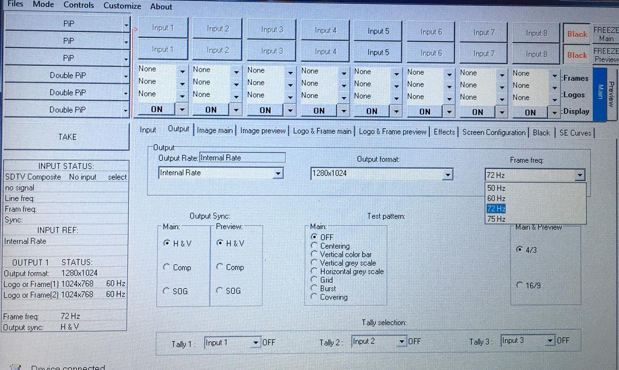

Hey,
my DVX8022 arrived. As you can see 72Hz would also be an option Mr. Green Thumbs Up

Posted: Thu Aug 23, 2018 3:02 pm    Post subject:
Well 1280 x 1024 is sharp as a digital.
Still testing....

Posted: Thu Aug 23, 2018 5:22 pm    Post subject:
Still testing....
How much of the phosphor do you use? If u can use most of the phosphor, this should be crazy good for a crt. If u use most of the phosphor u should approach 50% MTF.

Posted: Thu Aug 23, 2018 7:12 pm    Post subject:
With a 4:3 rez like 1280 x 1024 you use like 85-90%
